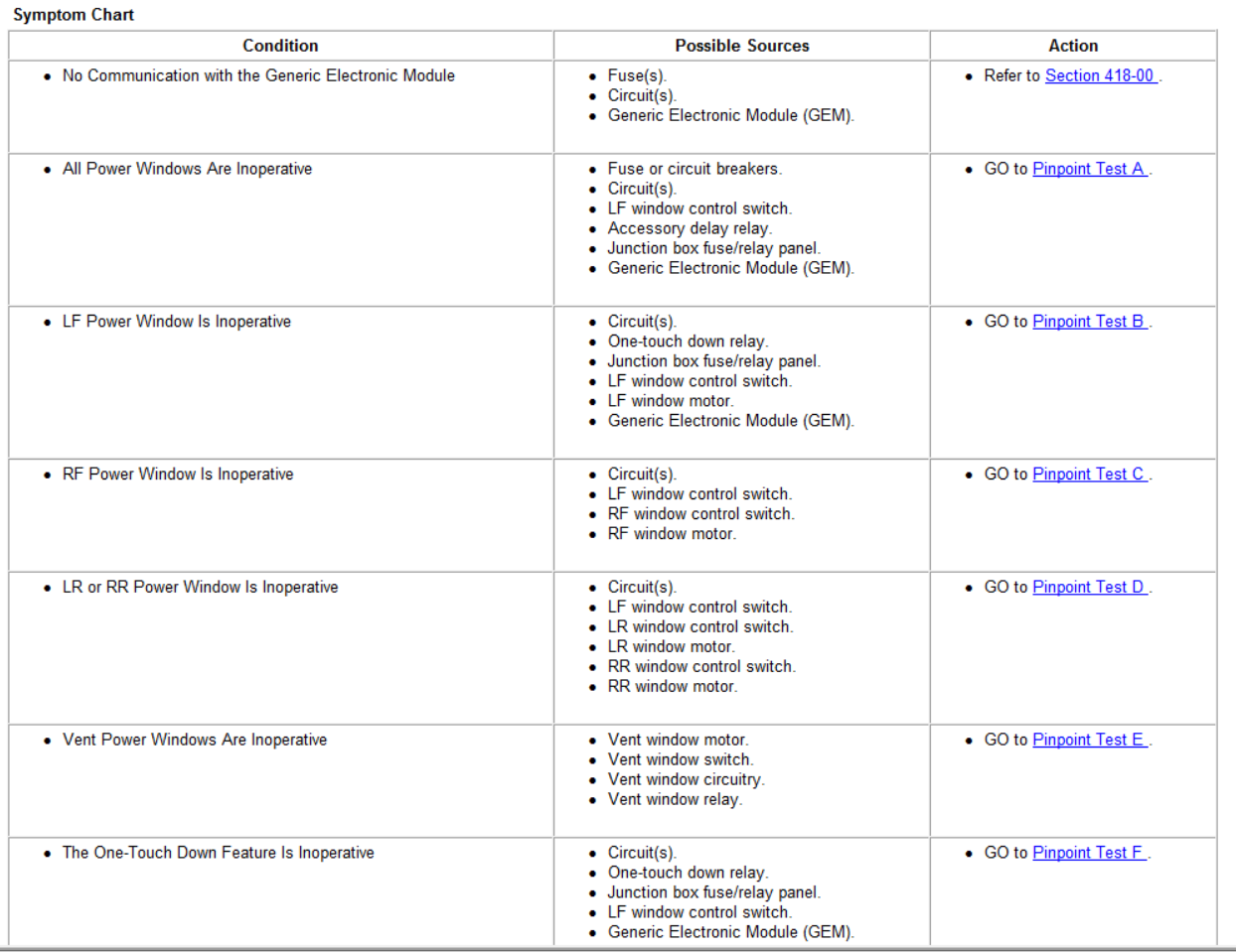

@kd5zll FYI... I have attached the pinpoint tests for your diagnosis and testing as well. Keep us updated.

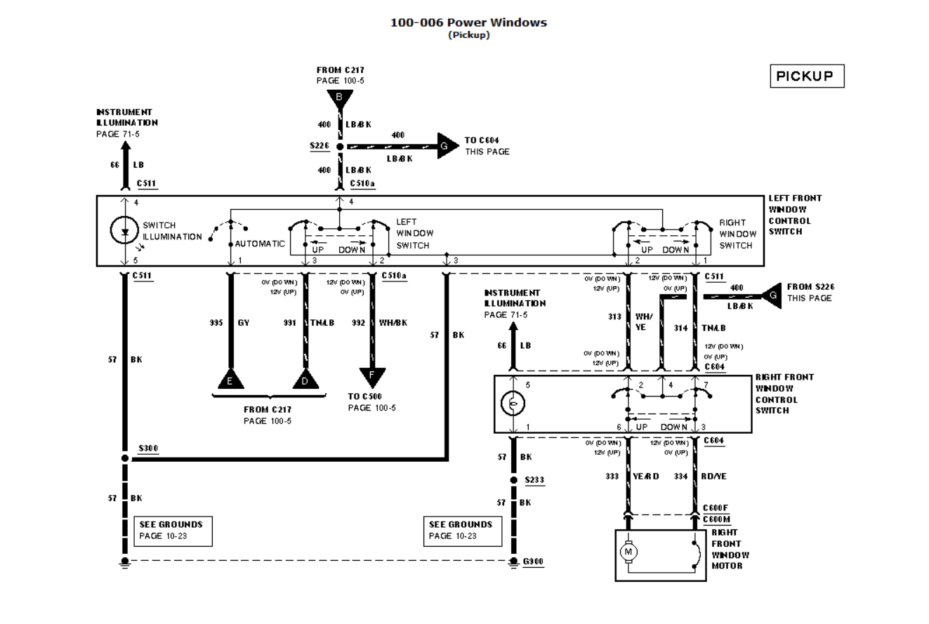

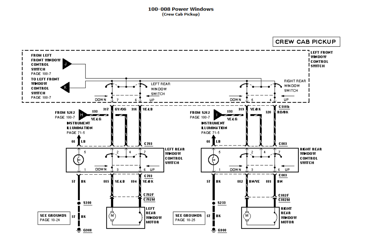

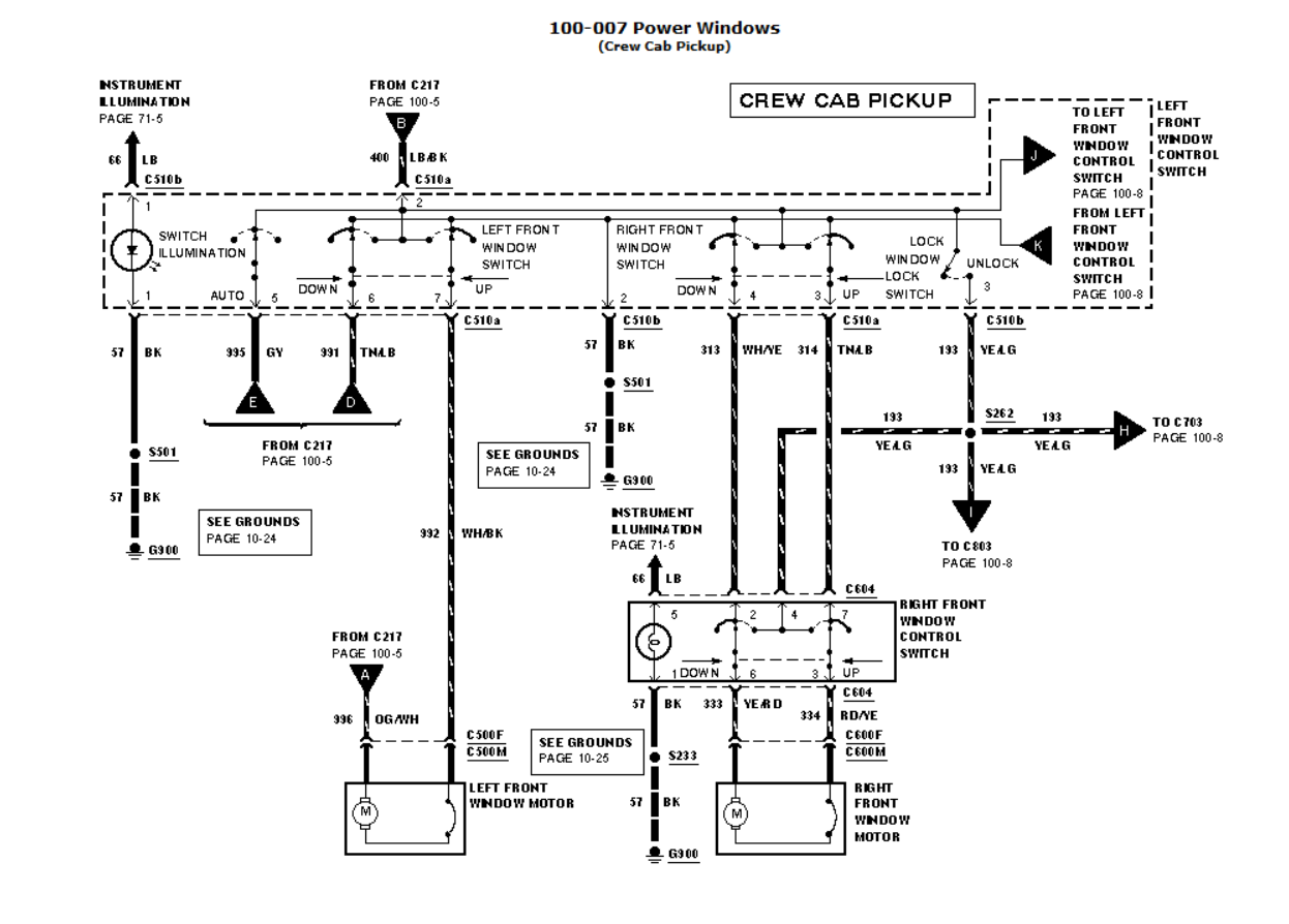

Looking at the wiring diagrams for a common failure point, I see the ground from the master switch sticks out to me as a possibility. Although, I did not look very close and see how the circuits are wired, just a quick glance.
I don't know what body style you have, so I will post the front doors and then the rear. I hope these help you out.

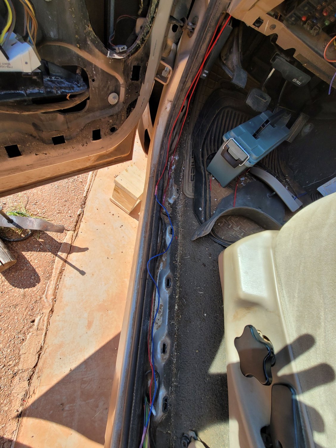

i realized that my dome lights wouldnot come on, a couple weeks ago, when i took a bull to the scale, after dark... i hadnt noticed before, because i put a cut off switch on those, and its usually off, and i dont need lights. That night i needed to see, and no worky....
fuse was blown.. replaced, instablown.... so, while ive been on this front end replacement
I pulled up the tread plate to see those wires in pieces.... fixed them, bought a new pack of fuses, since the last one got sacrificed in the discovery... yay, working dome lights... and then, because i had nothing to lose... i plugged the buttons back in to the windows, and... they now work.... frickin mice.... anyway, this problem, has been fixed.
Repaired switch wires, after i found them chewed in about 6 pieces
I was digging for the... presumed.... cut wire preventing my windows from working
