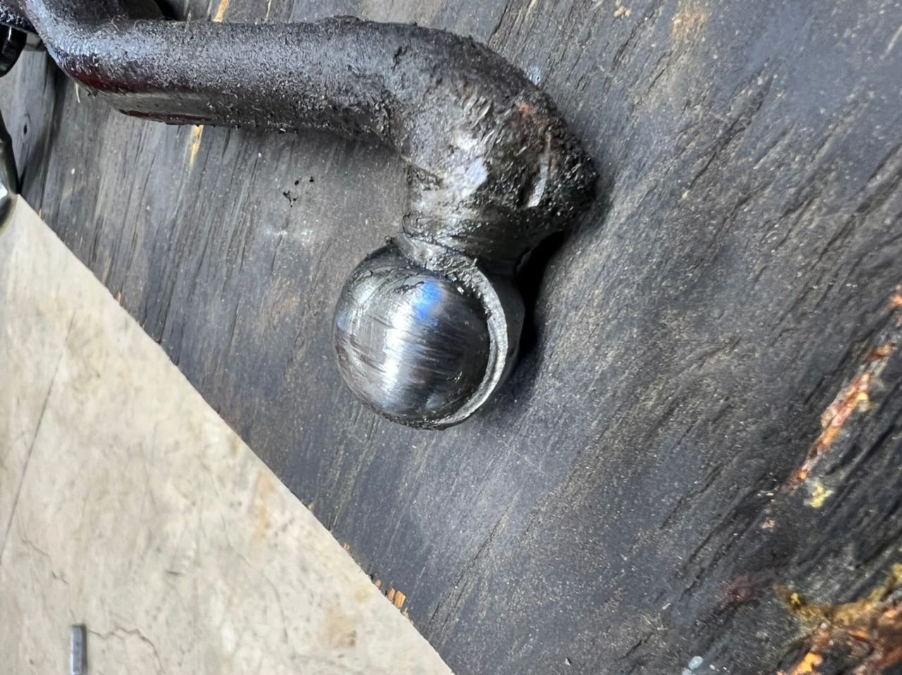

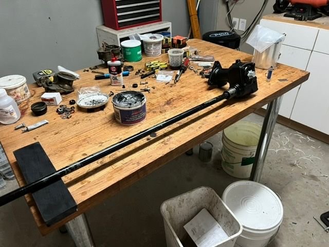

We received a pretty good snow today so I played outside most of the day.

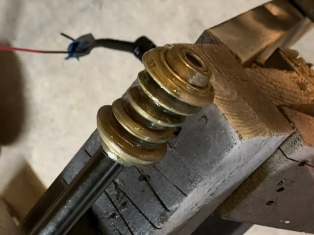

In between playtime I managed to knock out some restoration work. I am getting a rebuilt steering box ready to swap in while we have the engine out. I started setting it up today and noticed the housing shifting while I turned the shaft. I must have warped the shaft while installing the worm gear. We tried to use this box in our 52 build a while back, but it had tight spots so I went with a new shaft/worm there. That’s probably why it was tight. Anyway, I had a NOS shaft/worm that needed to be cleaned up. It’s just been sitting around so why not use it. I soaked it in evaporust using a pvc pipe and painted it. Should be ready to setup tomorrow.

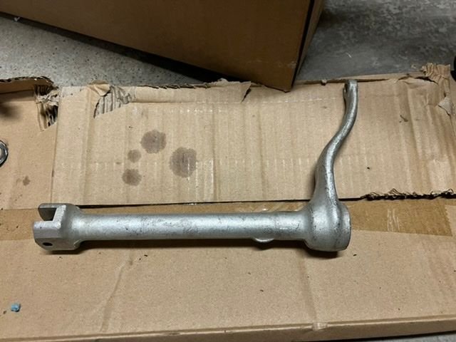

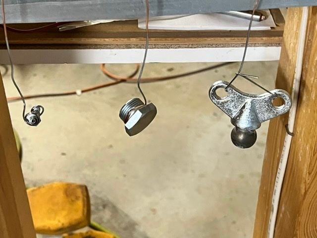

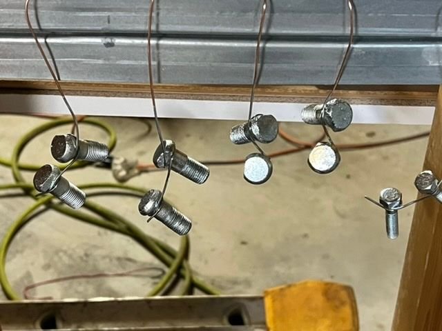

I also cleaned up the new clutch equalizer and plated a few parts: the equalizer bracket, oil plug, bolts for the shift bracket, grease fitting for the shift housing, and some backing plate bolts.

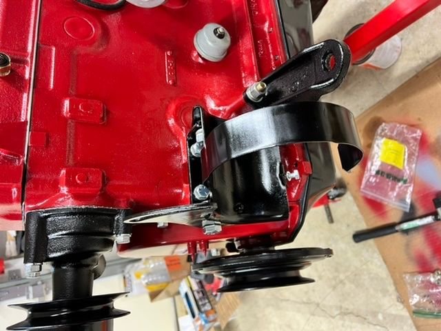

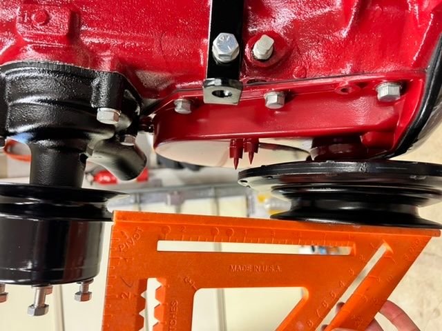

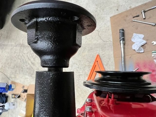

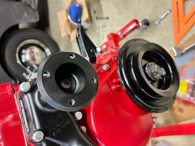

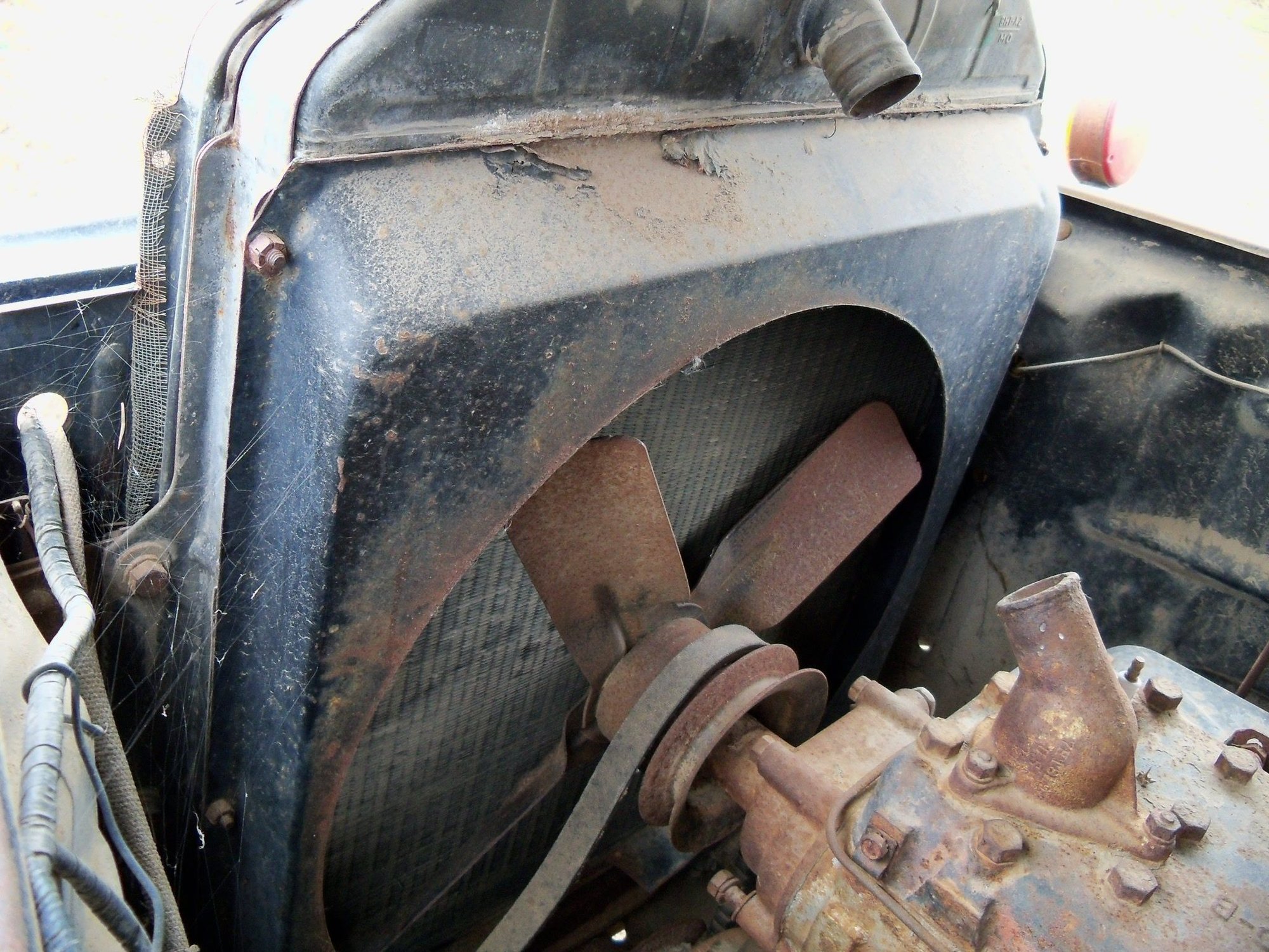

Ran into an issue on the engine today I think. I put the fan hub on the water pump snout and I have a misalignment issue to the crank pulley. I need to mount the generator to see if it’s the water pump pulley or if the crank pulley is set in too far. If it is the water pump, I will have to press the snout on further. Thoughts here?

Old Jan 17, 2022 | 01:50 PM
  #64
52 Merc's Avatar
52 Merc
Joined: Oct 2009
Posts: 16,135
Likes: 4,735
From: Burbank, WA
I think there's something amiss at the water pump. Here's some pics of how they're supposed to fit.
Old Jan 17, 2022 | 05:38 PM
  #65
3twinridges's Avatar
3twinridges
Joined: Nov 2014
Posts: 2,442
Likes: 256
We worked on it this evening and have it pretty close. Had to press the fan hub further down on the shaft, I think it’s pretty close to lining up exactly now. Glad we caught that now vs later.

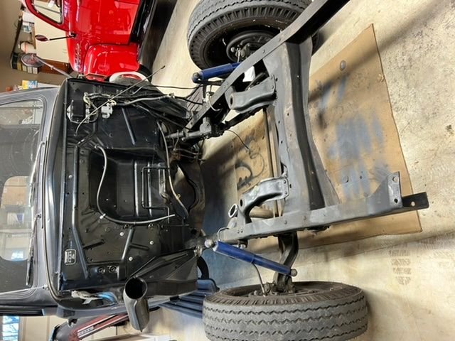

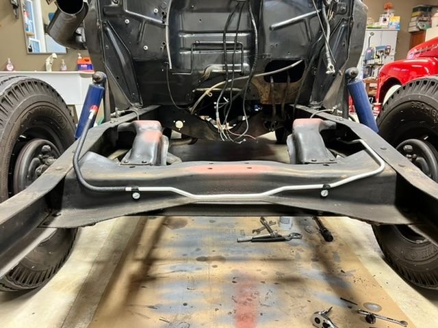

All day job but we were successful dissembling the front clip and removing the motor. Very fortunate in that we did not break anything and all the bolts came loose with the help of some penetrant. Addressing the steering box and pedal assembly is next while we can get to everything easily.

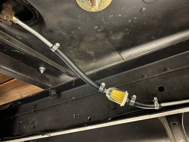

Had a little setback on our project. I was cutting a rubber flex line so I could add a filter between the tank and hard line, the razor blade slipped on the cut and I sliced open my leg. Had to get sewn up yesterday and take it easy.
Back at it this evening though. The hard line is in and added a filter at the tank. Shift linkage repair grommets should be here tomorrow so I can finish the column and install the steering box.
