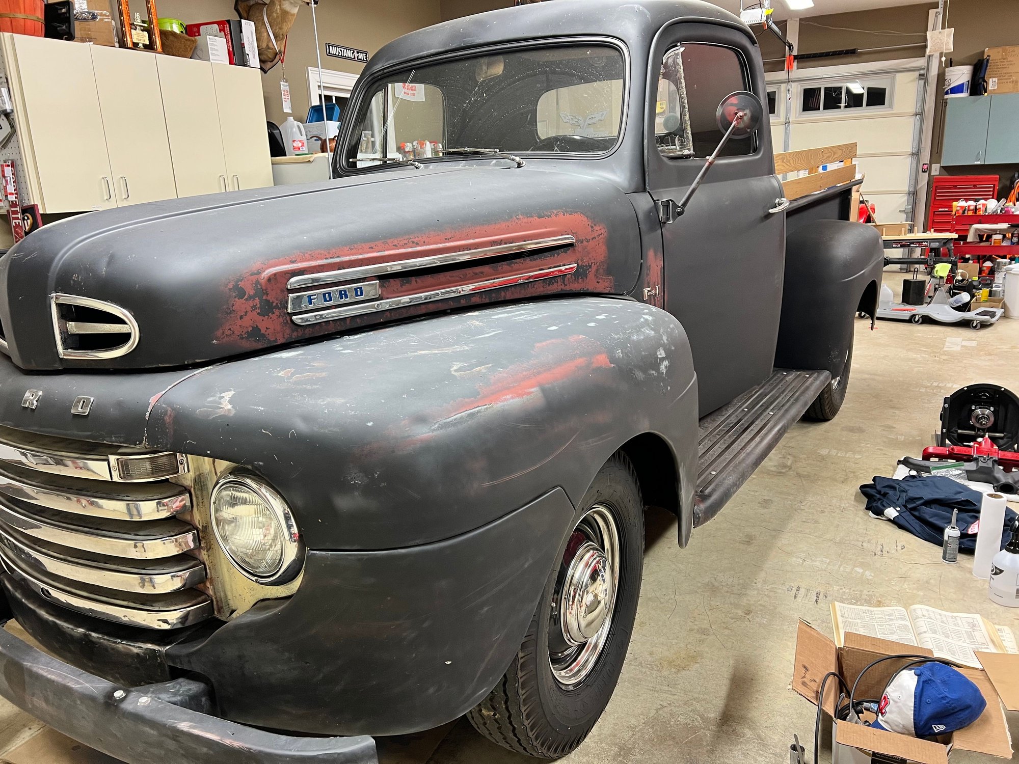

Got the 50 pulled into the shop and ready to be worked on. Depending on the snow tomorrow, we plan to start taking the front clip apart and remove the hood. While we are swapping engines, we are installing a new tank and fuel lines, and replacing some front suspension parts. Should be some good changes.
JB

From: Foothills of NC
Dang. That is a clean looking truck. Would like to find one looking that good.
Thanks bud, it’s a good farm truck. It’s popular in town. It’s been neglected and needs some things attended to.
