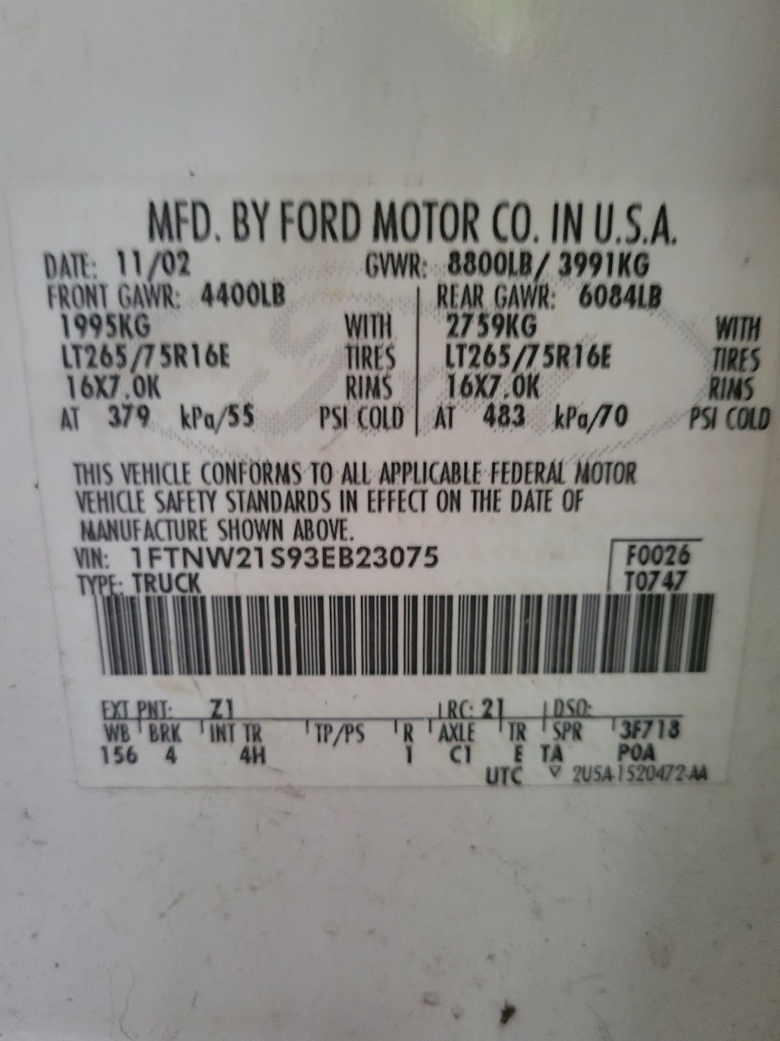

Can I find out what gears and springs I have from this??

Originally Posted by '01V10
If you go off of what other people are running with a tire size similar to what you are planning on running you'll get a good idea. Regardless of what springs you have now or how worn they are/aren't, the final outcome will be similar to anyone else's same gen f250. The springs that are in there are getting replaced anyway. I worded that like crap, but you probably get the idea. What are you looking to run? Side note - what gears are in it? You don't want to go big and run inadequate gears.
looks like I have c-1 so 3.75 and am running 285/75r16 33s now was hoping to run 315/75r16 35s next tire change and if I don't like it I would suck it up and have the guys that re geared my jeep do the truck. What do most recommend for gears and 35s thinking 4.10 or higher numerically?

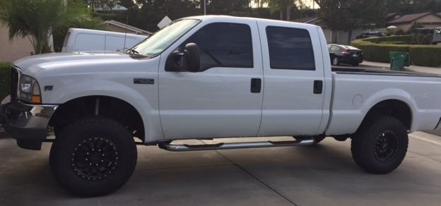

I put a leveling kit on my 03 so if you need questions about that Id be happy to help, Its a Donahoe hanger kit which is now ICON, 315/70/17 BFG AT2 on Methods. Bilstien 5100 on all fours
Thank! looks like my truck. That looks about like what I'm going after. Can you point me in the right direction to look that kit up?
Yes that is possible, I have seen guys do it here, but it's the older guys who been here a long time. I don't know myself. I wish I knew because I just bought an 03 FX F350 too and I want to make it higher for these hohrrible roads around here.
I figured it out. I found a site were I entered my Vin # and it gave my build sheet. I can't remember the site but it wasn't hard to find.

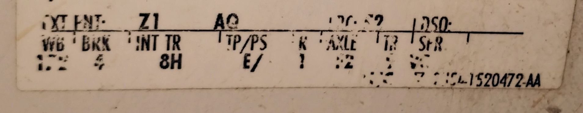

At least you can read your sticker. Here is mine below. The spring code area is rubbed off. I can see that axle code is F2 but the VIN decoder on FTE does not list that. I found on blueovaltrucks that it's an LS with 4.10s in the pumpkins. Joy is mine as I tow a lot. Because my truck is FX4, the leafs are different, or so I hear. FTE says it should be single front leaf, but I have double leafs up front, for example.

Going to search the glove box and see if the PO left me any original docs.
