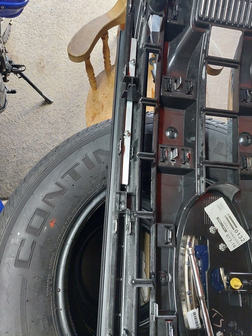

Think I'll see if I can mount my 20" double row in the gap for the trans cooler, like a few have illustrated above. Only thing is, those trucks don't seem to have the sensors for the adaptive cruise?
Not sure if that will work or not. My current mounting solution (light bull bar) works great, but the light bar ends up covering the fuel of view for my front camera.
So looking to correct that on the new truck
