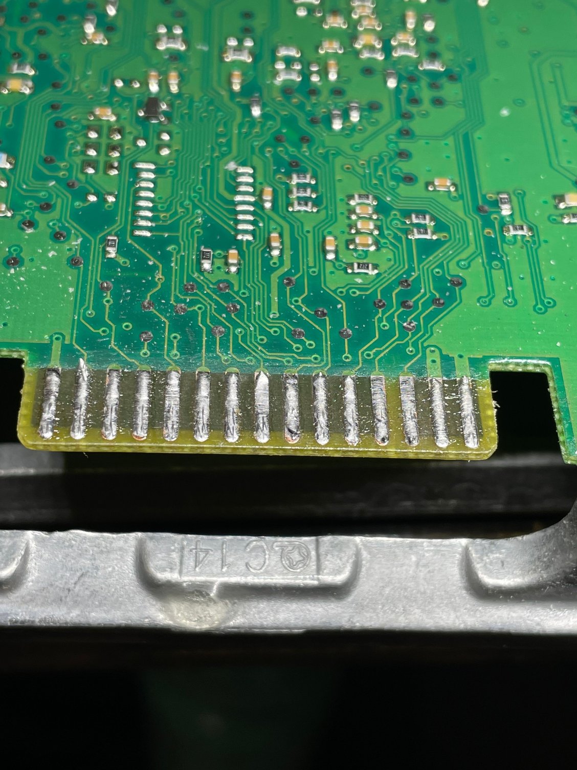

I was having issues with the hydra coming loose , had my buddy retin the pcm it fits nice and snug now!
I looked for ever bump i hit before and the truck would not die!
just looking at your pcm connection, it needs retinned badly

Thank you! I’ll get it done. The 20sec that it ran well are making me hopeful that’s ‘all’ it is

admittedly, not like smooth speed bumps like from php’s video. I can try to redo it, I thought doing both sides (I’ve seen people getting away with only doing one, but figured my luck streak would continue and that wouldn’t be enough). Same thing still happens. Fired up great, sounded good for about 15sec, started to choke on itself, idle changed, and it started doing the same thing. I’ll post the logs up in a bit, have to format them.

Here are the attached logs. Absolutely zero change from before I attempted to do the retinning. That leads me to think, though it needed it, something else is going on? I would have thought I would have at least held a connection longer, if that was the issue, but it was the same exact symptoms. Started up extremely well. Idle well. and about 20sec into it or so, it idled down, acted like it was going to choke on itself, let out a little puff of smoke, and went into the same cyclic idle up and down, attempted to drive in the neighborhood and there was absolutely no pedal.
I think I am going to break down and try to call CNC tomorrow and see if they have any idea, as that is who I bought the chip from. They have not been responding to email, I can only assume they are extremely busy and not that they automatically think it's a tune issue or something. I have tried tunes from both AA and Hydra's Titan Unlock library, doesnt matter. I dont WANT to send the PCM to someone like PHP now as I just spent the time and money upgrading my soldering equipment to no crap make an attempt at this, but should I do that AND see if they will look at the hydra chip as well?

I don't know - yes that solder looks rough, but I would expect each contact in the hydra edge connector to be making strong contact now with the solder you added.
