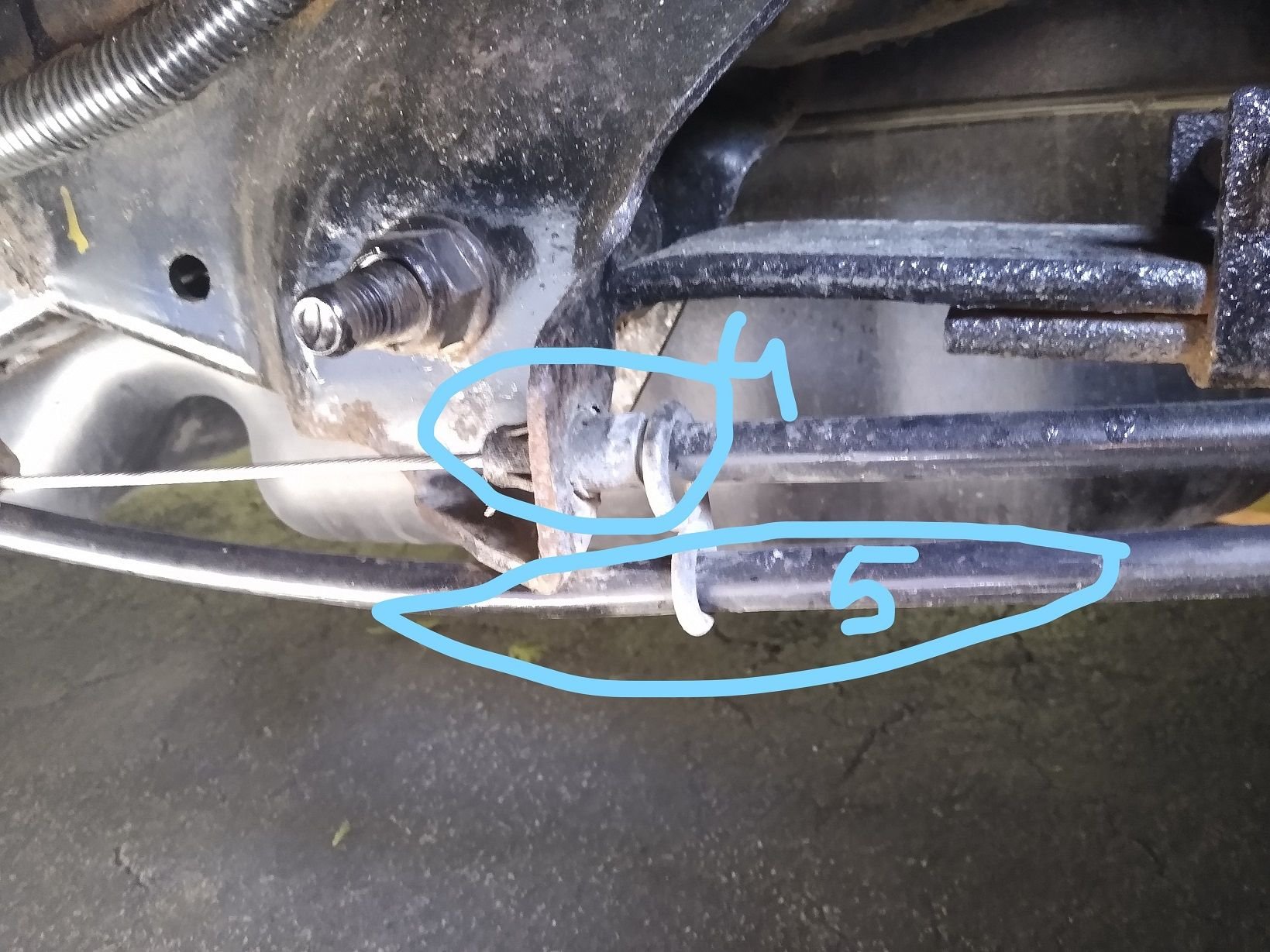

I think when mechanic certified the truck and put new cables in I think he missed some thing.
1 goes through 3.
2 goes through 4
1 connected to 2 via clip in the picture.
When brake is engaged or cable is pulled.... it pulls whole clip to wards front of the truck... that create pull on 2...4 resists .. as a result pull is passes on to lever on driver side ebrake.
Driver side ebrake is works and locks solid.
PROBLEM:
When brake is engaged or cable is pulled... clip and 3 moves forward as whole. .. you can see in 5 there nothing created resistance...and keeping black cover in place so cable inside can move.
When I pull the cable or engage the brake... there is almost zero pull on passenger side lever/brake.
come on.. some one must have seen this before?

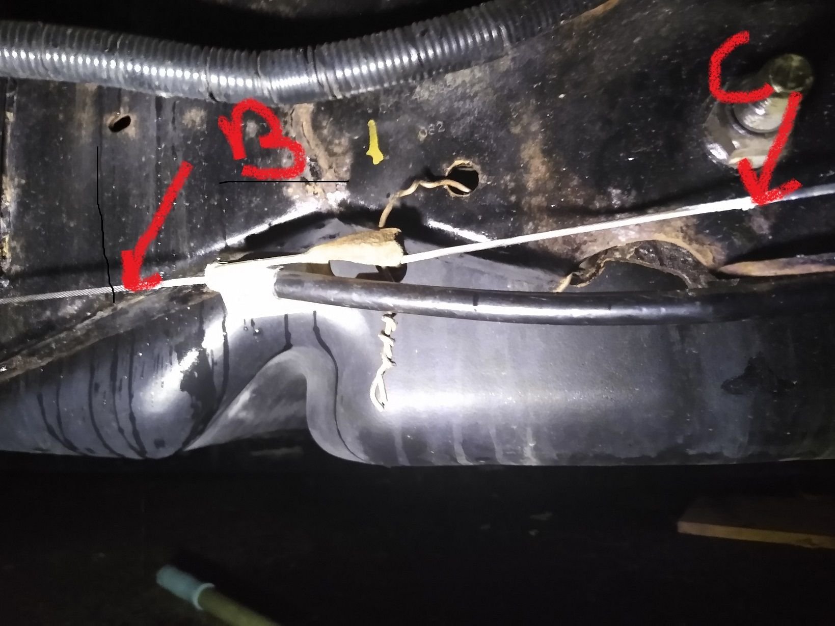

So after little bit of thinking I came up with this idea. With coat hanger cable. I restricted clip to go any further then 2 inches. 2 inches was the pull need for driver side brake to engage full.
What do you know.. now brake lever could go much further down.. and cable from 5(above) and B here .. started coming out after pull on "C" stops because of coat hanger..... and I think now passenger side brake would engage.. It was raining so I could not much time out side.
All that tells me there must be one part missing in the cabling hardware/accessories....Cant find any such looking thing on rockauto.. so I will go junk yard and see what I find.
