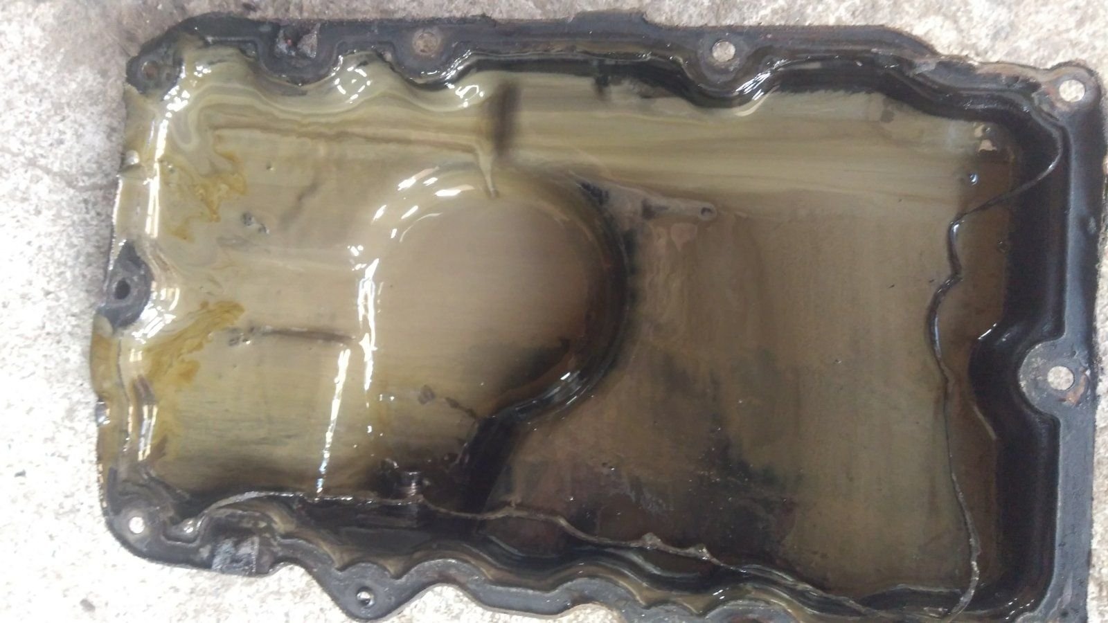

Old Sep 8, 2021 | 10:50 AM
Pablo-UA's Avatar
Pablo-UA
Posts: 5,242
From: Kiev, Ukraine
my radiator was c;ogged and engine gpt some thermal stress
My engine is totally taken apart and i cant see ballansing shaft! it is really wierd.
Old Sep 8, 2021 | 03:14 PM
Pablo-UA's Avatar
Pablo-UA
Posts: 5,242
From: Kiev, Ukraine
