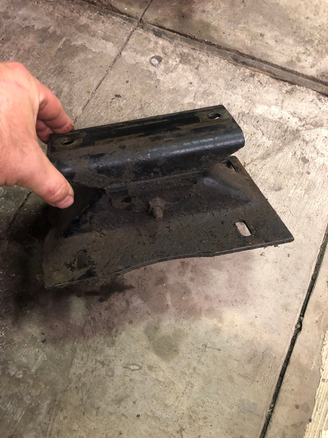

Are the automatic and manual transmission mounts the same? The mount I got with the trans is the same as the one that was on my c6. I can make it work but it doesn’t line up right.

I think they are the same. I re-used the C6 mount but I had to move my crossmember to make it mount up. Mine was a ZF5 so I knew it was going to be off a couple of inches. I think I read the NP435 may be closer but it will also depend on which C6 you have. There are two versions in the 4x4 truck, one with a short tail housing and one with a longer tail housing. Mine (79 F-250) had the longer one. I learned this the hard way by buying a used C6 and then finding out about the different lengths. I worked on a 77 F-150 recently that had the shorter version so I’m not sure which trucks had longer vs shorter. My trans mount and the others I’ve seen look just like yours.

I guess I will just make what I have work.

I don't know if the tranny mounts are the same between autos and manuals, but here's the engineering ID stamped into the manual mount that's on mine. I was cleaning it up and took a pic, because ya never know.
