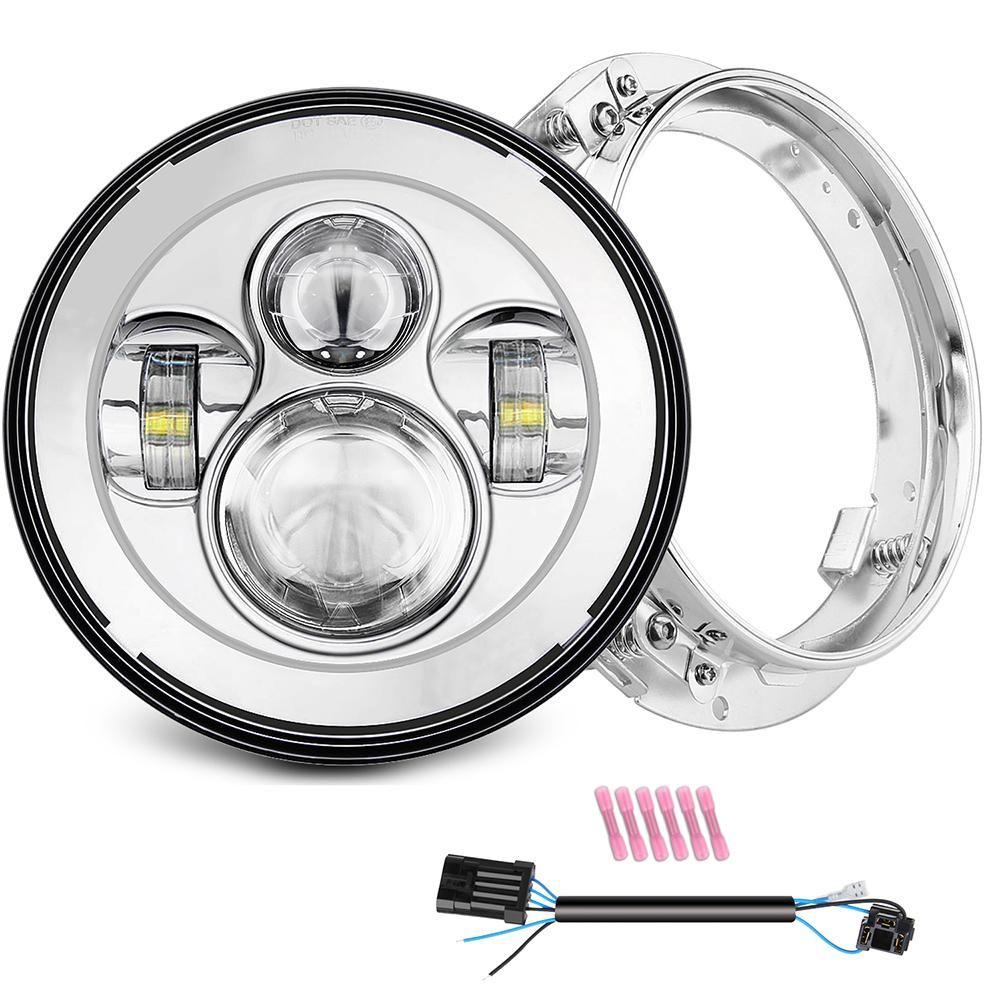

I've gone thru a few different types on my Harley. The first ones were fairly inexpensive. They used a LED bulb that screwed into a regular 7" round headlight (not a sealed beam).
Although better than a sealed beam, it was not what I was looking for, which was a wide flat BRIGHT beam. But they looked right on the bike. Everyone was recommending the JW Speaker lights.....at 250 bucks a pop!
I bought one called Sun-Pie. Asian made, priced right (about as good as it gets) at about $75 and super bright. But it looks modern (see picture). I wouldn't like that on a vintage truck. So on my '65 I will probably go with the type I had at first on the Harley. Maybe in pairs the beam will be better

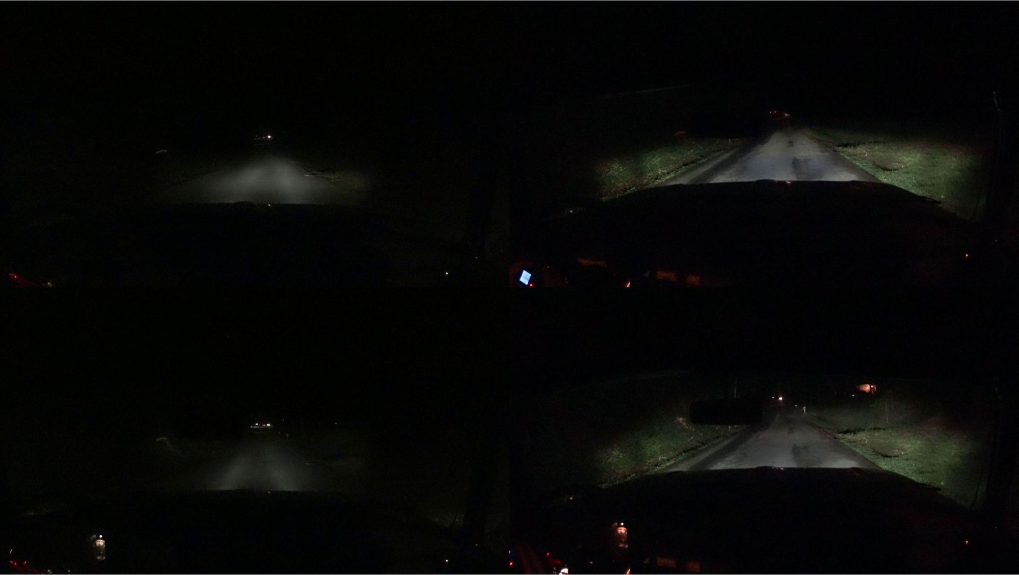

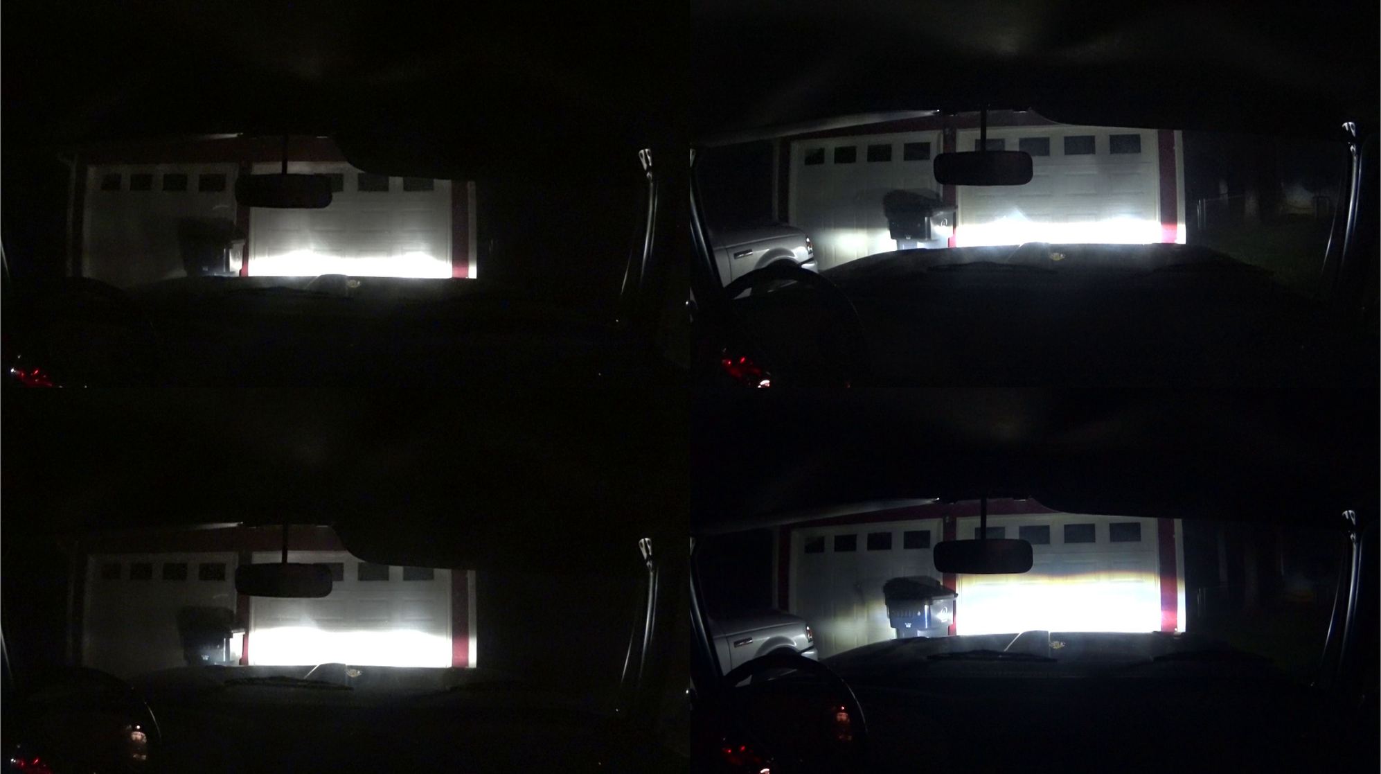

I have the JW Speaker headlights. As said above, the aesthetic is not the greatest for an older vehicle but they work great. They look more or less like the Sun-Pie above (other way around, actually). At the time, about 3 years ago, I felt they were the best functional option on the market. These particular lights have a 28w low beam and 42w high beam.
These pics show the differences vs sealed beam. In each, left is sealed beam, right is LED, top is low beam bottom is high beam.
