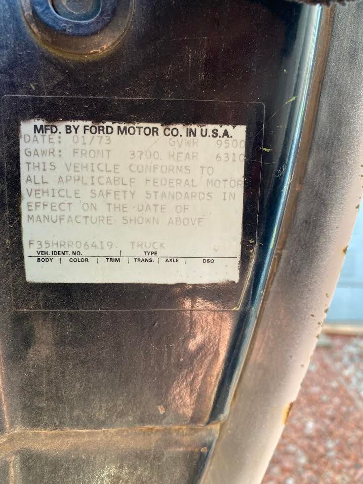

Drivers side door pillar. Warranty plate/sticker

this right?

Link not working

There is no info on that other than the VIN and axle ratings.
Not much we can do....

Wouldn't there be a Warranty Plate on the driver's door as well? The Certification Labels I've seen only occasionally have the full info printed on them, but the Warranty Plate should have at least more of what you are looking for.
Why would a 2wd truck have a front Axle GAWR? Never had an older 2wd truck myself, so just curious if that's a thing. Seems there might be a precedent for a front load rating, but I've only associated them with 4wd front axles/differentials.
Were you told it was a conversion, or did you determine that from your own inspection?
Lots of things happen in 50 years of life of a truck, but as many here will tell you, converting a Ford to 4wd was not such an easy task as to have many actually go through with it.
There are some good ones here showing it can certainly be done, but it ain't for the faint of heart!

Gotcha. Yeah an extended wheelbase truck would have only been 2wd I'm pretty sure.
It should also have the spare tire compartment there on the passenger side of the bed. But it would also have come with the same narrow (34-ish inches) frame width in the rear as a high-boy. So there are other clues to be had if you want to keep digging, but it doesn't sound like it's needed at this point.
I still wonder about the front F35 and the GAWR though. Maybe body parts were swapped as well.
Seems like you can tell if it's 2 or 4 wheel drive just from the first three or four digits of the VIN.
Anyway, I'm obviously not the expert here, so someone else will hopefully have anything to add for your information.
