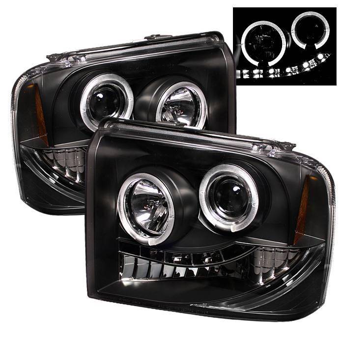

I have ordered a set of these Spyder 05 07 lights.
Couldn't find anything I liked in 99 04. Knew I was going to have to modify stuff anyway as I have sealed beam style lights, so
I actually looked at the style you posted but I felt the light looked too boxy for my tastes. Also felt these would go better with the 05 07 raptor style grille I ordered.
Still a couple of weeks away from getting them to me unfortunately so can't comment on wiring or fitments etc.
Although im not 100% convinced on the round halos I can leave them not wired up if need be and just have the swooping DRL on underneath if I choose. Will wait and see when they are on the Truck.
Link https://www.spyderauto.com/product.p...-YD-FS05-HL-BK

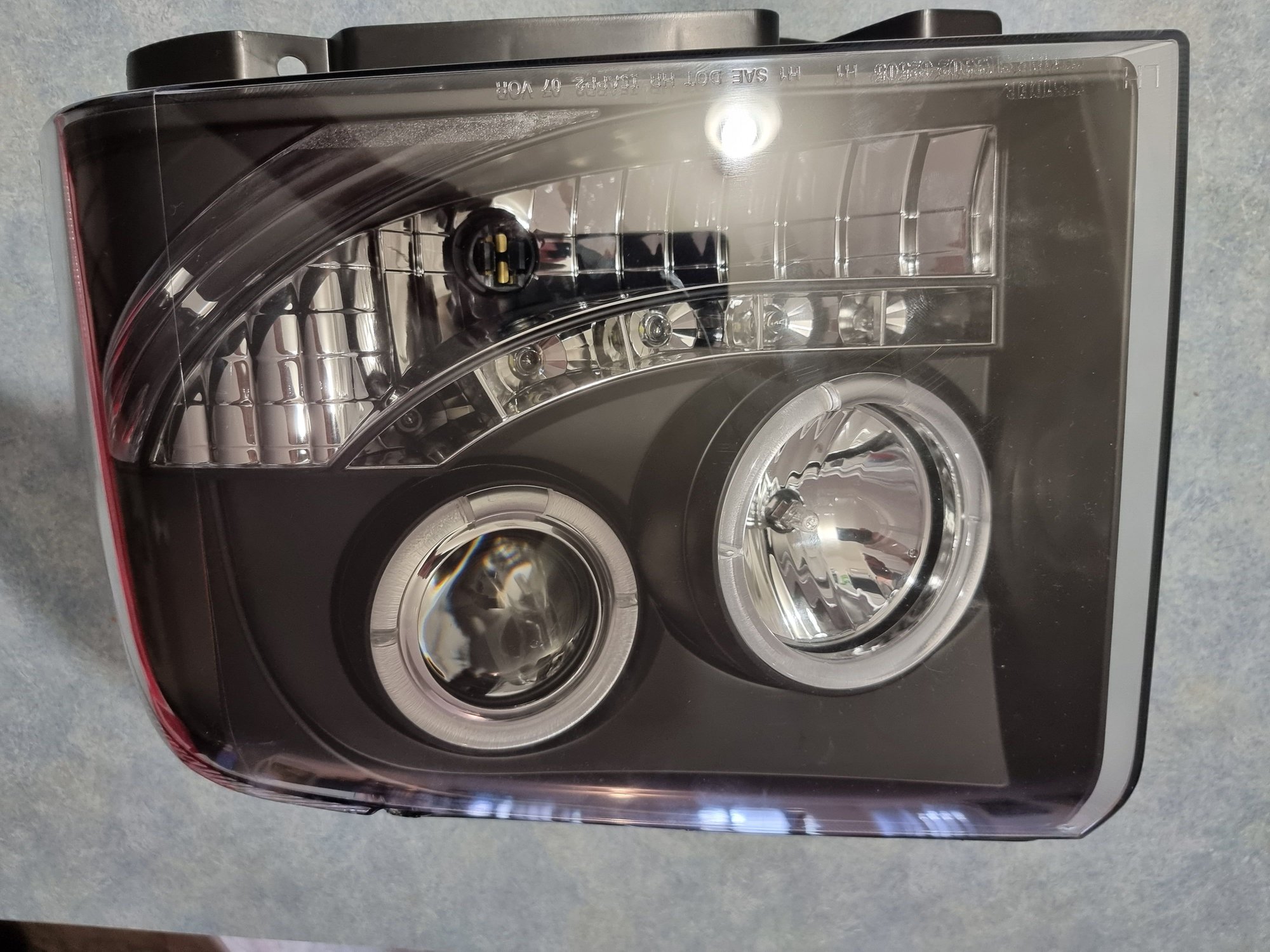

@Shovelheadrob no mate they are sitting in my lounge room waiting. I received them start of last week after waiting ages for them. Shipping delays due to Covid.
I cant wait to fit them up which will be hopefully soon. Im aiming within the next week or 2. Issue is I need to take off the steel bullbar to fit the new 05-07 grille at the same time. Bit tough on my own due to the weight but doable.
First of all they were packaged great from Spyder, so I must highlight that. Upon initial inspection I have found the build quality to be pretty good. The sealant used is pretty even all round. The wires seem pretty decent. The globes they fitted are Osram . The sockets are all of a decent quality and fitment. So it's not bottom of the parts bin crap if you get what I mean.
The adjustment screws do up and down , left and right. I have seen some aftermarket lights with just up and down.
I can wire the Halos up seperate to the other DRL or not at all if I wish. I like that.
It's all pretty straight forward as far as wiring goes. According to the manual, all black wires are grounds, rest are power wires. Inlike it when a manufacturer does something logical.The headlights will work via original harness and an adapter.
By the looks of it the original turn signal globe will fit direct into the available socket in the new light (the one with the green and yellow wire coming out). Dont quote me on that til I fit it up though .
Run the DRL however you see fit to comply with your local regulations. I will have mine switch on with ignition. Halos I will probably run off of a switch depending on how I like them and brightness.
Once I get them installed I will report back with pic of the cut off and initial impressions.
Sorry its upside down. Dont know what happened
Main globe harness is the black red and white coming from the plug. Green yellow and black is the socket that the turn signal should go into. Rest is for DRL and Halo lights. Globes fitted are Osram halogens. Inwill more than likely switch them out for LED globes once Inget the install sorted.
