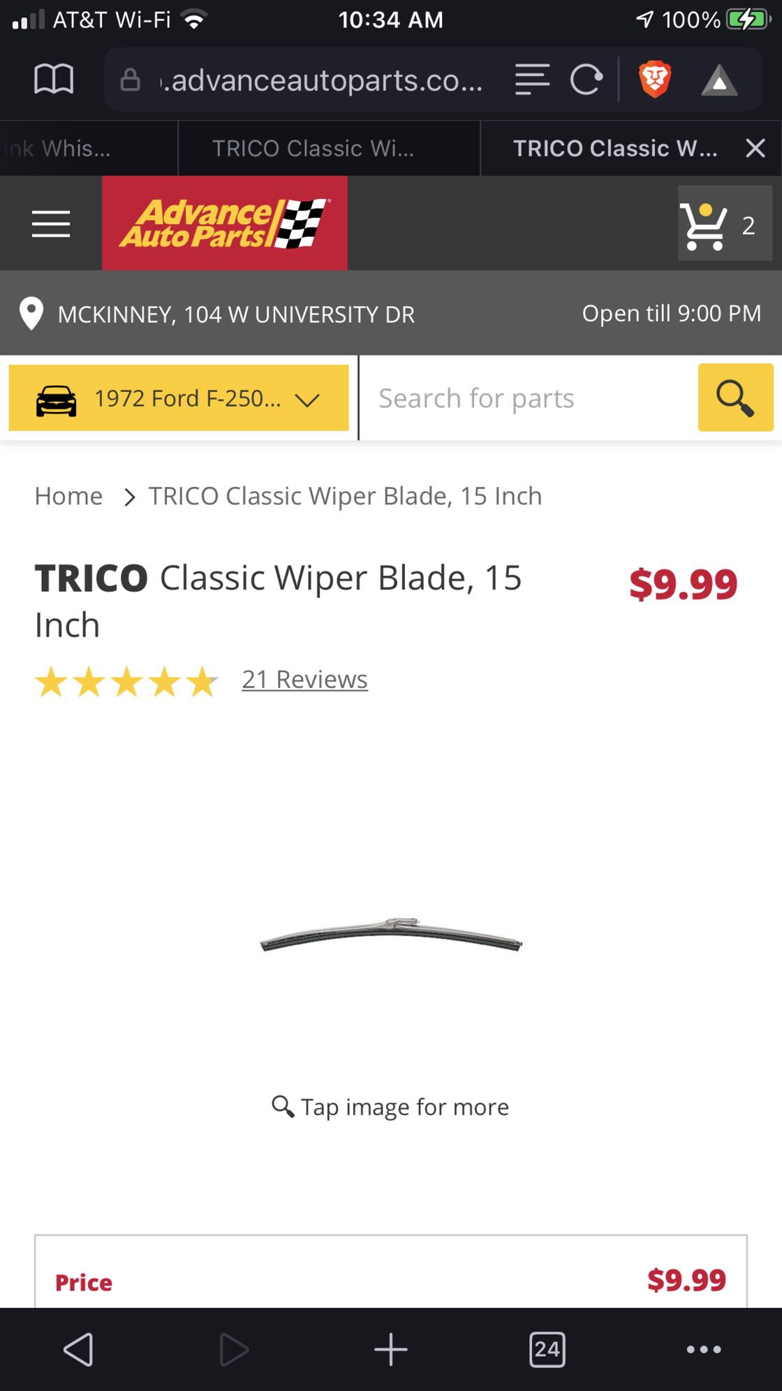

Have you guys personally used the trico classic "15? Bayonet? Do they fit a 71 f250

I have the 15" Trico Classics on my 71' F250. Coincidentally, they're the same size blades that fit my 67' Cougar. I'm happy with the way they look/perform. Haven't used them in snow/ice though.

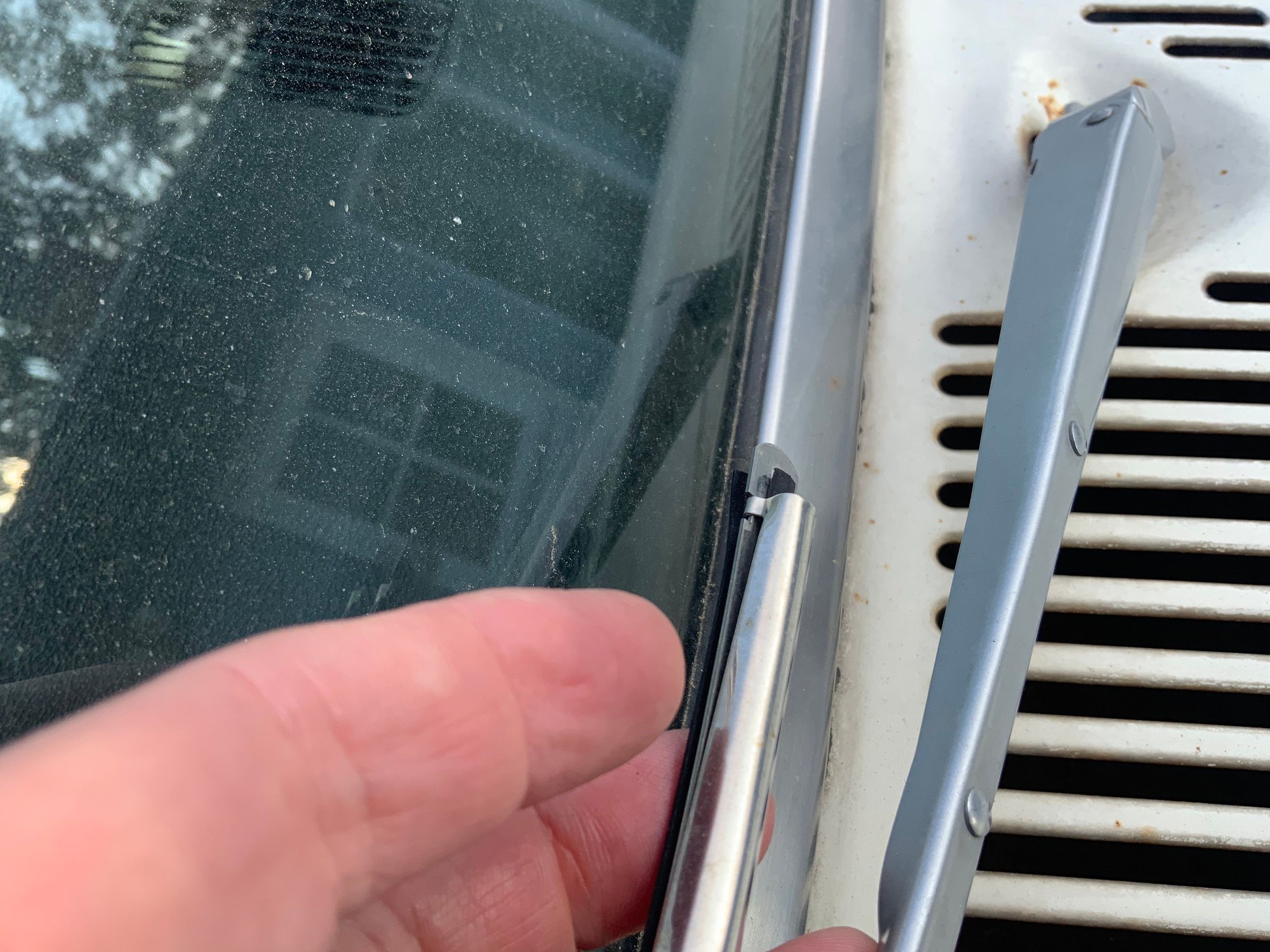

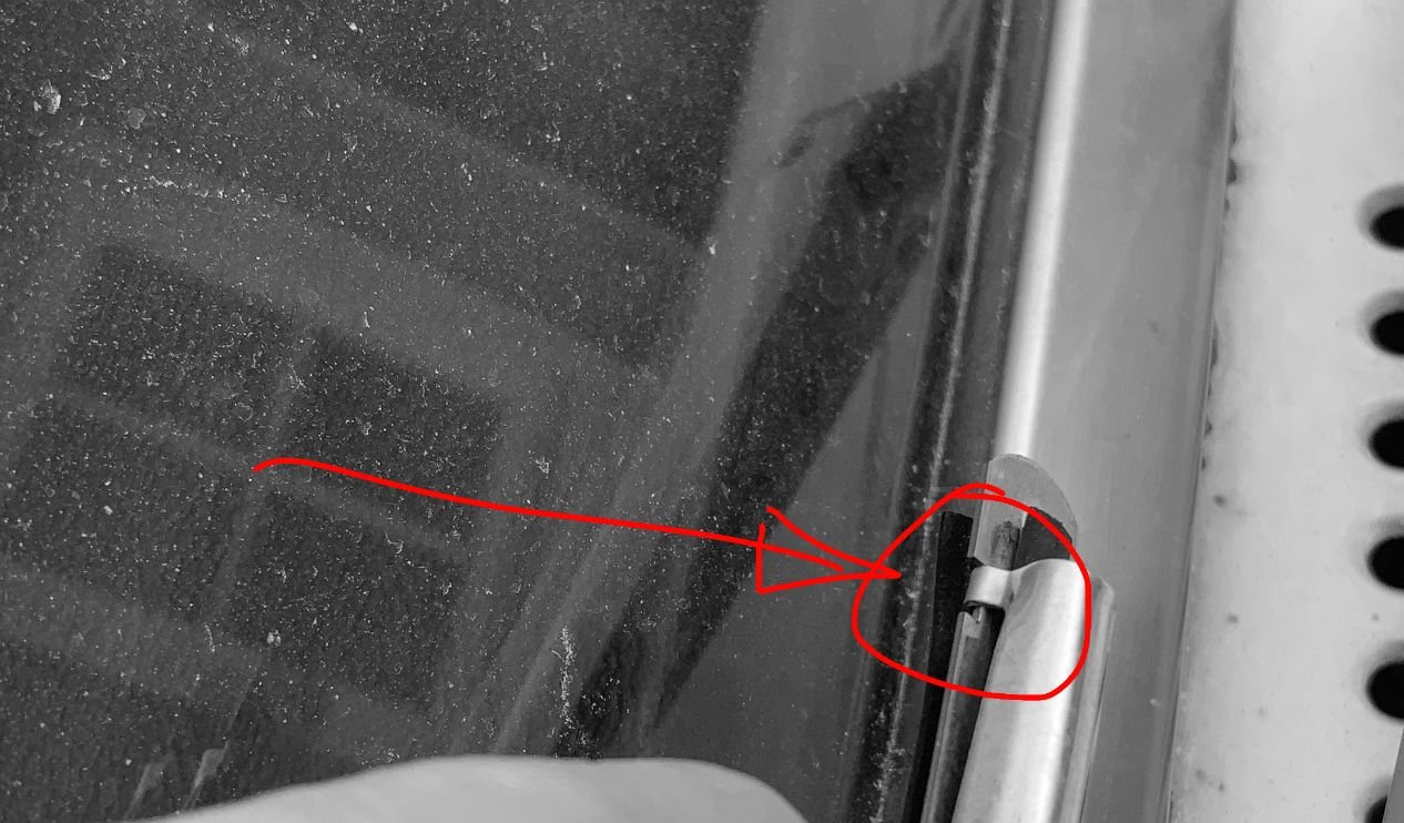

I can’t even figure out how to remove the blades. It’s almost like you have to bend the bracket holding the blade in place.
Won’t slide out

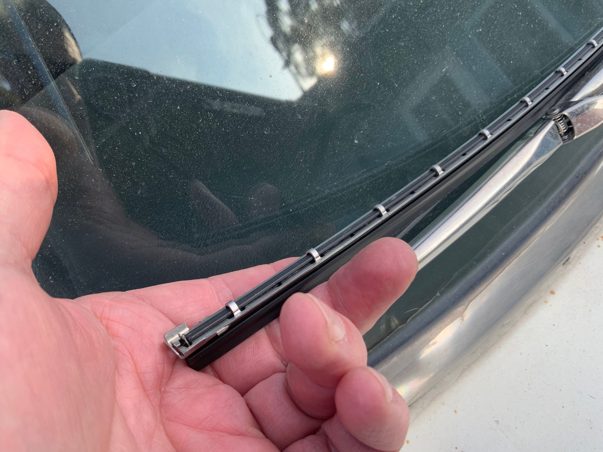

New blade

I just ended up bending the tabs at the end and slid out the old and slid in the new blade and bent the tabs back.

I get those in person only and look at them. Usually you squeeze one end together to slide them on and off. I like the original arms so I always get the replacement blade only as well. Ive used trico and whatever is reasonable.
