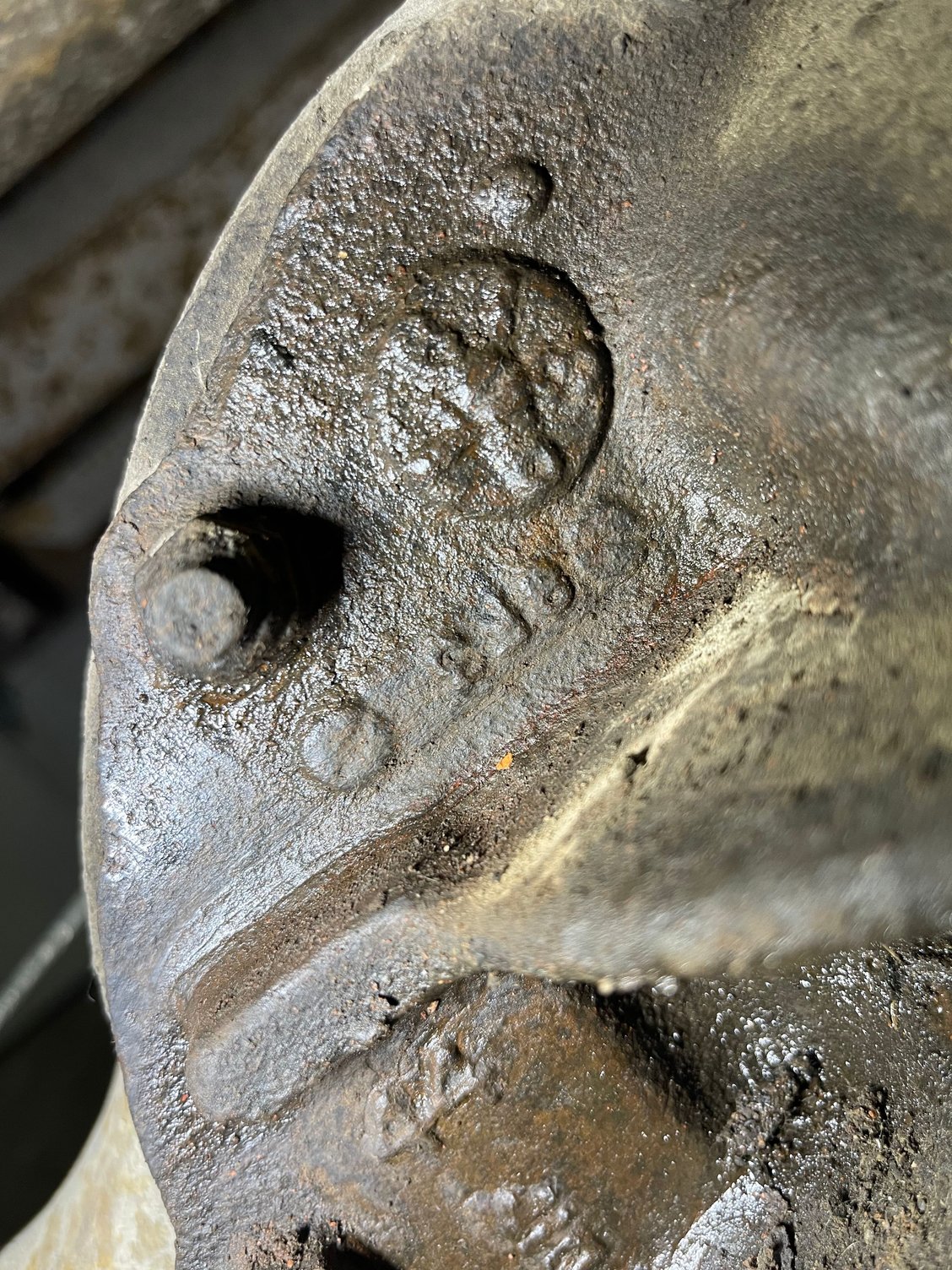

I crawled under and gave the old girl a scrap!
No axle tag, must have been removed or torn off. But there are some markings on it, have a peek.
What do you guys think?

The 17 code is 3.25. The axle model was coded on a metal tag under the pumpkin nuts. With it being gone, it means that your pumpkin has been removed at one time for repair or replacement. The different cast markings on the pumpkin are just foundry marks and casting date codes, nothing more. The only way now to identify what gear you have now is just to pull the pumpkin and count the gear teeth of the ring and pinion gears and do the math.
