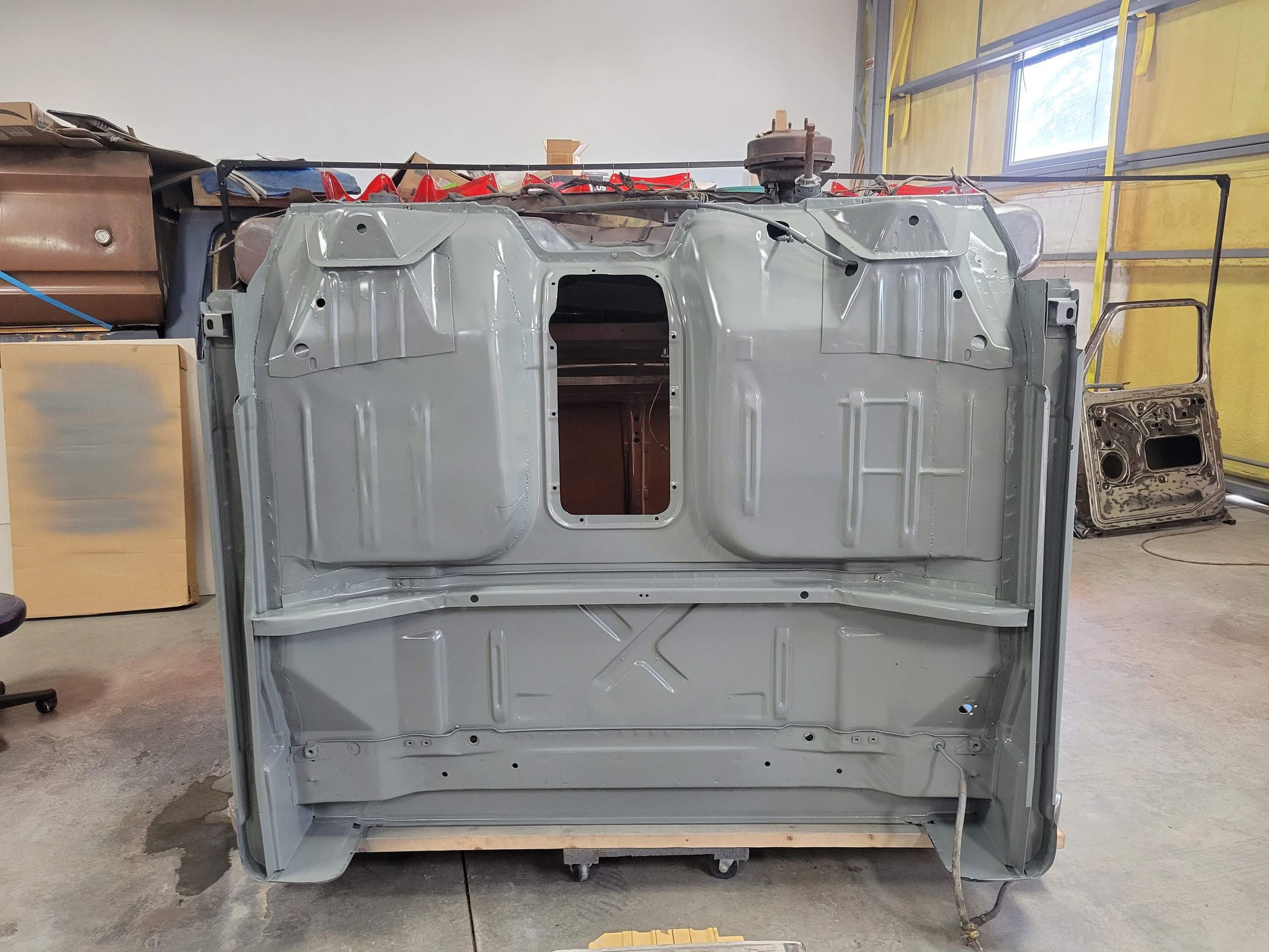

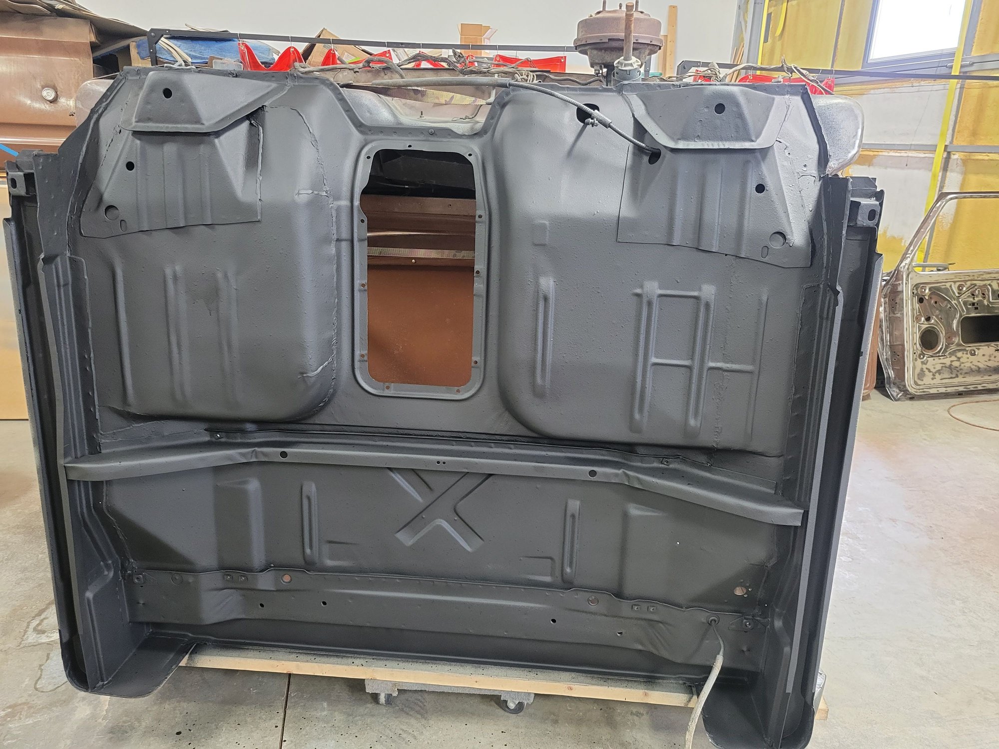

I just did an undercoating on the bottom of my cab. I used a 3M rubberized undercoating. Before I sprayed it on I spent a considerable amount of time pressure washing and taking it down to mostly bare metal. Using sand paper, DA, wire wheels, stripper disks and various grinders, it was a long process . Then I sprayed a 2 part epoxy prime. Then used Seam sealer anywhere I could find that needed it. I certainly hope it will hold up over time.
