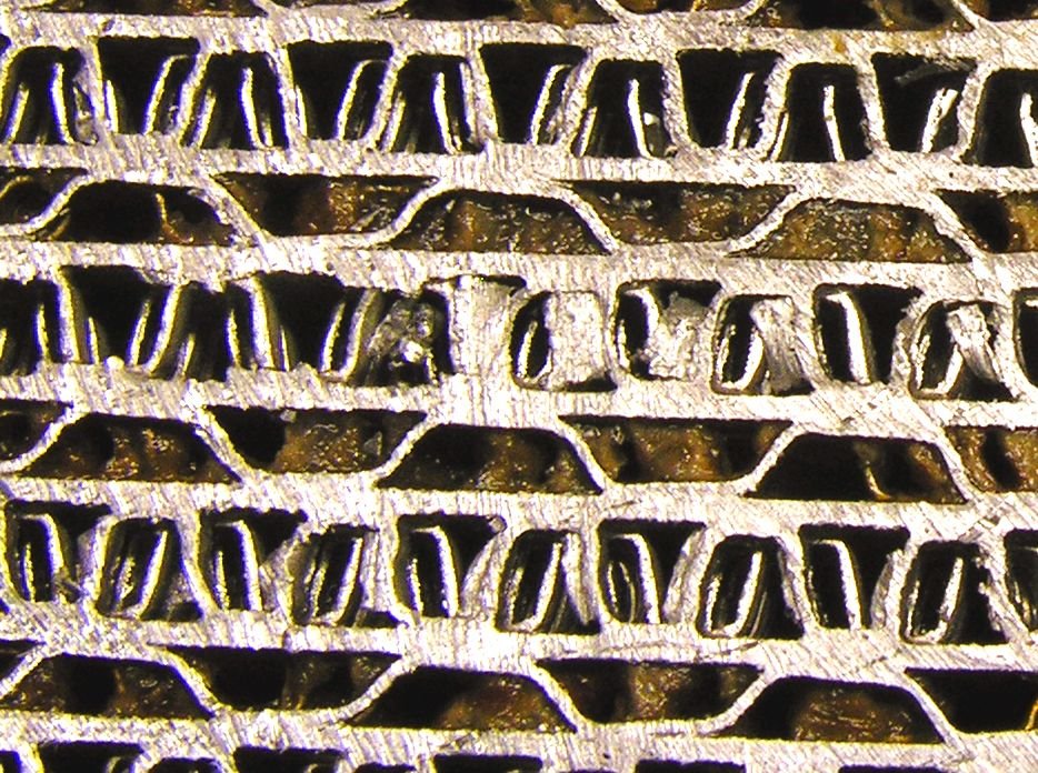

Hartwig, I'm really not sure what would really dissolve the material. But, at some point, I want to dump a test section of my old heater core or oil cooler into a bath of the Cascade with Dawn and observe what it does.
When I cut apart my old oil cooler after flushing with Restore, RestorePlus, Ford VC-9, there was still the silicate. And I ran for longer than recommended and all of those twice. After that, I got a little better, but not to the point where you would not replace the oil cooler.
At the time, those were the three which we all called on to use. I did not use and have bought Ford VC-1, which is supposed to be a silicate cleaner. So that another bath for old parts to try, but I don't know that it would clean this mess. The Restore products, per the MSDS, are the same as the Ford products.
I'll add in the photos I have from the prior work I believe you've seen, but add for those who have not.
Karl's (Nylyon) cooler was never flushed.
My original cooler ran all of those chemicals for days. I had the same differential as Karl to start with, so I think the chemical cleaning helped, but using the chemicals for many more hours than the companies recommend. While it's more open, the silicate, I believe, insulated the cooling effects. And with the heater core cut apart lately, the material was still in there, too.
My cooler from the new engine that always ran ELC. The passages were clear, but the intake port was clogged with particles. That possibly could have been backflushed out but would have taken several attempts.
