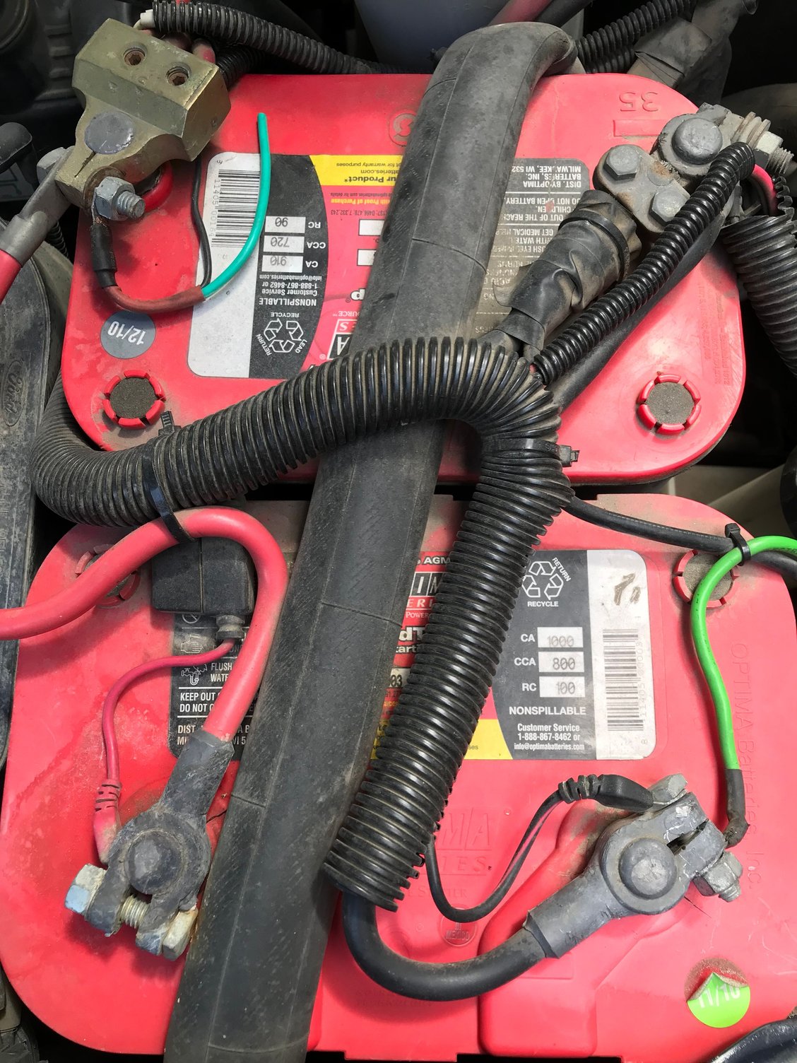

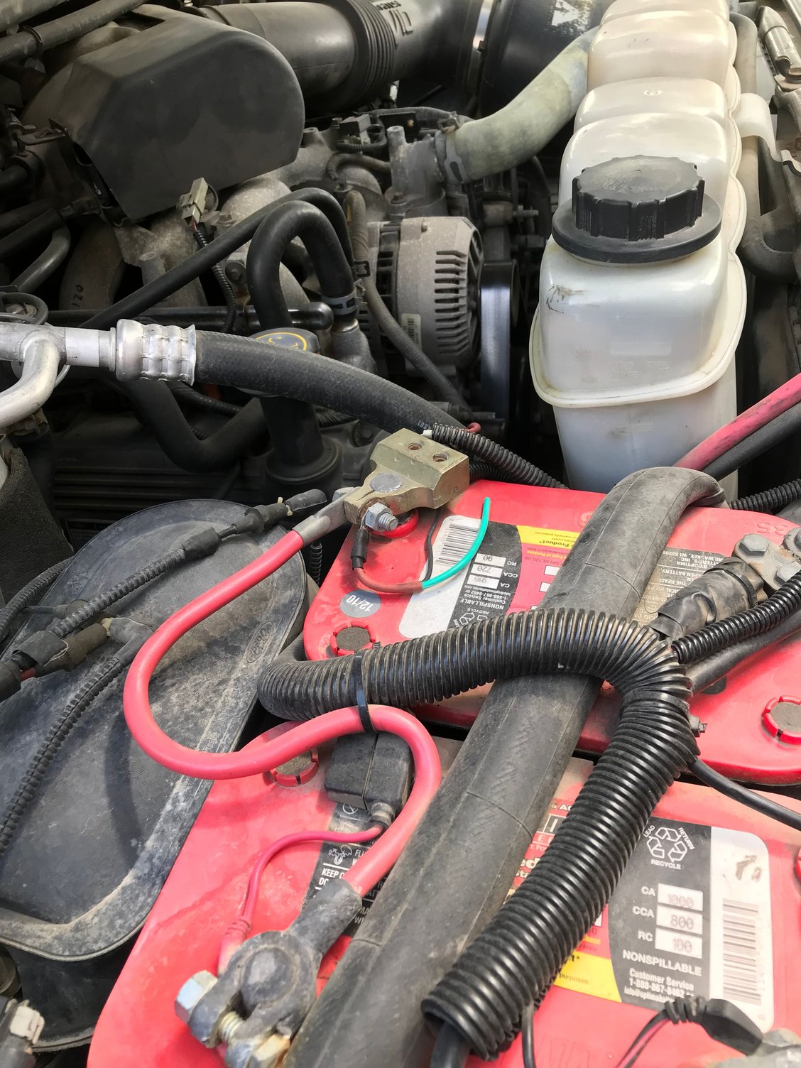

I’ve had these dual (mix-match post#64), Optimas for 11 yrs and they’re about done.
Are AGM batteries, still a value for the price or should I just go back to lead acid?
I plan on returning to a single battery. No special electrical needs, I have an under-hood viair compressor and bumper winch, but rarely use either.
