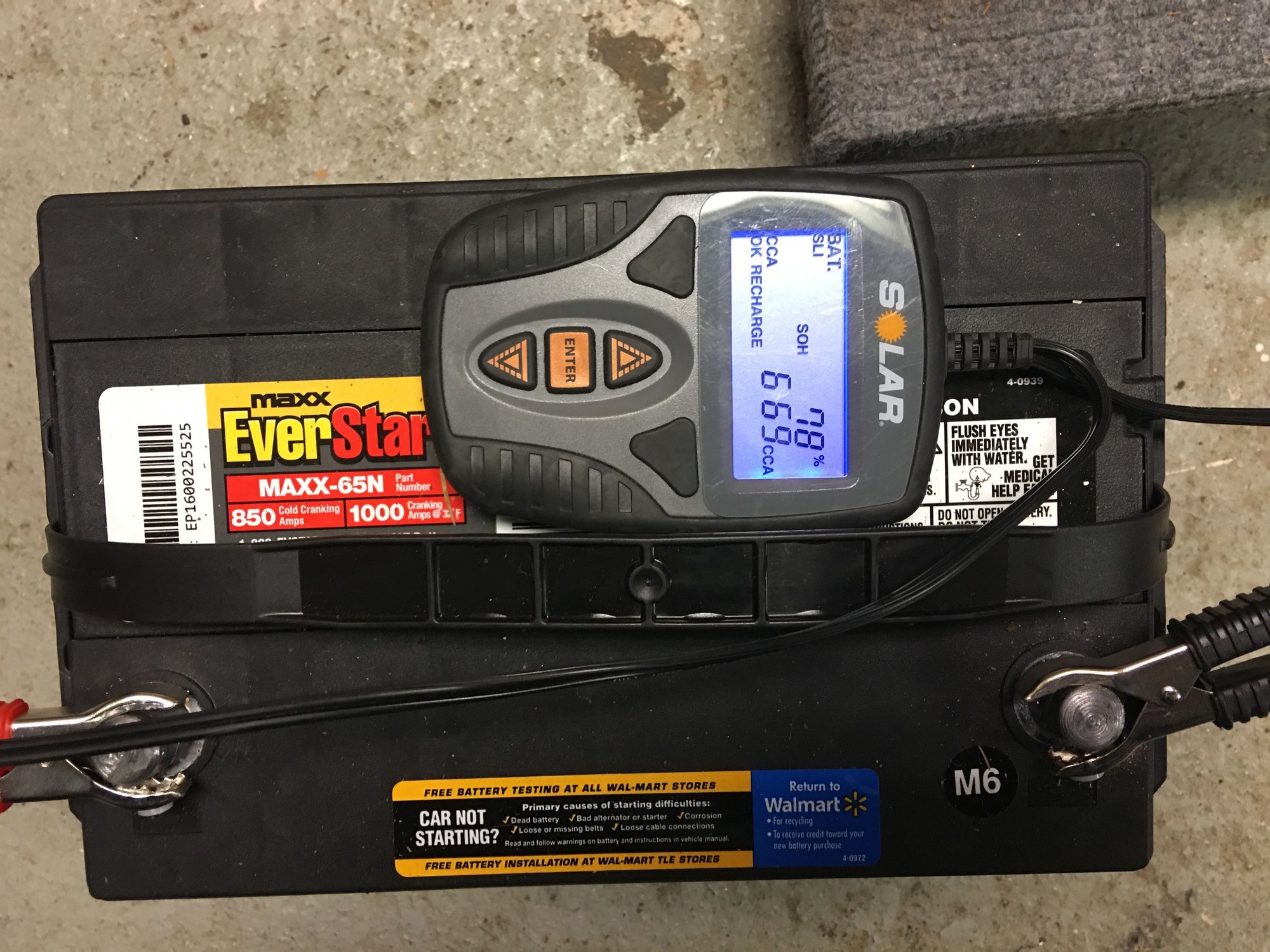

I've used and talked about the battery tester I've been using for a while since I can't use a refractory specific gravity test on sealed batteries. Chris has it's brother and doesn't think it shows bad batteries that well. It might not. Or maybe it's not that CCA is the best determinant. In a recent discussion Ted brought up these have calcium added to them, so the max charged voltage should be higher than 12.6v, more towards 12.8v. Which brings up the quandary of my tester, what type of battery should it be switched to? They are not AGMs. But if you use SLI (Start-Light-Ignition) it's comparing to 12.6v. I used both SLI and Gel, try to find a gel battery these days.
Anyway, 3 batteries of the same type, different service conditions, and 2 brand new batteries at Walmart I also read this morning. Along with how they recovered with the reconditioning mode.
So just showing what I generated, the charger used and the tester used. It may be that CCA is not the best judgment of a battery condition, but the battery internal resistance is. AGMs have a lower internal resistance then SLI, so they start the vehicle faster and recharge faster. Resistance changes with temperature, colder equals higher resistance, once of the reasons it's harder to start a vehicle in the cold weather.
Not a battery pi$$ing contest. While in the past I've used the tool to find the highest CCA batteries at Walmart, and suggested to do so with other retailers, maybe it's the resistance that's more important.
I took an image of each test and stage in case anyone want's to see something in more detail.

Jack: I must not be understanding something on the CCA vs internal resistance - just glancing at your table and the two on the shelf batteries versus anything else you tested that came close to them, the CCA and IR tracked pretty close. Tell me what rabbit hole I need to go down...

I’m trying to figure this out too. The LS battery is hurting though.
Usually when I’ve used this tester I set up the parameters and run the test, and it’s shows the voltage and CCA. It also gives an OK, Recharge, or Bad. If you arrow up you can check SOC, SOH and resistance.
CCA may track with resistance, but since resistance goes up with aging, maybe it’s better to follow the resistance of the battery, since it’s resistance that inhibits current flow.
Either way, the charger (is that one you have?) allows for reconditioning, and it seems to do well. It certainly brought battery 1 back to new like resistance, and CCA.
The LS has been struggling lately. Not something Les would notice, but when it drops into the nines the PCM whacks out. In the late fall we had guys come through the neighbor hood cars. Even though the battery saver shut everything down, they left the glovebox and driver’s door ajar. It hastened the battery. I put my voltage monitor in the powerport, and even with long drives of 14.0-14.2v, next morning volts would be at 12.0, just as the first test of that battery shows.
Now that I've got it up and need to put it back in for a few days and see how the LS distresses it. Tough car. It may get warranted, and if it does, maybe battery 2 will go in and the newest battery kept in 2’s place.
The main point of the post was for discussion and to show the ability to recharge an in-service battery. I still like to take an in-service battery that going to sit in a vehicle over the weekend and give it a FULL recharge, something as we know it’s never going to get just being driven around.

If you look at the LS battery, after recon the CCA for an 850 is pretty good, and the state of health and charge both show good percentages, especially compared to where it was. But the resistance is still high compared to its brethren, and that may therefore not transmit all that CCA in a good way, so slow starting, especially with a diesel. So maybe resistance is a better tell.

No, it was just meant to show I have the display of the data if someone really needs to see the actual displays, but the data is all in the table.
The point was now I'm starting to look at resistance which may be a better indication of battery health than the CCA readings, influenced after Chris didn't get a warm and fuzzy. Today I'll get the LS battery back in the car and use it for a week to see how it responds in the vehicle. Ease of starting and how well it reabsorbs its charge.

The LS batt pre-Recon, SLI only.
Post 2nd Recon, both SLI and Gel. Still not sure what test mode with the Ca addition.
SLI setting first, 12.6v target.
"Gel" setting, 12.8v target.
