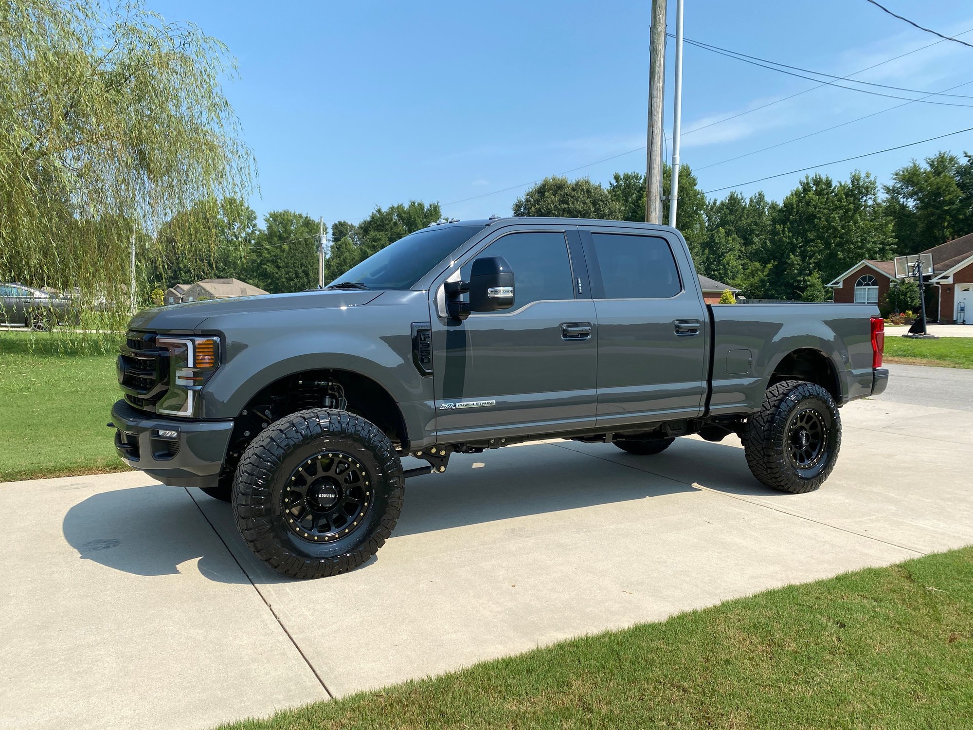

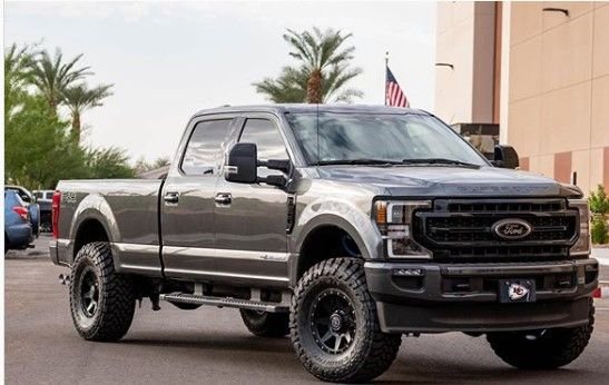

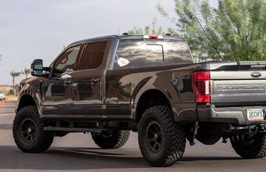

Not counting the air bags it was around $12k installed with wheels and tires, not cheap. These pics are prior to the radius arms, and stabilizers, but that wouldn't have changed the height/look, obviously.
Beautiful rig man! That is pricey, but worth every penny i’m sure.

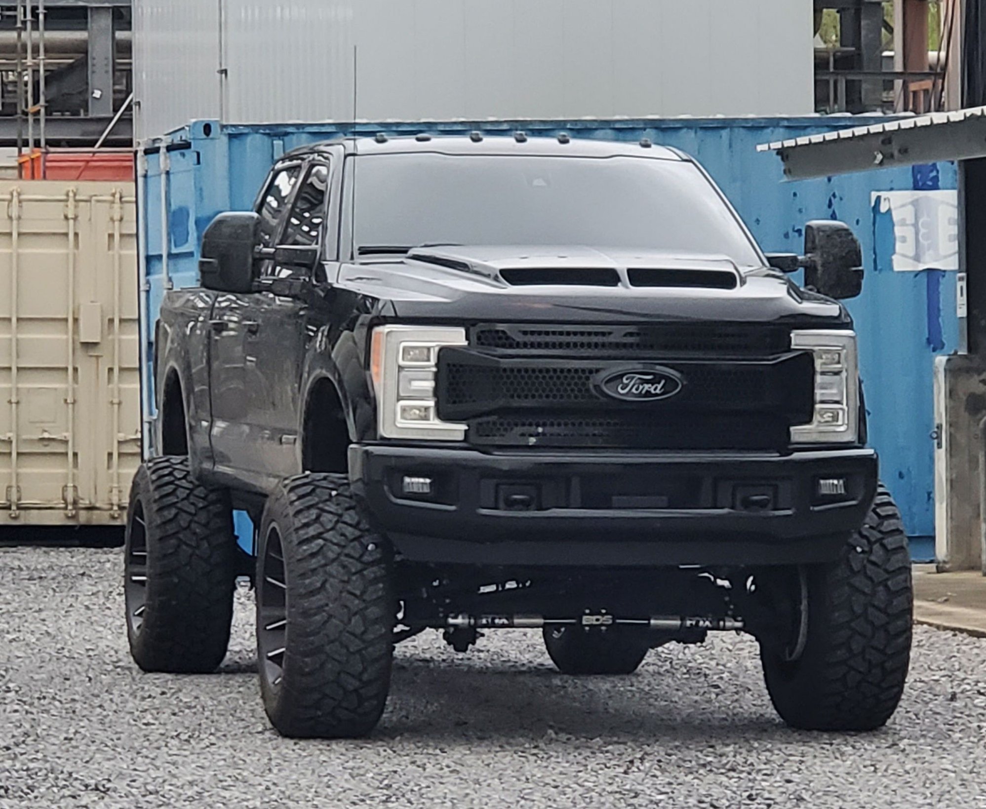

I had a BDS on my F150 and I loved how solid it felt. When I bought my F250, I knew I was going back with BDS. I have the 8" BDS 4-link kit, 2.5" Fox coilovers with reservoir and Fox shocks in the rear. I also went with the Fox dual steering stabalizer, adjustable trackbar, PMF draglink, and PMF tie rod bar with XRF end links. I have 40" Fury Country Hunter MTII. This setup has an extremely smooth ride for such a big truck. It rides better than stock. I highly recommend upgrading the shocks to Fox or King. One of the things I love about this kit is there are grease zerks everywhere and all of the bushings and ends are serviceable.
