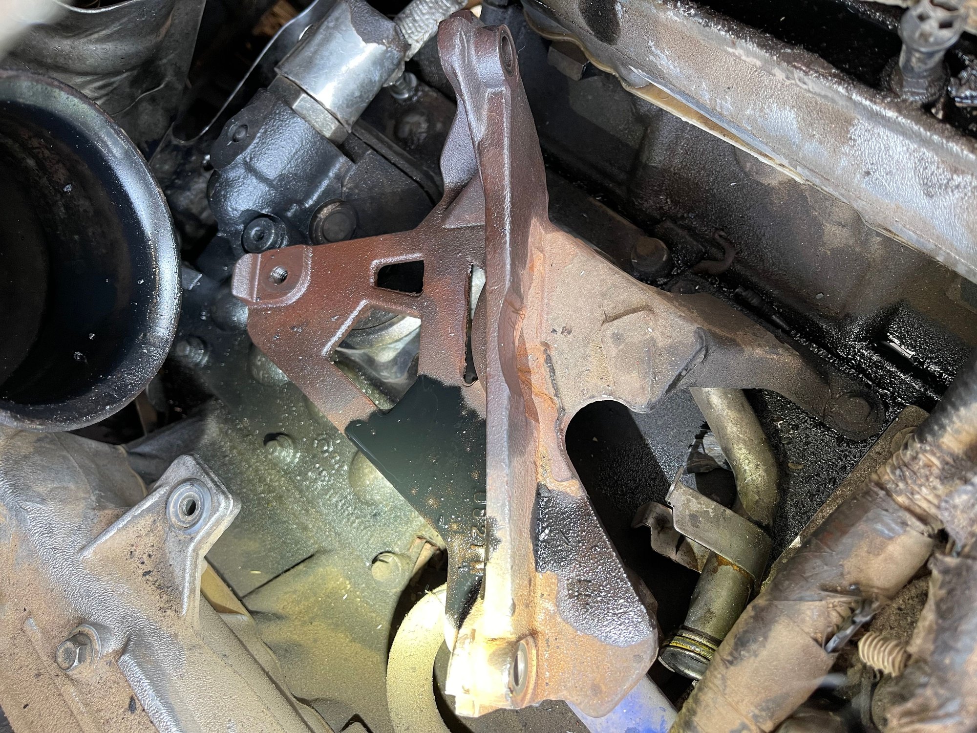

Here's a couple of pics. The downpipe is a 4 inch and doesn't look like it would have enough room to move back off the turbo and see inside. I did feel under the downpipe clamp and it was wet with oil.

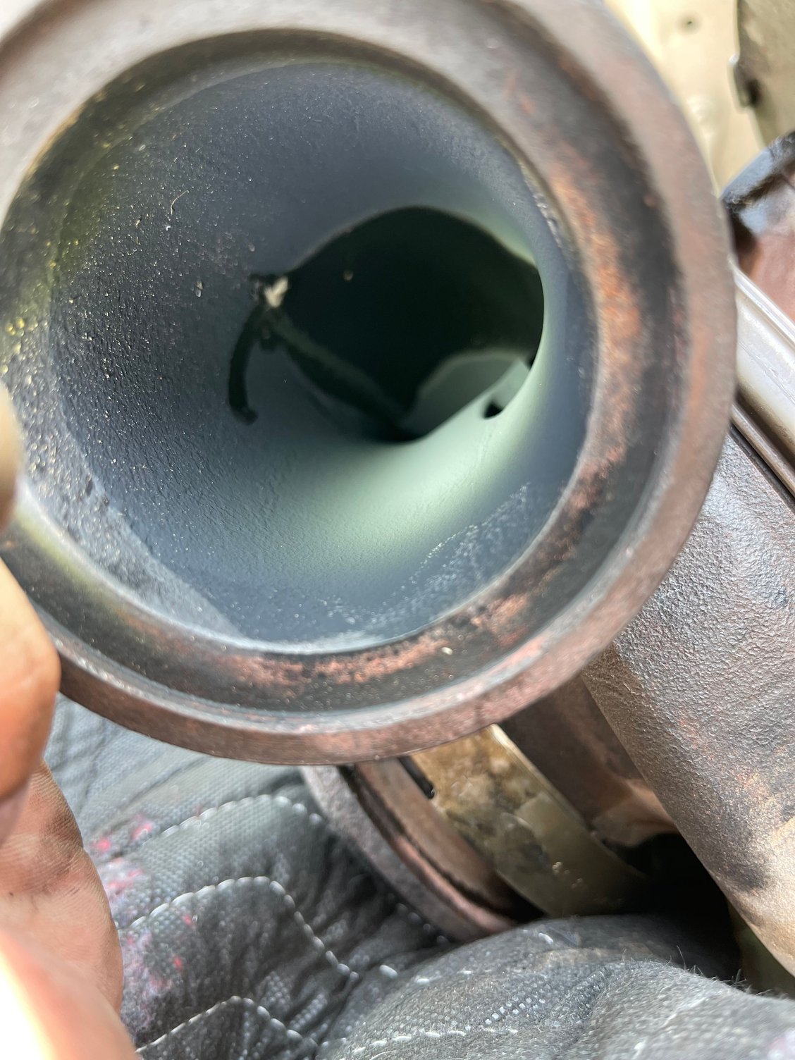

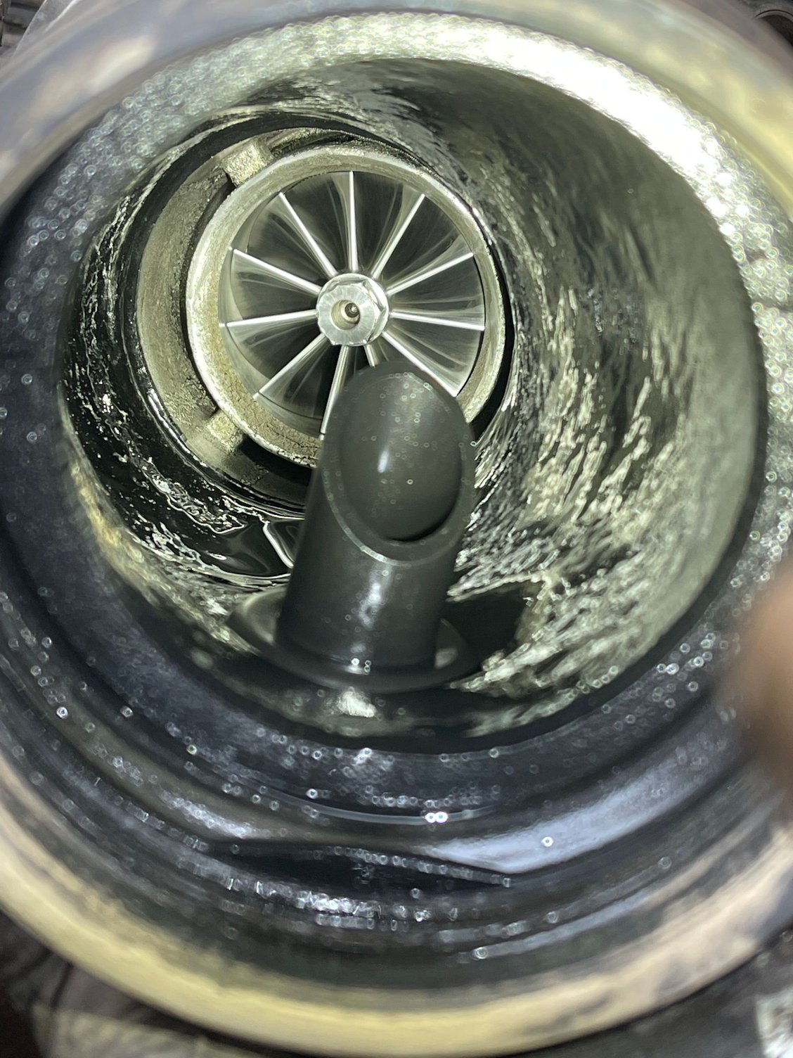

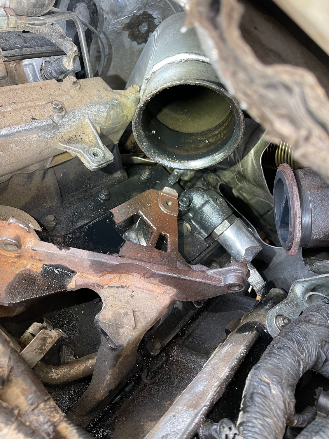

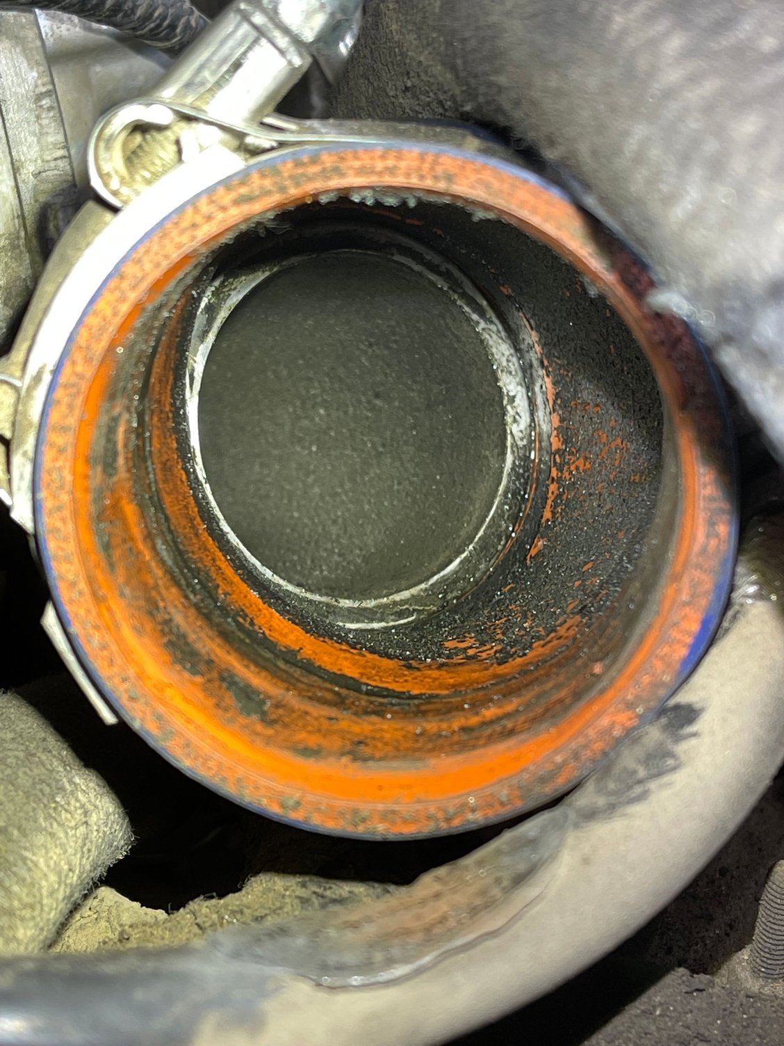

Turbo is out. Up Pipe is dry and down is wet with oil, as well as the driver side of the intake manifold had some oil as seen in the pictures. I spun the turbo wheel by hand and it felt like there was a dry rubbing feeling, not quite grinding but it didnt feel right. There wasn't really much play in the shaft . Based on what you all have told me it sounds like the turbo. Is it worth having someone rebuild it or is it time for a new one? Any other things it might be before i drop money towards a turbo?
you can see oil on intake
Up pipe side on turbo
you can see oil inside the turbo

Looks kind of dry to me.
Now, your turbo inlet, that seems to have a lot of oil.

Thinking about it, there shouldn't have been any oil on that driver side intake if the oil was just leaking out of the turbo. Maybe that dripped out of the PCV where it connects to the air intake tube? Could lots of oil come through the pcv and pass through the turbo? If yes, which pipe/s from turbo would have had oil pass through them? What could cause that to happen?
