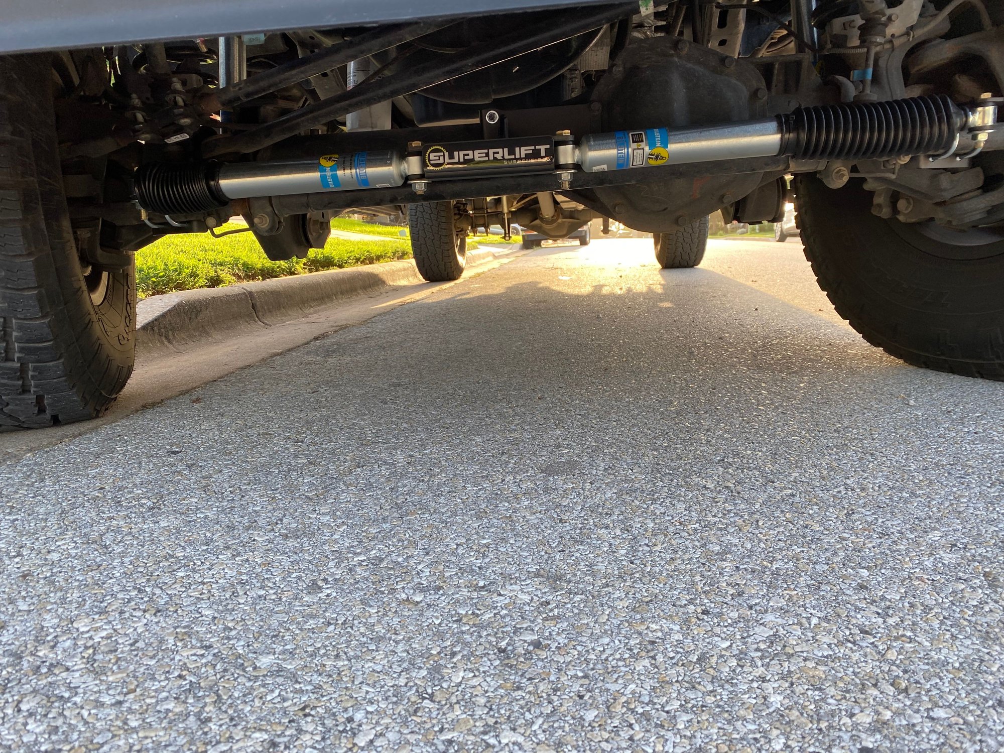

F350KingSRW's Avatar
F350KingSRW
Trailering
Joined: Jul 2021
Posts: 16
Originally Posted by BartGraham
Has anyone replaced their stock steering stabilizer with the Blisten 5100 on a 2020+? I am running a level kit with 37's and it doesn't feel solid and steady as it did on the factory tires. Just wondering in the Blisten upgrade is worth it or if will feel just like the stock one.
Slight improvement. Worth the cost. Took just under an hr to install. On a 4” superlift.
