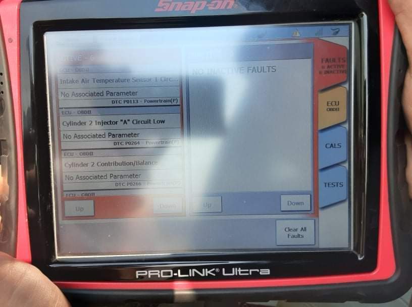

Hello all. I'm new to the site, and the 6.0, but not wrenching or older Diesel. Just got this truck. No cel. Upon test drive I found a vibration on the highway when the cruise was enabled. Got the truck for a great deal so I figured worth dealing with it. Now after driving it for a day it has become much more evident at low throttle cruise situations, especially around 55. I ran a scan and got codes p0264 for #2 injector "a" low circuit, and p0266 # 2 contribution/balance. Along with 3 bad glow plug codes. Truck starts smooth, idles smooth, pulls like somethings chasing it, and runs down the highway at 70 like a caddy with my foot on the peddle. Truck has new ujoints in the driveshafts, front steering is all rebuilt, very well serviced, fluids all changed. I did notice the passenger dust cover was loose, but I don't think that is the issue. Any ideas would be appreciated. Truck is a 05 4x4 ccsb. Studded, egr delete, blue spring, 4" turbo back,sct tuner, and 116k miles

Do you notice a difference between 2WD and 4HI? That "hanger" seal won't cause your problem and is very common on these front axles. The glow plug codes should only be an issue on cold starts. But, get them replaced anyway. The cylinder 2 codes could be the issue. Need to dig into those more and find out what's wrong. B.

Has your air filter been changed recently? Is it the OEM filter? Do you have a MAF sensor? If you do have one, have you unplugged the MAF sensor with the engine running recently?
Have you looked at the wiring to #2 injector and the IAT1 sensor? Inspected the connectors (at both ends of injector #2 and IAT1)? Ohm test injector coils and harness wires (both #2 injector and the IAT1 sensor)?
You have electrical codes, so I would recommend some electrical troubleshooting. We can help with wire colors and connector pin numbers if you choose to go down that path, and it is possible that that is one of your main issues.
