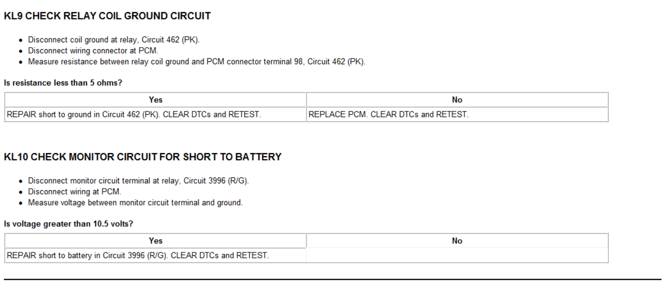

Regarding DTC P0232...

Thanks Sous for the above post, I will begin in these places. Do you think this could cause the truck to run weird at higher rpm? I do not notice any abnormal engine noise at idle.
Couple Questions:
What is KOEO? Key on engine off?
Where do I find the location of circuits and relays listed in the second post to test voltage and resistance across the terminals?
Thanks,

KOEO = Key On Engine Off
Regarding the "location of the circuits and relays listed in the second post", you will have to forgive my lengthy responses as I am still learning how to use the service manual. If you could give me specific procedure steps you are asking about and I will press on from there.
For example, let me know "KL9" or which one you are asking about and I will see what I can find.
