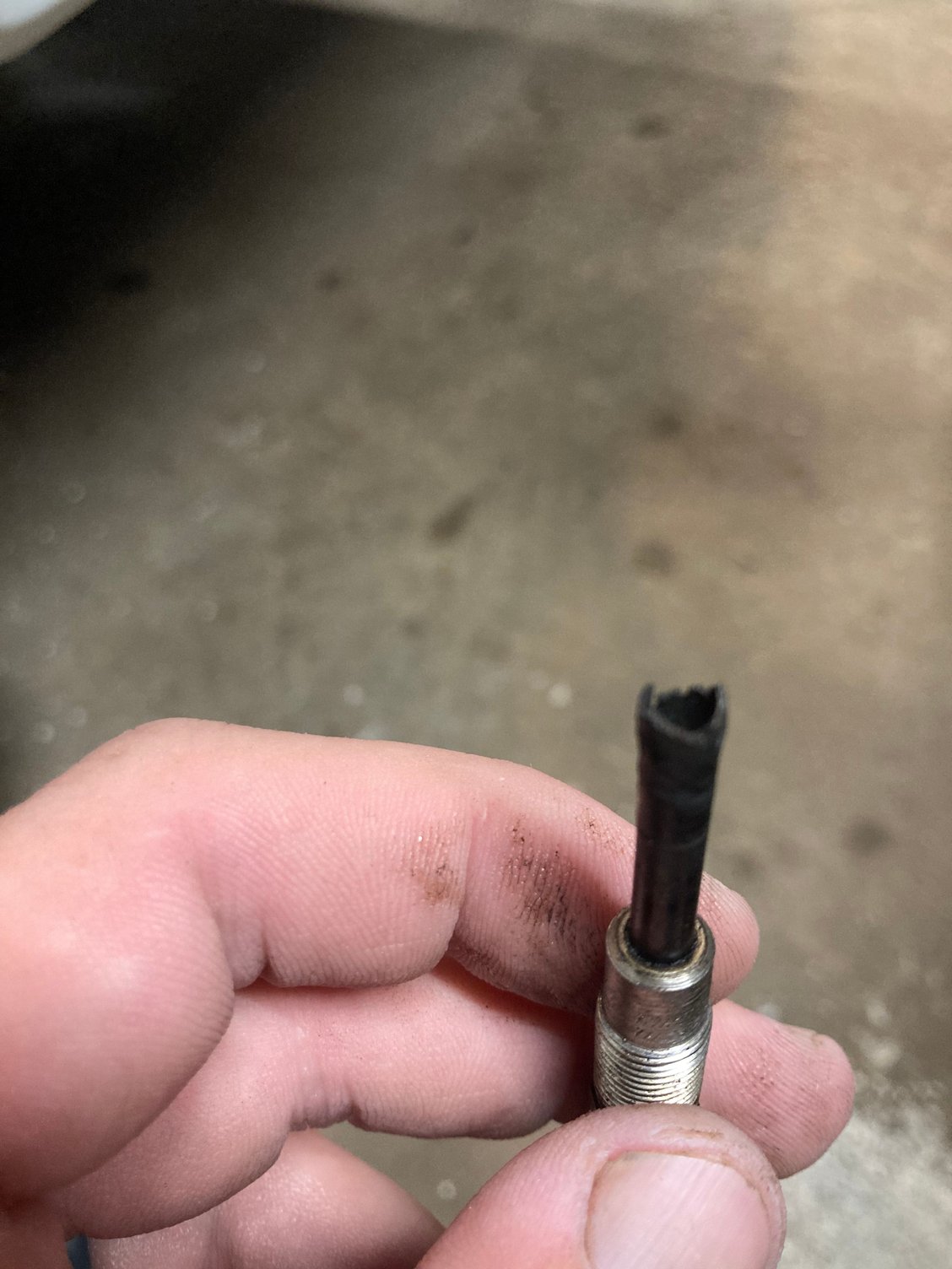

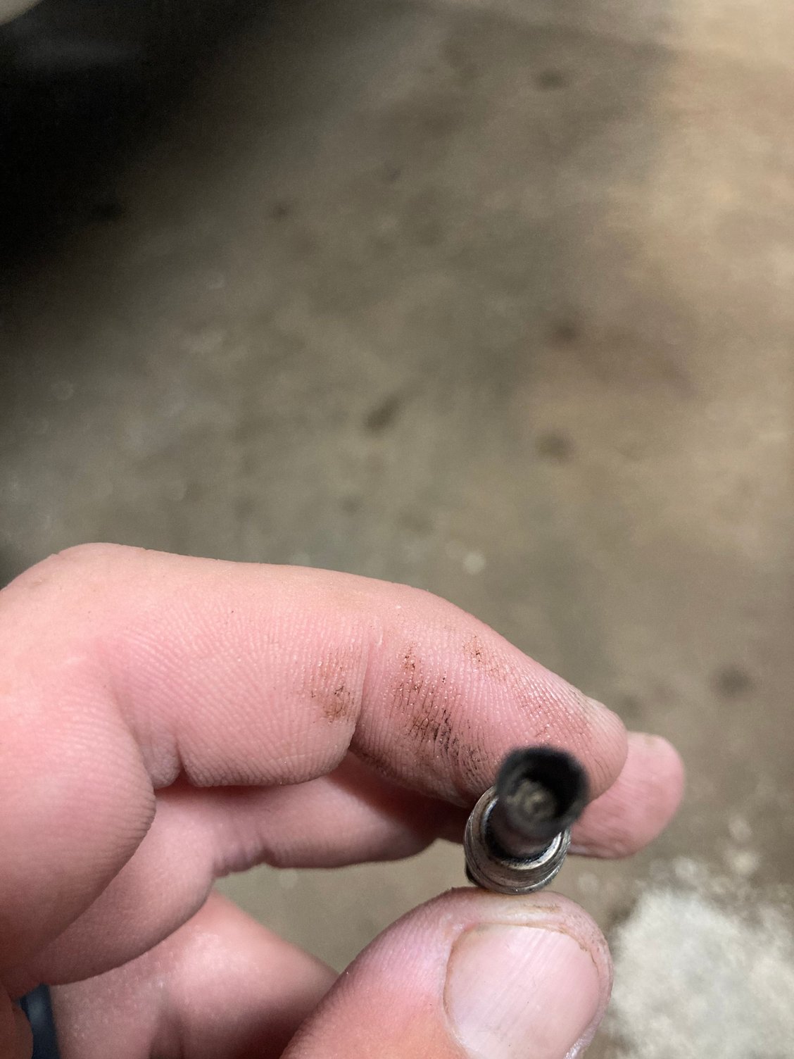

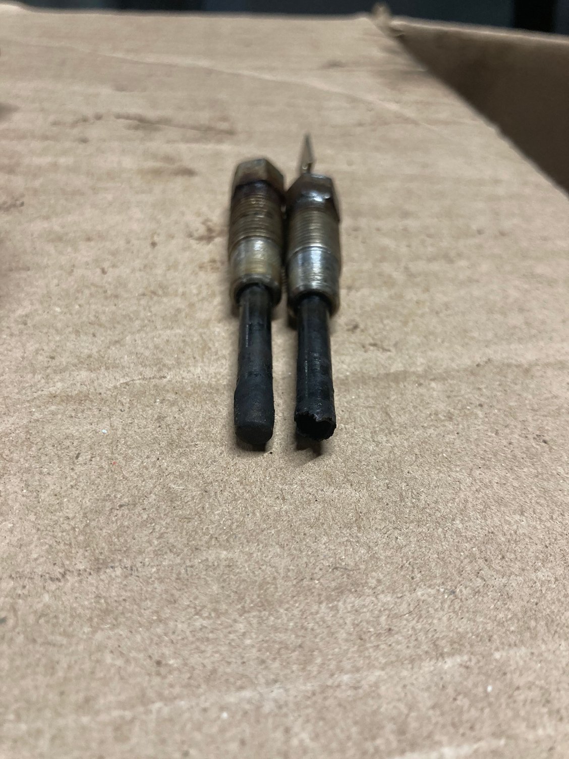

So I was replacing the glow plugs in my 86 Idi and I discovered the previous owner used champion. A couple came out okay and a couple fought me coming out. The last on to come out was missing the very end. It looks like to me it’s been broken off for some time. What do you think is she safe to run? The plug in question didn’t come out as easy as some but I wasn’t ripping on them to pull them out. I used liberal amounts of penetration oil and just worked them out nice and slow. I didn’t hear any cracks that would indicate that I snapped the tip off.

if it was not making noises, run it. that was probable spit through the engine a long time ago.
