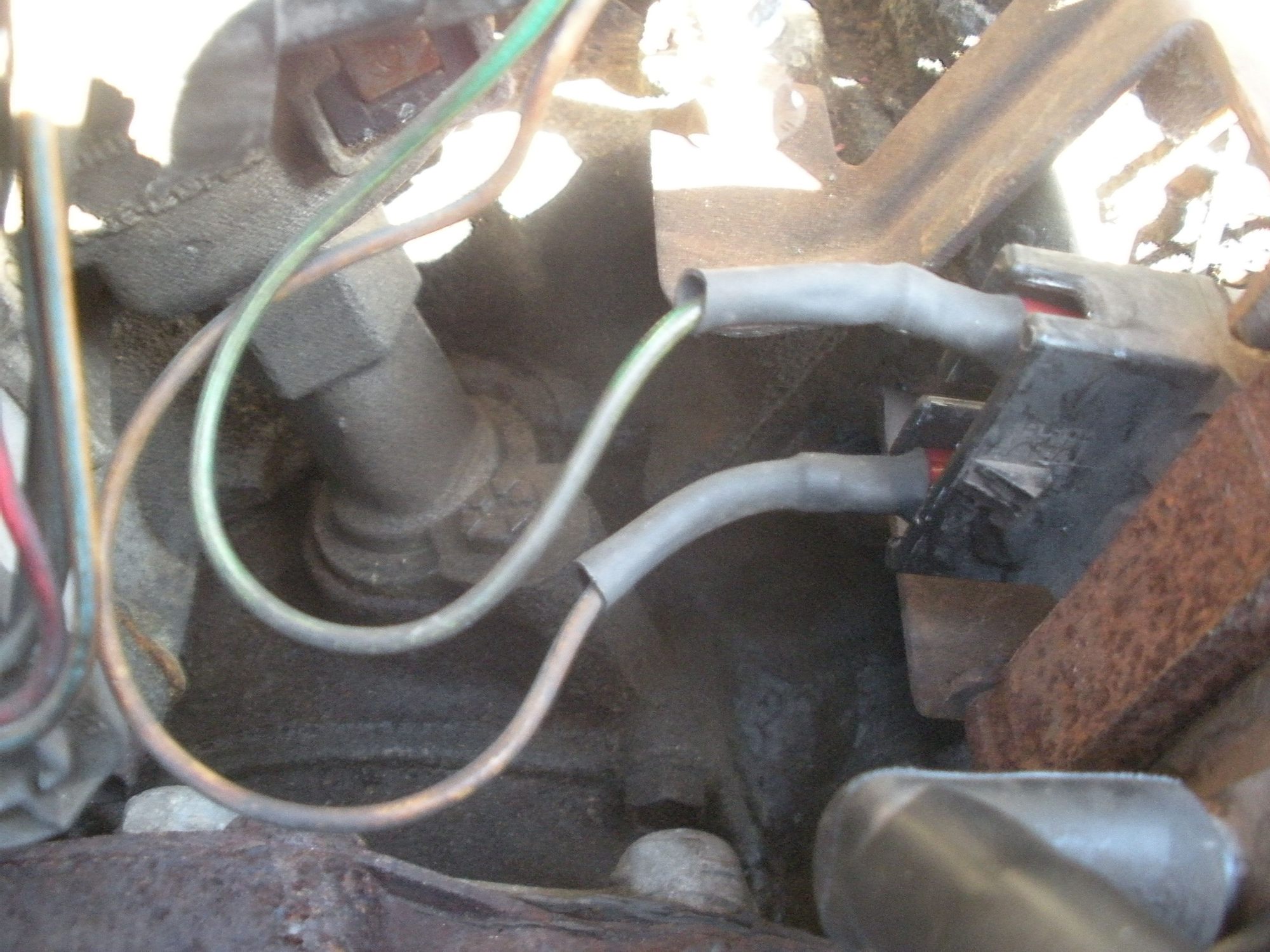

This is what it should look like.
I'll also warn you, you might want to check the terminals on the coil connector. I chased intermittent issues until I replaced the corroded terminals last year.
