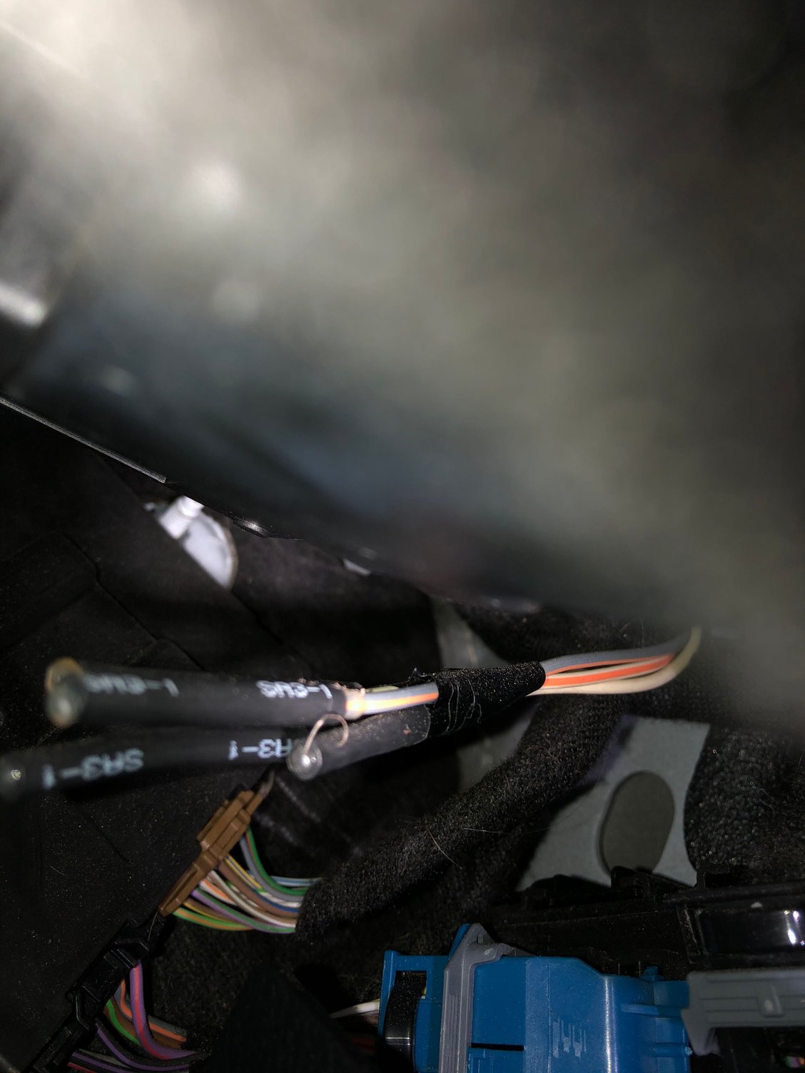

2017 f350 xlt 6.2. Anyone know what these 4 capped off wires may be? They are on the passenger side by the fuse panel. I don’t have upfitter switches.

Search for "Pass Through Wires ".
Bingo!

Pass through wires?

Originally Posted by apstang50
Pass through wires?
4 wires pre ran to other side of firewall. They are there to hook up accessories. Short but useful vs drilling a hole in the firewall or poking a hole in a rubber grommet.

So I can find the other end of these wires capped off in the engine bay on the pass side?
Yup
You will find a similar bundle to your picture directly behind the fuse block on passenger side next to firewall. Reach down to the right side of the box and you should feel the wires. They are short and some people like to pull the wheel well liner to get to them, but isn’t necessary.
