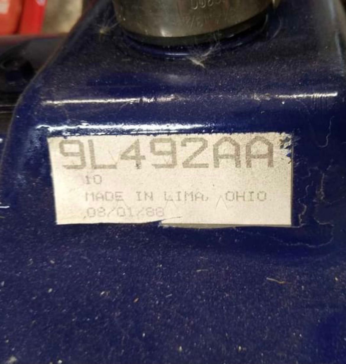

The 460 in my 89 (mfg date 8/89) is coming up on 200k, and I’m having oil pressure issues. I am getting ready to do a rebuild or swap.
I found a great lead on a low mile 460 out of wrecked motorhome. The date stamp is 8/88.
Does anyone know if there are any differences I should be prepared for or would this be a simple drop in?

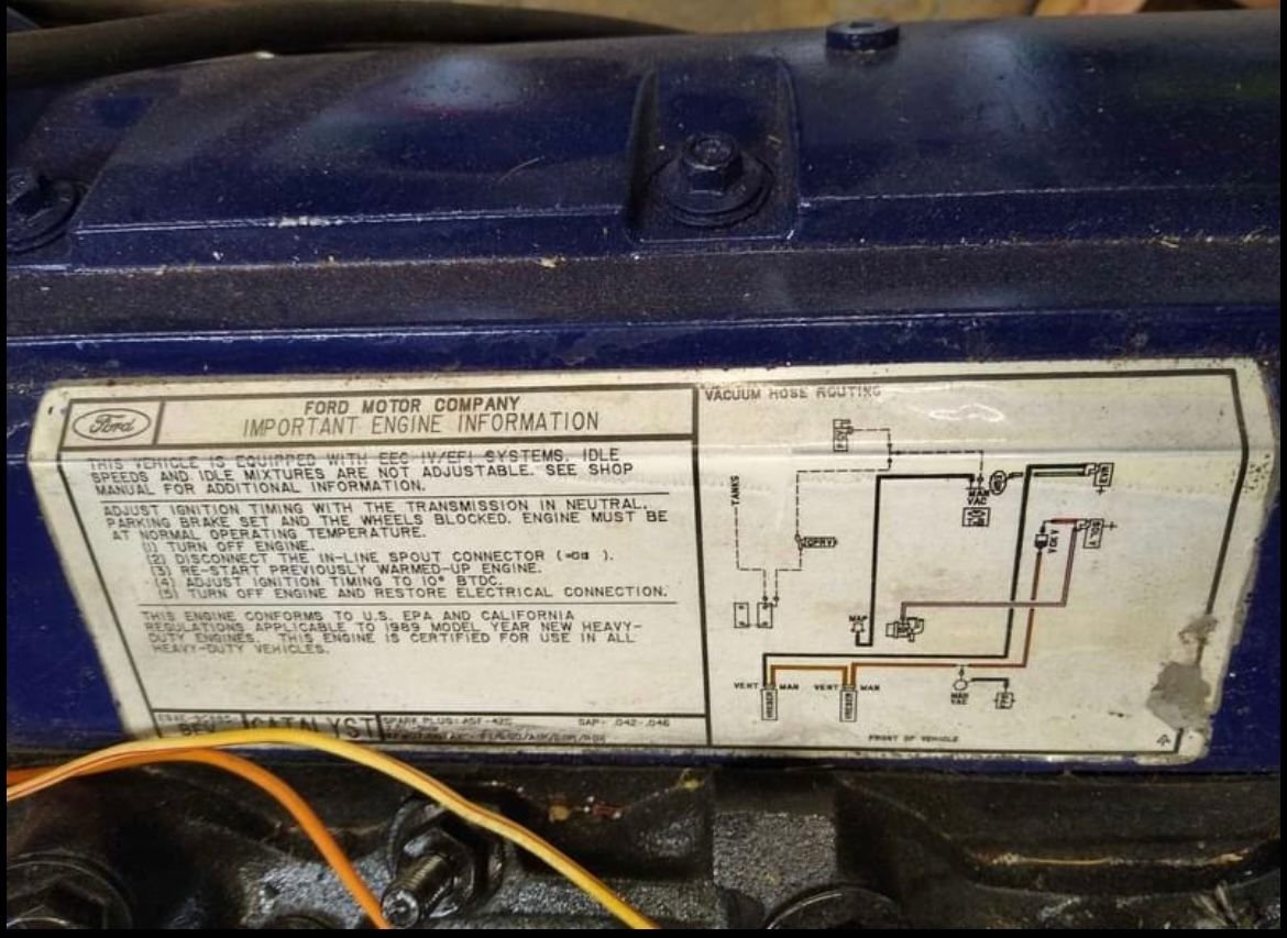

Thanks — yes it’s an efi. Here are the 88s tags on the motorhome engine.

That date 'sticker' means nothing to the blocks date stamp.
I believe that date sticker is when the whole engine was put together, including the installation of the sticker on the valve cover, possibly even when the engine was put into the frame.

And... be aware, E7TE heads are EFI, and E8TE heads are last year of carbureted motor home heads...FYI.
