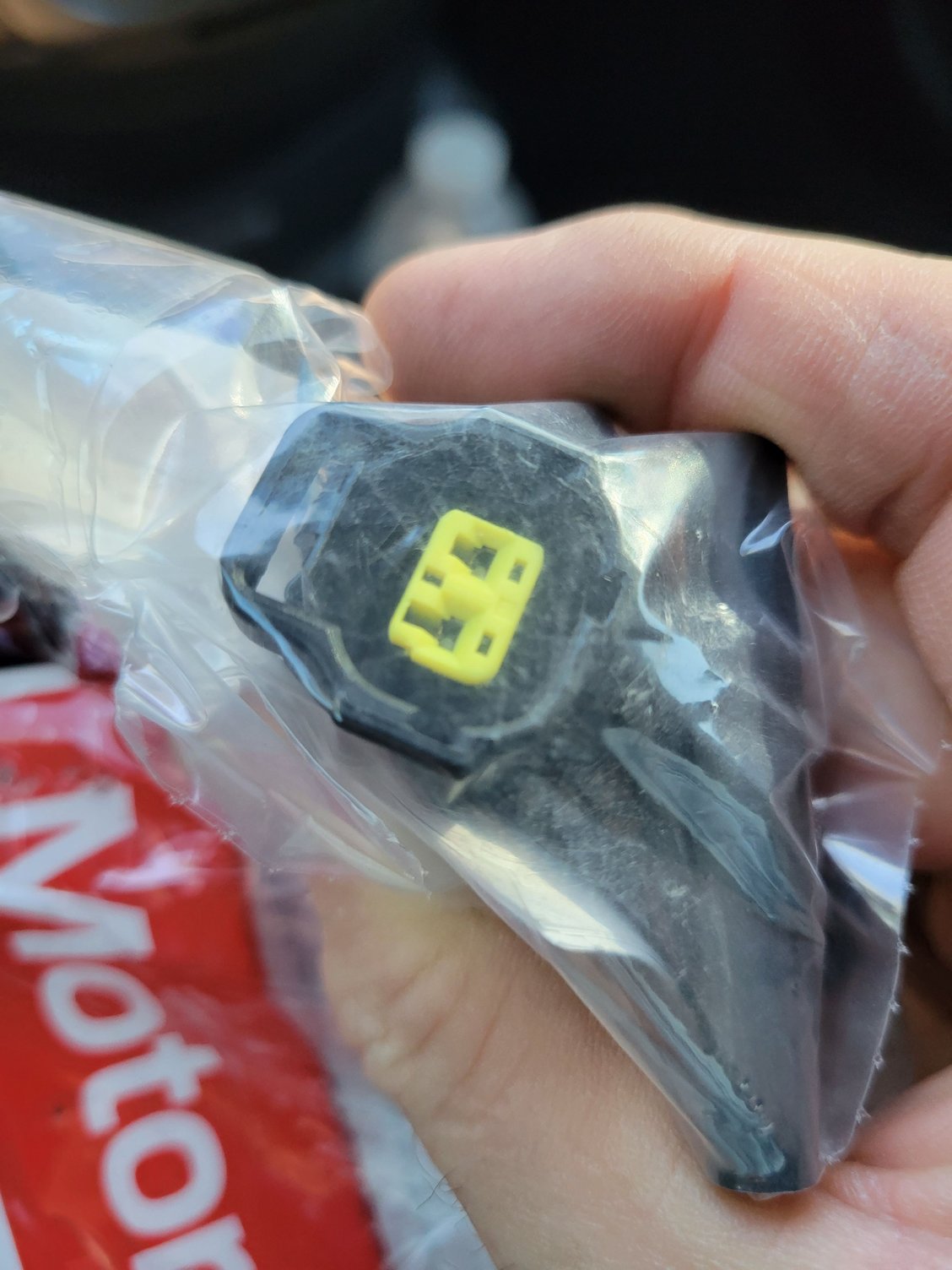

Not a no response, out camping right now so delayed response. Anyways, bite the bullet and ordered the pigtail from the local ford dealer. I'll have it either this afternoon or tomorrow. I'll post what number it is when I get it.

I'll certainly be interested in what pigtail (and part #) you get since feedback in this thread (and others from the past) indicates that the correct EOT pigtail (note, we do know WPT-1325 is available from Ford) is not available from Ford.
That is the whole reason for posting the Alliant Power pigtail information....

Well I'm back from the dealer and this is what I got.
