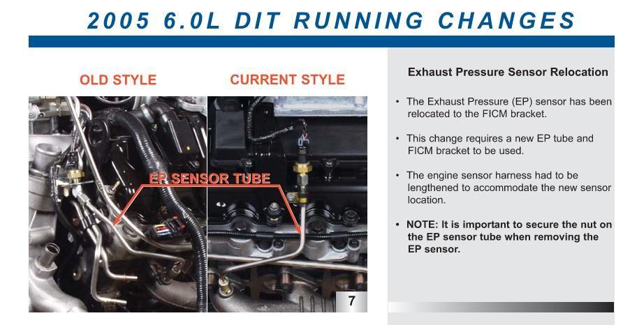

Found the answer on the wire routing from one of the 6.0 Bible for the 2005 changes. The stock wiring takes the shorter path possible to the sensor.
Mine does a full 360-deg wrap-around the sensor before connecting. And it shoved under the Degas tank "wye" connector. :shakes head:

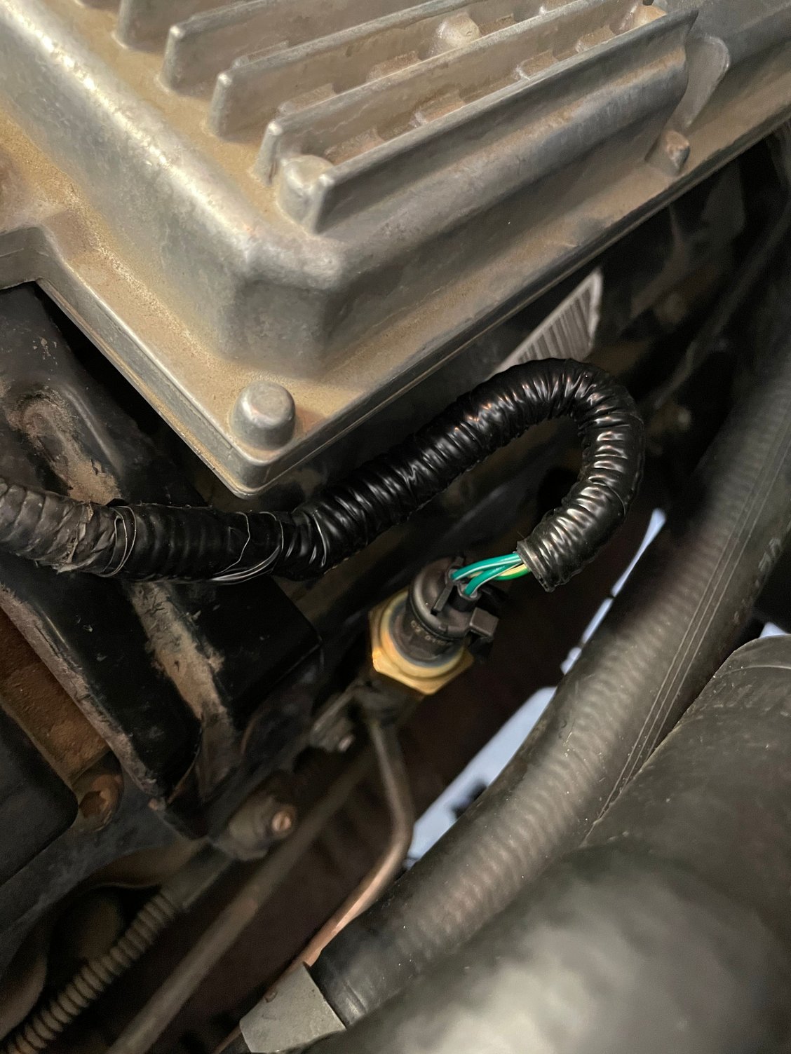

Just to close this out, improving the routing of the wiring seemed to fix the EBP readings however the pigtail was still way too long so I decided to replace it anyways. Accurate diesel had a $10 piece I decided I would try. Fits a little tighter than I’d like onto the ebp but at least I know it’s sealed up well. Wire colors didn’t match either but I was able to just match location from the old to the new.
https://www.accuratediesel.com/6-0l-/-7-3l-powerstoke-ebp-exhaust-backpressure-sensor-pigtail-connector.html
I left some slack in the wiring. Made the splice right after the mounting post below the FICM.
