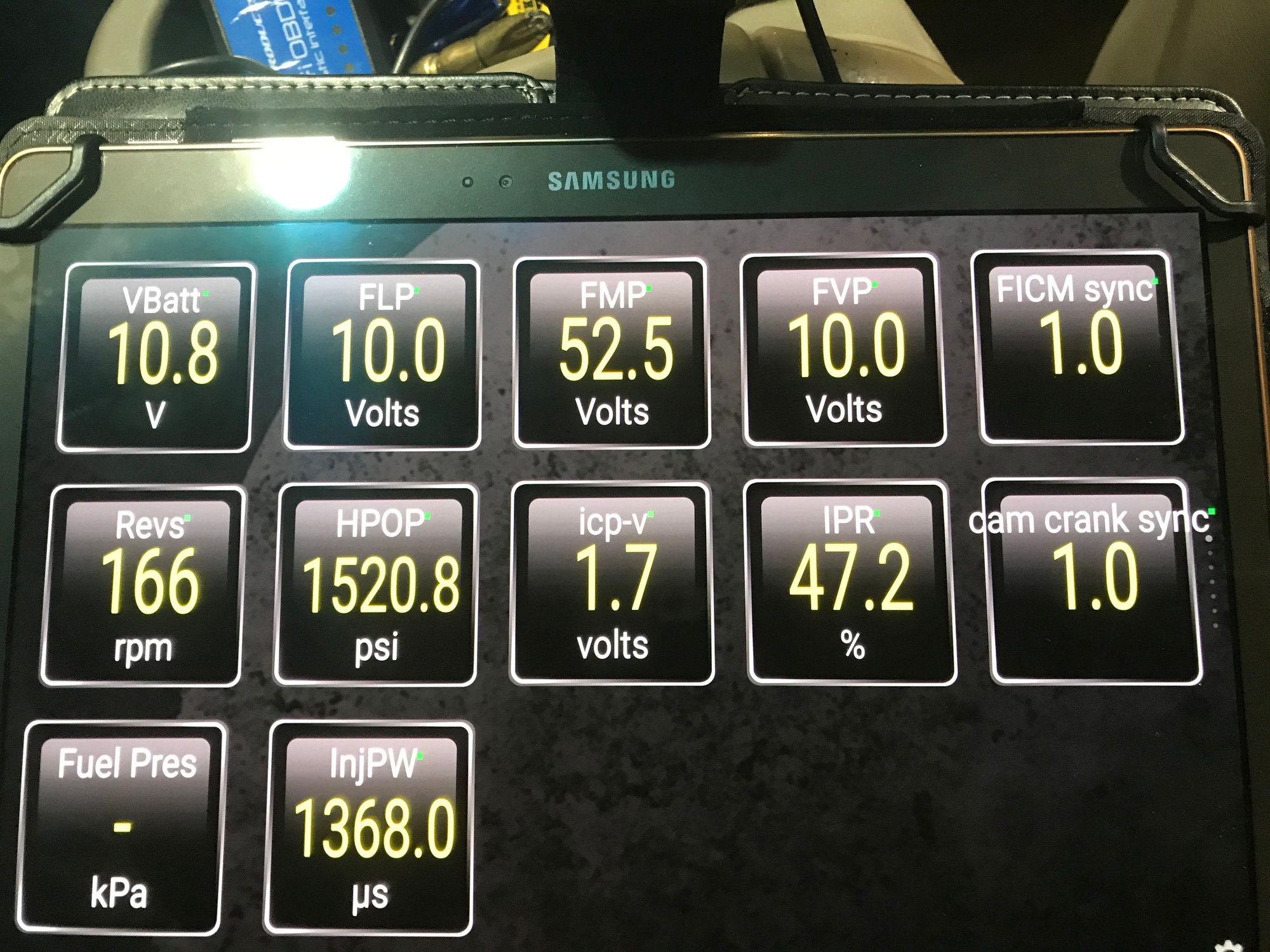

Hopefully the picture will go thru this time - my attamp from the other -
Any help would be great - sounds like it wants to start & I don't know why the starter relay is showing what it does
