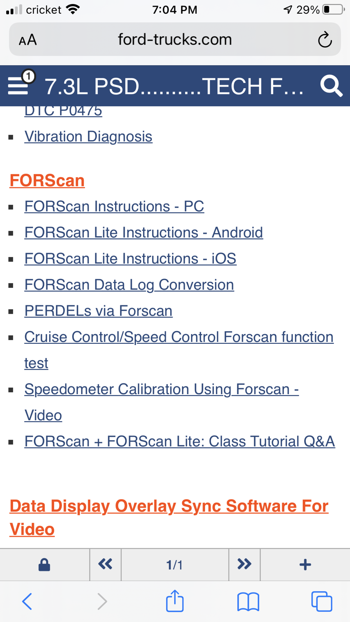

FORScan is the go-to app for folks on FTE. It can do about anything as far as they say. I haven’t used it myself yet.
It has its own section in the tech folder (sticky at top of forum). https://www.ford-trucks.com/forums/1...-7-3l-psd.html

So I bought the FORScan app and connector is that app able to run diagnostic tests and operating tests (shows a bunch of different stuff but blank until plugged in?), will I be able to see shift data, or is it plain Jane scan tool
Yes, it can run diagnostic tests and show shift data.
