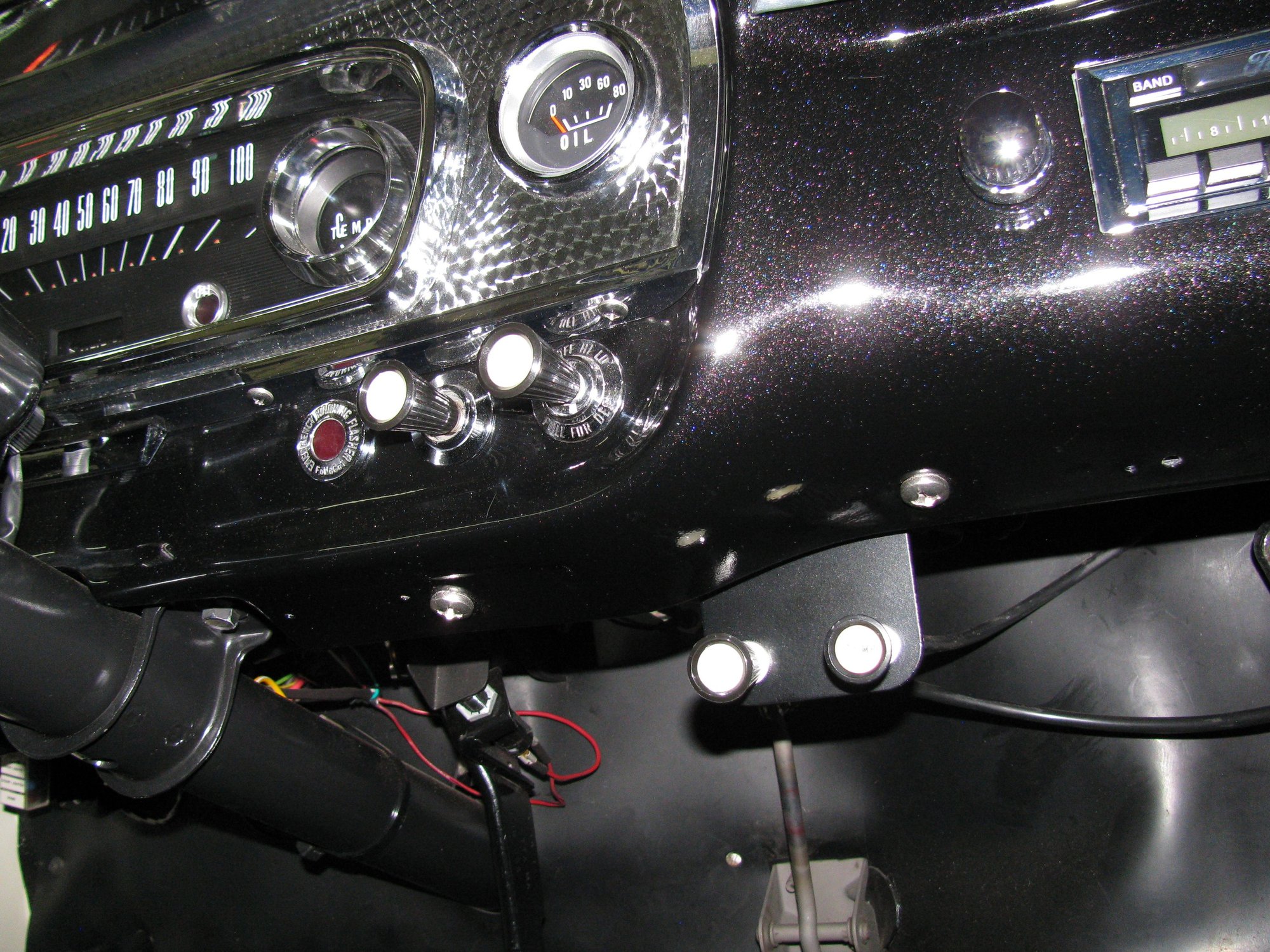

I've read that the deluxe heater has a set of controls below the dashboard to the right of the colomn. Can anyone post a photo of this for me please, I'd like to be able to turn the tap on from inside the cab .thanks

Under the dash the one on the right controls the heat valve. The one on the left goes to the fresh air on the heater box. The one above them is a combination switch and bowden cable that controls the 2 speed fan and the defroster valve. The cable for the heat valve goes thru a punched hole above the heat box.

Thanks for the photo I'll probably make this control .I bought a new heater box from broncograveyard, I had to swap out the 2 flaps because the controls were on the wrong side .other than that the box is identical to my original one.my original one had all the flaps in it but had no control for vent or tap
