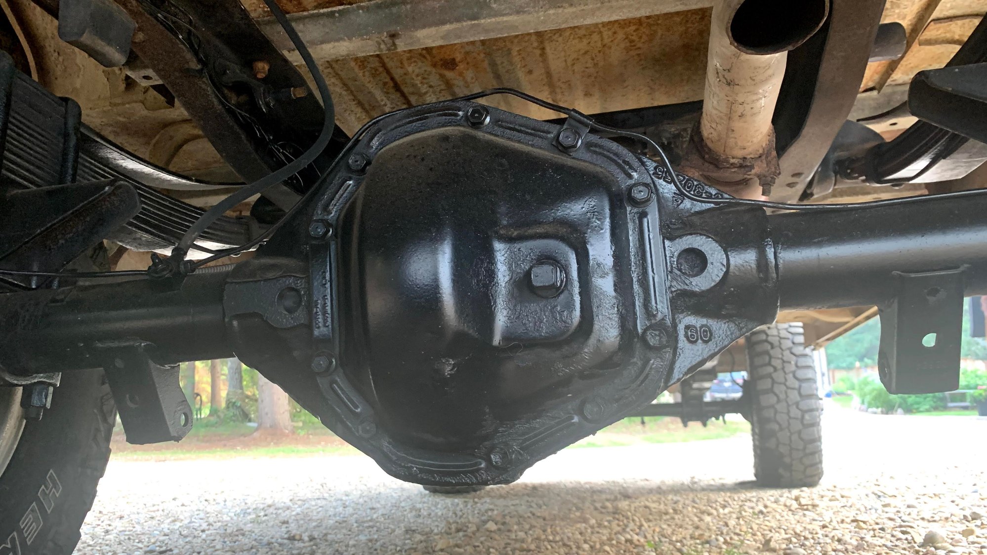

Just purchased the 72 F-250 and one of the first projects is to upgrade to disk brakes. I have been looking at the Rear disk brake conversion kits for my rear DANA 60 (4:10) but would also like to do front.

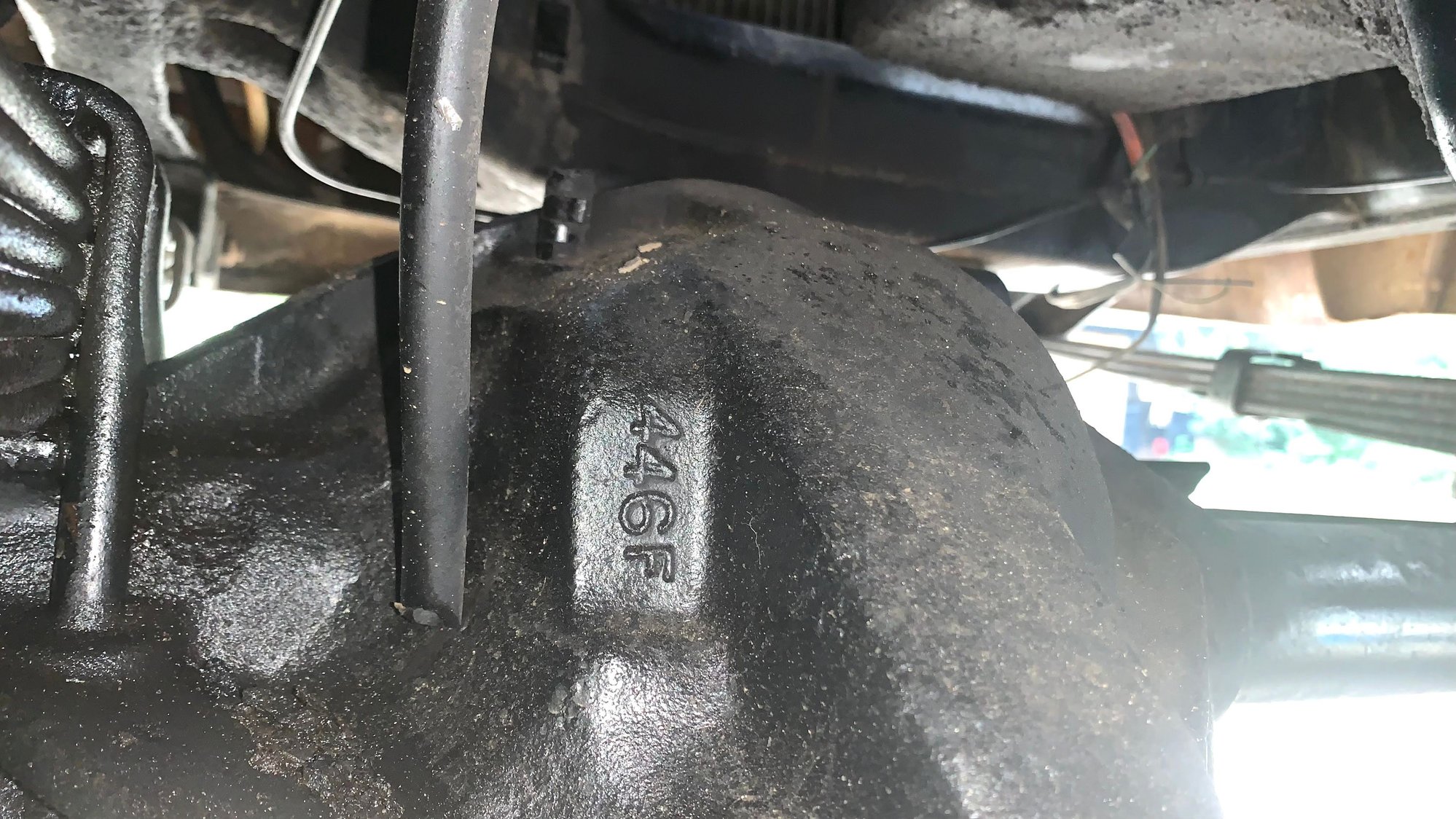

Front diff is currently DANA 446F with closed knuckle steering.
I have it in my head the easiest for the front end is to upgrade the entire differential and have an open knuckle type steering...Can anyone let me know the best fit year Axle so I can begin my search. Preferably looking for diff that will drop in without huge modifications.
Thoughts on replacing the rear diff? Or just go with the brake upgrade kit?
446F Friont Diff
Closed Knuckle Steering
DANA 60 4:10 Rear Diff

Any front diff will bolt in up to 1979. Mid 70s is when front disk appeared.
You may want the rear axle as well because it will have a greater spline count on the axles.
If you do rear disk will you run the Cadillac calipers for e-brake? Go without an e-brake?

I feel the high pinion 78 or 79 dana 44 axle is your bolt in option. That is what I got for mine. Plan on doing an entire refresh on the axle. New bearings, rotors, calipers, seals, hubs and possible carrier seals too. These parts are all past there prime at this point. The other option is a front and rear out of a newer ford f250 or f350 with leaf springs. I did see a guy that swapped in super duty axles from a 2003 I believe. Just some options to look at.

78-79 Dana 44 or into the 80s Dana 60.
The only issue is they are High Pinion. If you keep your stock transfer case you will need to fix the pinion angle if you want to drive fast in 4H.
I put a 1979 D44 High Pinion in my 67. Direct drop in. I am fixing the pinion angle problem with modern drive line...
F-250s up to 1997 had a Twin Traction Beam Dana 50. Not drop in. F-350s up to 1997 had straight Dana 60. Spring perches would be off a bit, but can redo.
Super Duty (beginning in 1999, no 250/350 in 1998) can swap in with hangar relocation. One thing to keep in mind is the Super Duty axles have a metric bolt pattern for wheel. Only an issue if you already have rims you are in love with. Otherwise the metric rims open up a whole world of modern options.
I wouldn't bother with rear disc, unless it came on a Super Duty axle. Front does something like 75% of the stopping anyway... Getting the E brake to work with some of the disc call conversions can be challenging. I need a e brake with manual trans.
