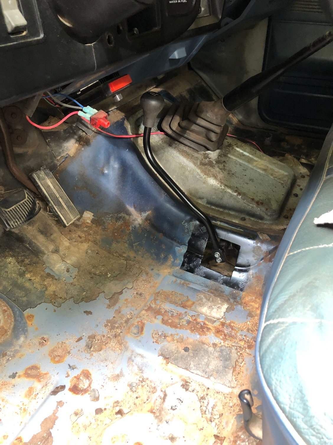

Different transmission. I'm using the ZF-5. Bronco got the M50D.
I just did a M5OD to ZF5 swap in my ‘89. The shifter is in the same location but none of this matters if you aren’t using the transfer case shifter for an ‘87. You still haven’t answer that question.

I cut a hole in my '87 cab for the shifter location seen in post 10. I had two trucks I grabbed a bunch of measurements from, but didnt end up using them in the end. I installed the engine/trans/Tcase and got under the truck with the shifter assembly. I believe I mounted everything except the shift rod itself and eyeballed where the "axis" was. Drilled a hole from underneath as a starting point and went back up into the cab to open up a square like the one seen in post 10. I found that it doesn't need to be that large in size. I opened up a square using a body saw, then test fit the shift rod. I shifted the tcase into all positions and trimmed the floor as necessary.
This is the shifter that I have - https://www.ebay.com/itm/37468119214...Bk9SR47ikomAYg
Old May 9, 2023 | 09:27 AM
My4Fordtrucks's Avatar
My4Fordtrucks
Joined: Jun 2015
Posts: 12,831
Likes: 2,436
That is the shifter I have in my ‘89. The hole is on the side of the trans tunnel shown in your picture from post #10.

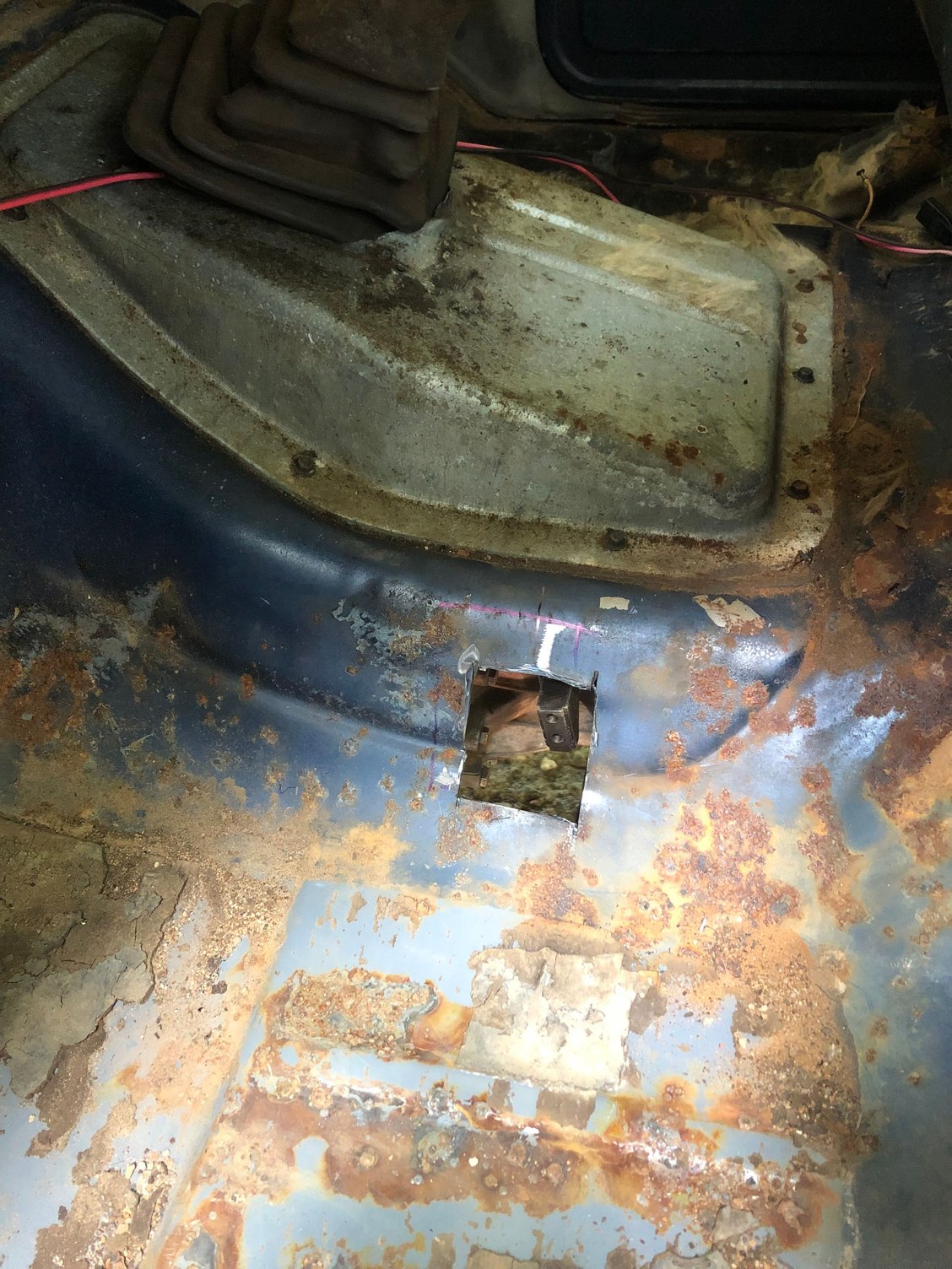

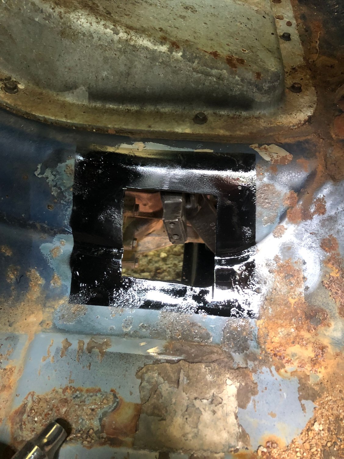

Got it done today.
Started by drilling a hole from underneath to mark the center of the hole that needed to be cut. Cut a smallish hole with a cutoff wheel - maybe 2" x 2"? Then got the shifter mounted and figured out where it needed to be enlarged. Then a few more cuts with the death wheel (hole is now 3" x 3"), followed by a quick wire wheel, flap disk, and some paint. I have a shifter boot on the way; hope to install this weekend.
