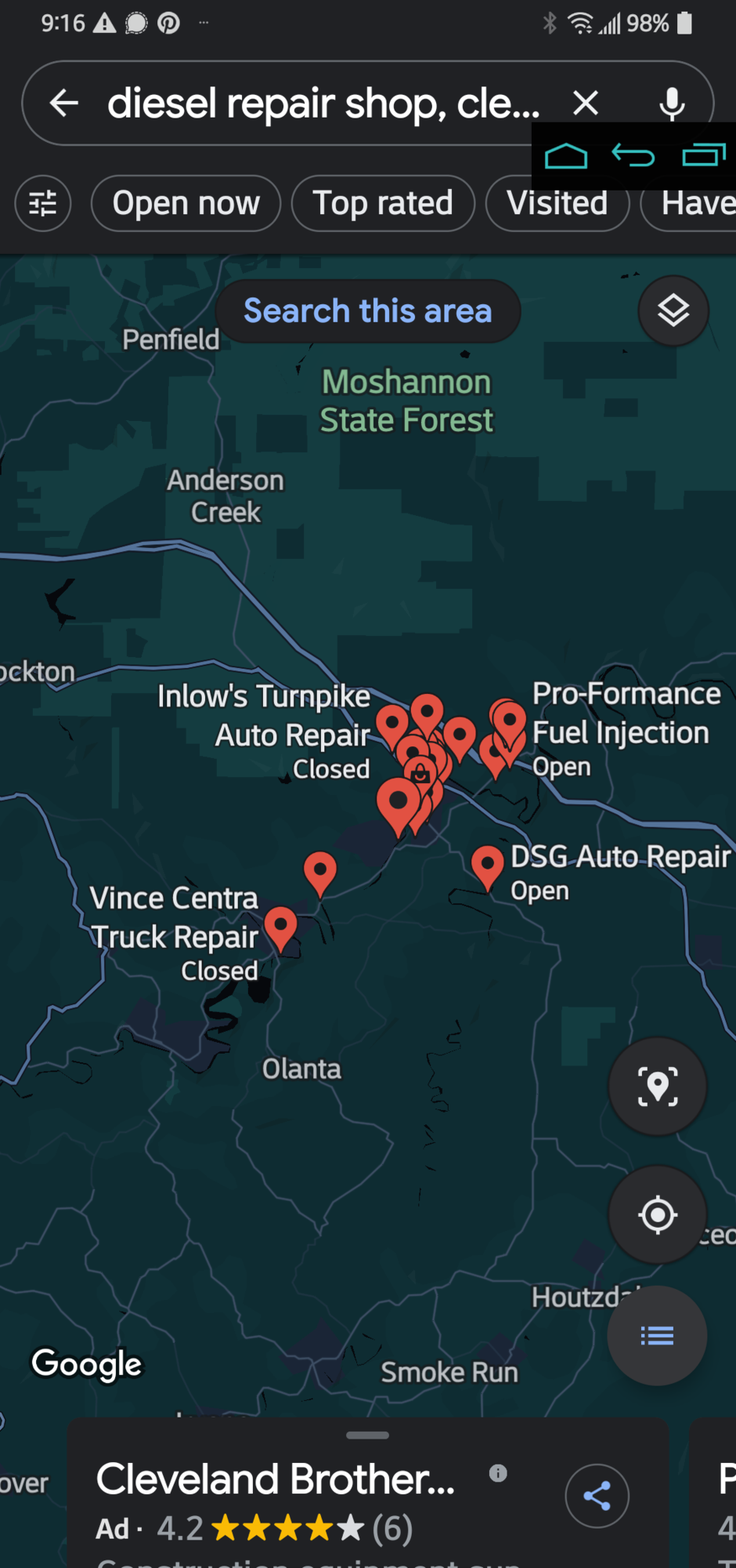

Here's a Bing search for you Stan.
https://www.bing.com/search?q=Diesel+repair+shops+in+pa&form=QBLH&sp=-1&pq=diesel+repair+shops+in+pa&sc=2-25&qs=n&sk=&cvid=D49AD2CF7541A38F78E9A0CFB04751
Do a search on Maps of "Diesel repair shops near Clearfield PA" this comes up:
Good luck buddy.

Yep, Turbo was checked thoroughly by Proformance Fuel Injection. An honest diesel shop recommended to me by an old high school team mate. Turbo is fine. The noise is they believe an exhaust manifold leak. They can't gt it in before I leave so I'll see if I can get it tightened in State College. Thanks for the help, and remember Proformance just off I 80, Clearfield PA
