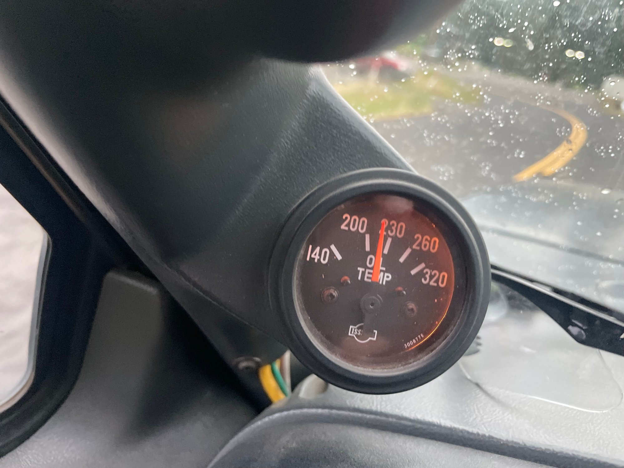

Will this cause low cooler flow on E4OD
Th
I checked the hole run to verify these are the only two kinks in the lines. Not sure if they are on the same side of the cooler circuit or not.
I know what the fitting on e4od is but what is the fittings on the rad? Why not screw in direct
also I do believe these are the 5/16 factory lines but I could be mistaken.

Unless they are kinked so bad they are almost completely crushed I wouldn't consider an issue. They are low pressure lines.
The fittings to adapt to the size of the lines on the radiator are factory.

It's fine. Your truck is a half ton, right? That trans was used up to 1.5-ton (15,000 GVW) applications and holds up alright, I don't see any reason to lose sleep over it.

I ended up bypassing the cooler Tank and putting a finned cooler in front of the condenser and it keeps the temps very nice

Once I replace my radiator and cooler lines to the trans I Plan to put it back together like that. I bypassed my radiator and had to cut back my line a bit (was pinched mostly shut) and flared it a bit so I could go to the one in front of the condenser. As of now the cooler does a good job cooling (had to block it entirely during the winter because it kept it WAY too cool) but i havent tried it on a hot summer day pulling a trailer with AC on and at low speeds. I suspect it may raise in those conditions
