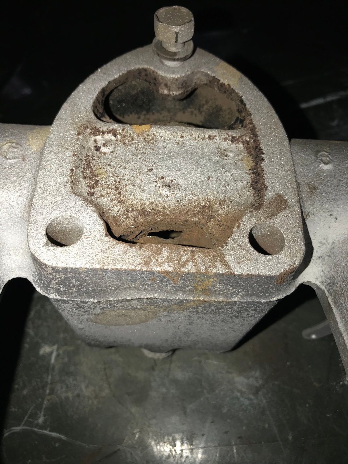

I went out to take a look at how it was done. I noticed on the side that the exhaust riser attaches to (not sand blasted) the smaller port was loaded with rust scale, completely plugged. I of course couldn’t handle seeing that so I dig it all out and found a hole rusted through to the larger port.
I assume the manifold is no hood anymore sand has to be repaired or discarded. I have a second manifold and the metal is good and solid between those 2 areas.
Input please!
Hole between the two chambers looking from bottom.
Looking from top

You are fortunate to have a spare! Finding a replacement is said to be tough. You'll have to handle your spare with special care as exhaust manifolds for our engines are also said to be fragile and subject to breaking (and rusting out) apparently. Good luck!

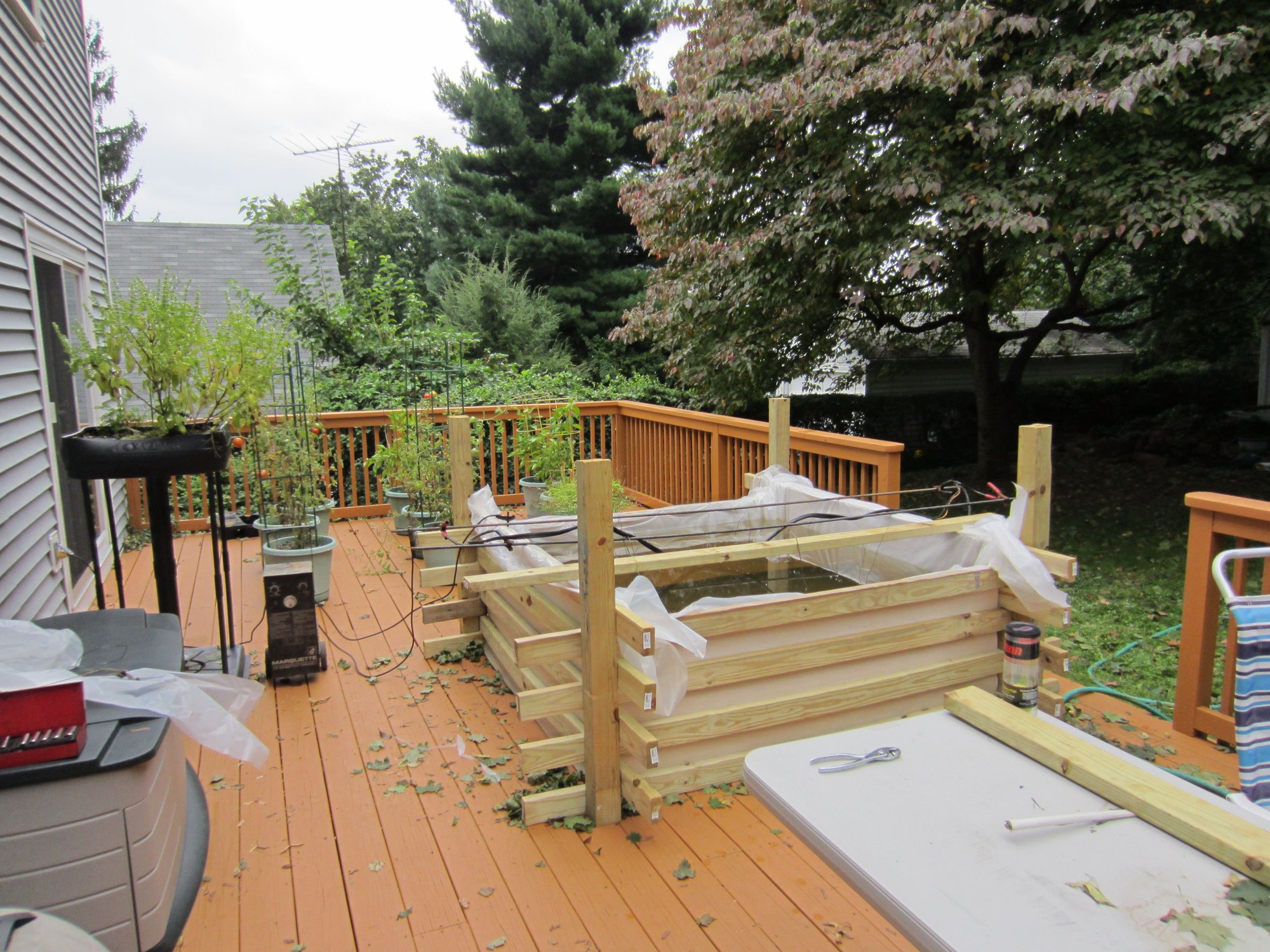

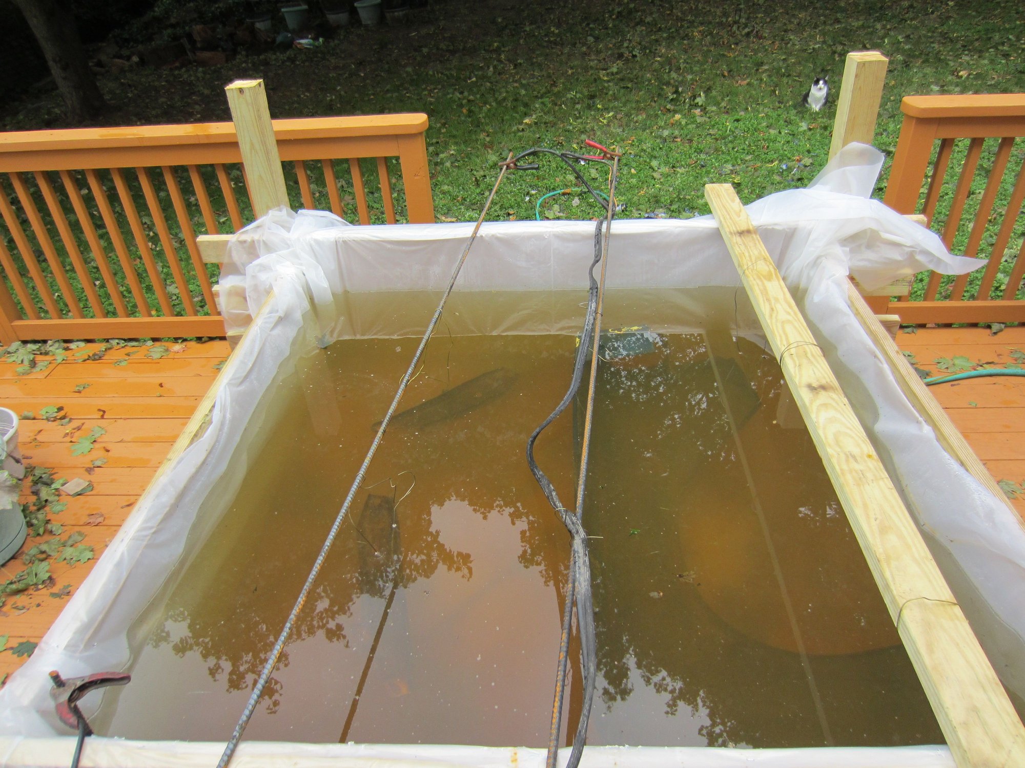

Go with the electrolysis process but it will only remove rust "line of sight"
So anything inside would not be touched.
It can be done in a small plastic tub or a large pool!
I made it large enough to do hoods & fenders, that's a fender and bumper brackets in there, for a car project I have been working on.
When I was done the iron rich water went on the back yard grass with no issues.
Dave ----

Originally Posted by 8pack
That’s a heck of a set up! I think I will look at something a little smaller scale. 😉
Go BIG or go home
My first try as a test was in a 5 gallon bucket with motor brackets. That worked so good I built the pool.
The left over wood I made 2 benches that the backs fold up flat and when pushed together made a picnic table.
Dave. ---'

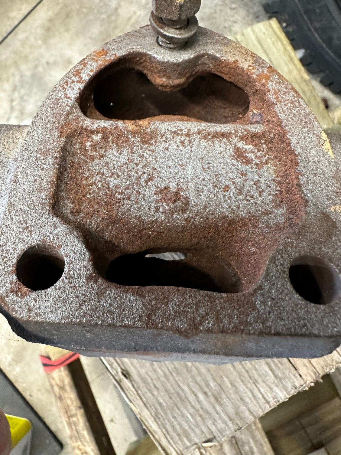

Refreshing this thread. My intake from the '60'is too short and the '55 is the correct height.
That hole is between a dead area (the hole leads to nowhere) in the intake and the main passage.
Does that hole matter? Do exhaust gases pass up into there? What is the point of that dead cavity?
In the center of the picture you can see the hole rusted through between the dead cavity and the main passageway.
In the center of the picture you can see the hole rusted through between the dead cavity and the main passageway. H

If that is just an exhaust manifolds and not a combination intake/exhaust make steel plate for it to seal it. If the intake or something else bolts on top just use a thinner piece of steel.
Old Jun 27, 2025 | 10:27 AM
truckeemtnfords's Avatar
truckeemtnfords
Veteran: Marine Corps
Posts: 3,679
Likes: 370
Or just make a backer and either weld it with a high nickel rod or silicone bronze it closed.

That is the intake which mounts on top of the exhaust manifold. With that hole there exhaust gasses will pass into the intake so in order for it to work it would need to be plugged.
Ibjust got back from the machine shop and he said that at this out I should make my '60 intake and exhaust work since my '55 exhaust manifold has a large crack in it.
I had thought about just filling that cavity with some kind of molten metal. Lead melts at 670 degrees and if the intake is that hot there is a much bigger problem. But since the exhaust is no good I will just set this aside again.
Thanks for the responses!
