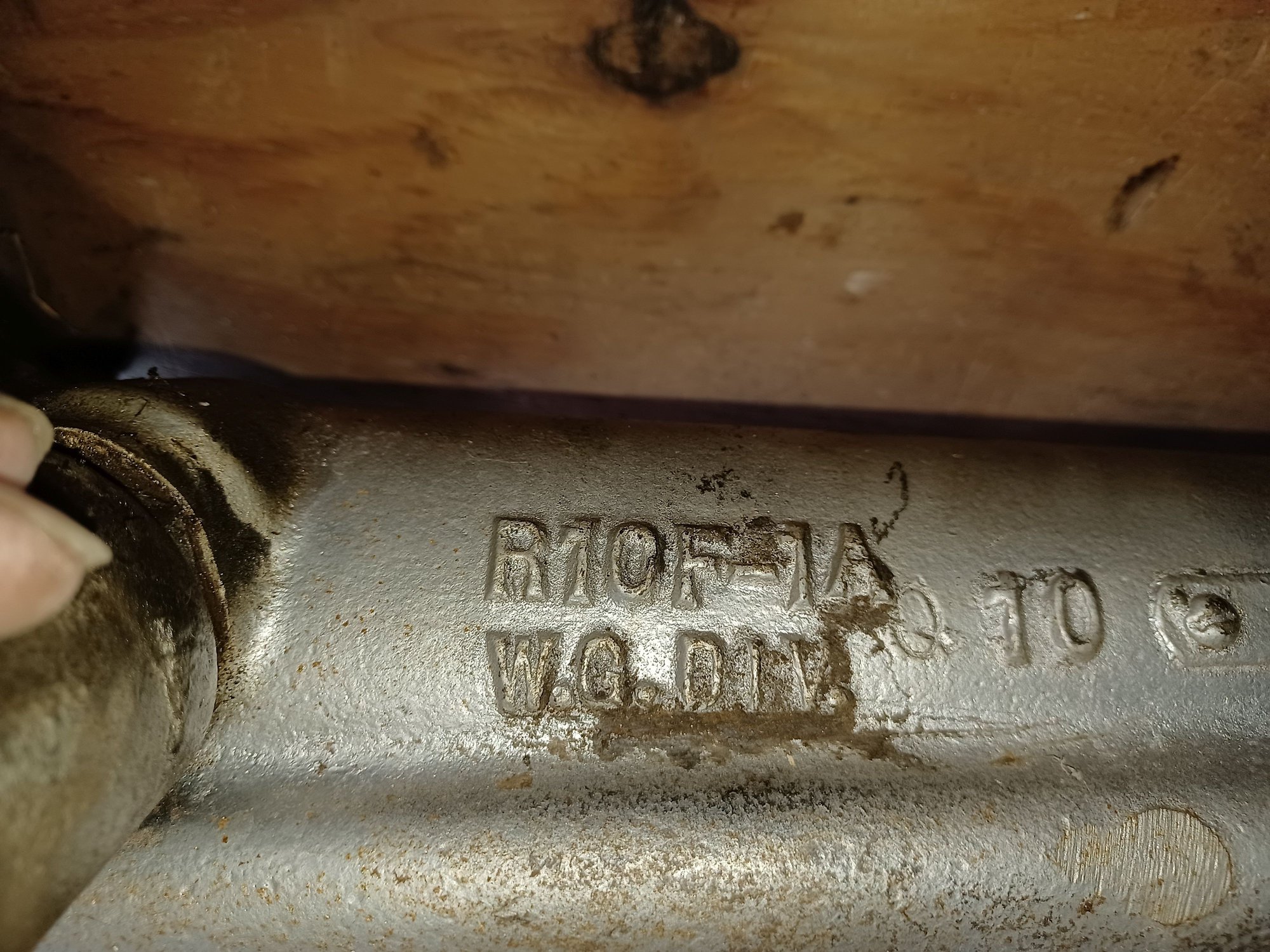

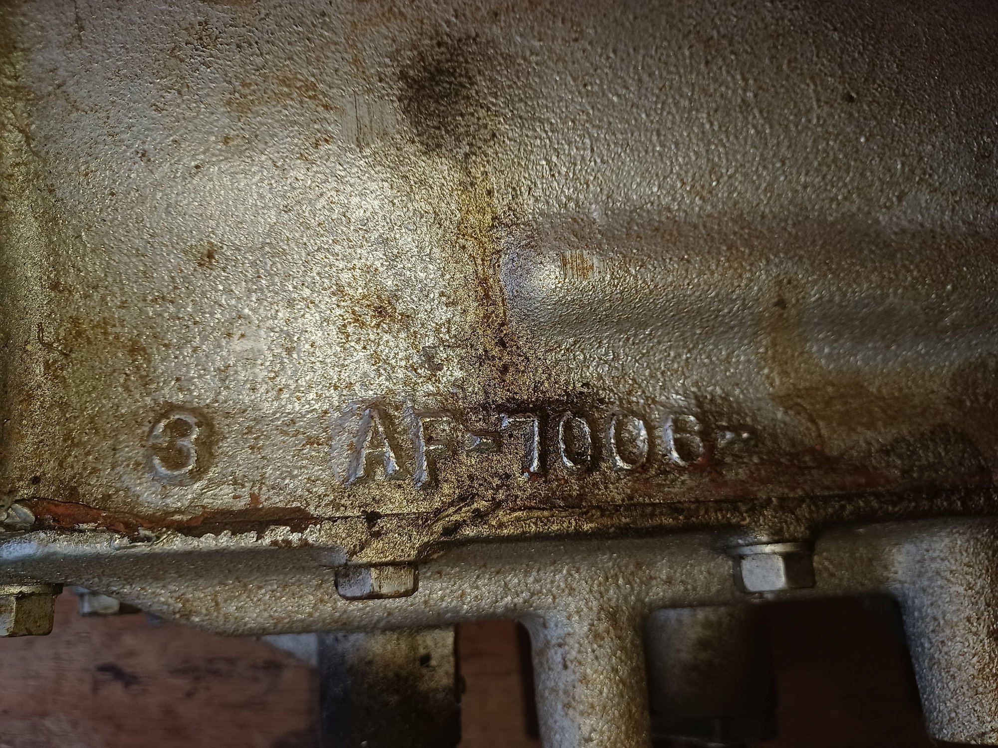

Maybe someone can shed some light on this OD transmission.
I'm not sure the exact year,.....
Any help?

Possibly an BW 259 with R10 overdrive. An early light duty combo.
Info and discussion here:
https://www.ford-trucks.com/forums/1...ification.html
and more to the point on the 259 here:
Y Block and Trans wish list

Thank you very much.
That is a lot more than I knew about it.

Looks like 49-56 Ford passenger car. I have a couple of these in my barn.

There was one on my parts truck, '60 F100.

Thank you guys, I have some new parts with it.
The guy I bought it from was planning to install it.
I have a brand new cable in the box, and a brand new handle,..... maybe an extra solenoid.
He was going to put it in a car..
