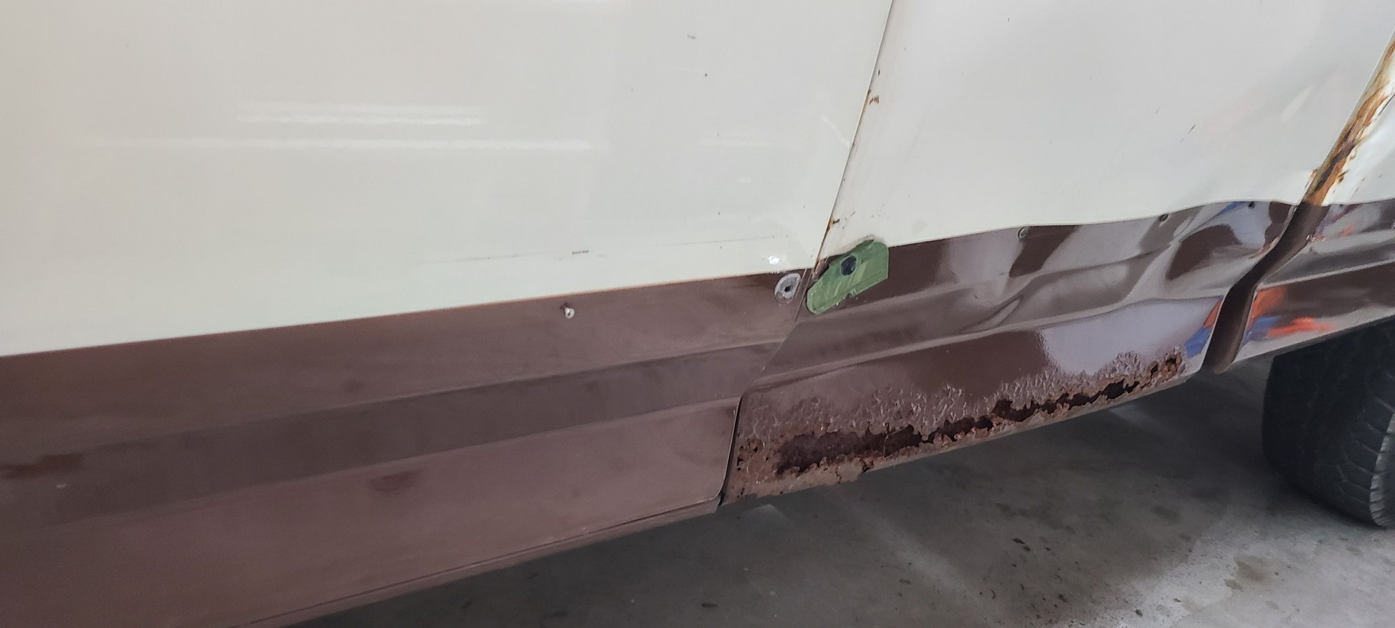

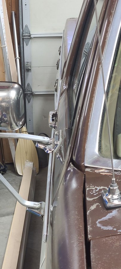

I have a somewhat sentimental 84 F150 Super Cab short bed This was my dad's rig new and I took my drivers test in it etc. In 99 I bought from him when he "upgraded" to a 2500 Cummins beast. Few years before he did that he ran a red light and hit another truck, smashing the he'll out of the front end. Long hours can kill you! Anyway, he put it back together himself, using aftermarket junk. I suggested a front clip from salvage yard but what do I know. Anyway, cab has never been the same, passangers side has a bow in it right at the pillar, and the aftermarket parts never fit as well. As time has gone on its starting to rust in the super cab areas, the floors, door sills etc. After market sunroof leaks along with the window in the super cab area. Add in some dents and the cab is rough. Like the truck great for hauling and I enjoy driving it, but it's getting a bit too ugly. I was thinking to switch the cab to standard, as I am not a big fan of the super cabs. Shorten the frame and have a nice short box truck.
Crazy difficult or reasonable? Stop being sentimental and just buy a similar rig in better shape?
If I don't fix it it may have to go. It usually is not in the garage, so it sits outside unprotected. 👎

Cabs dont bend unless the frame is bent also. A good frame shop could pull it back into shape and that may get the cab back as it should too.
Then all the after marked parts may even fit better unless they need to be replaced also.

it's not the alignment of the fenders, which is ugly, it's the cab having bow in the passanger side, the sunroof cut in the roof, which leaks, the cab side windows leak, lots of rust as a result. Probably best to just let it go...
