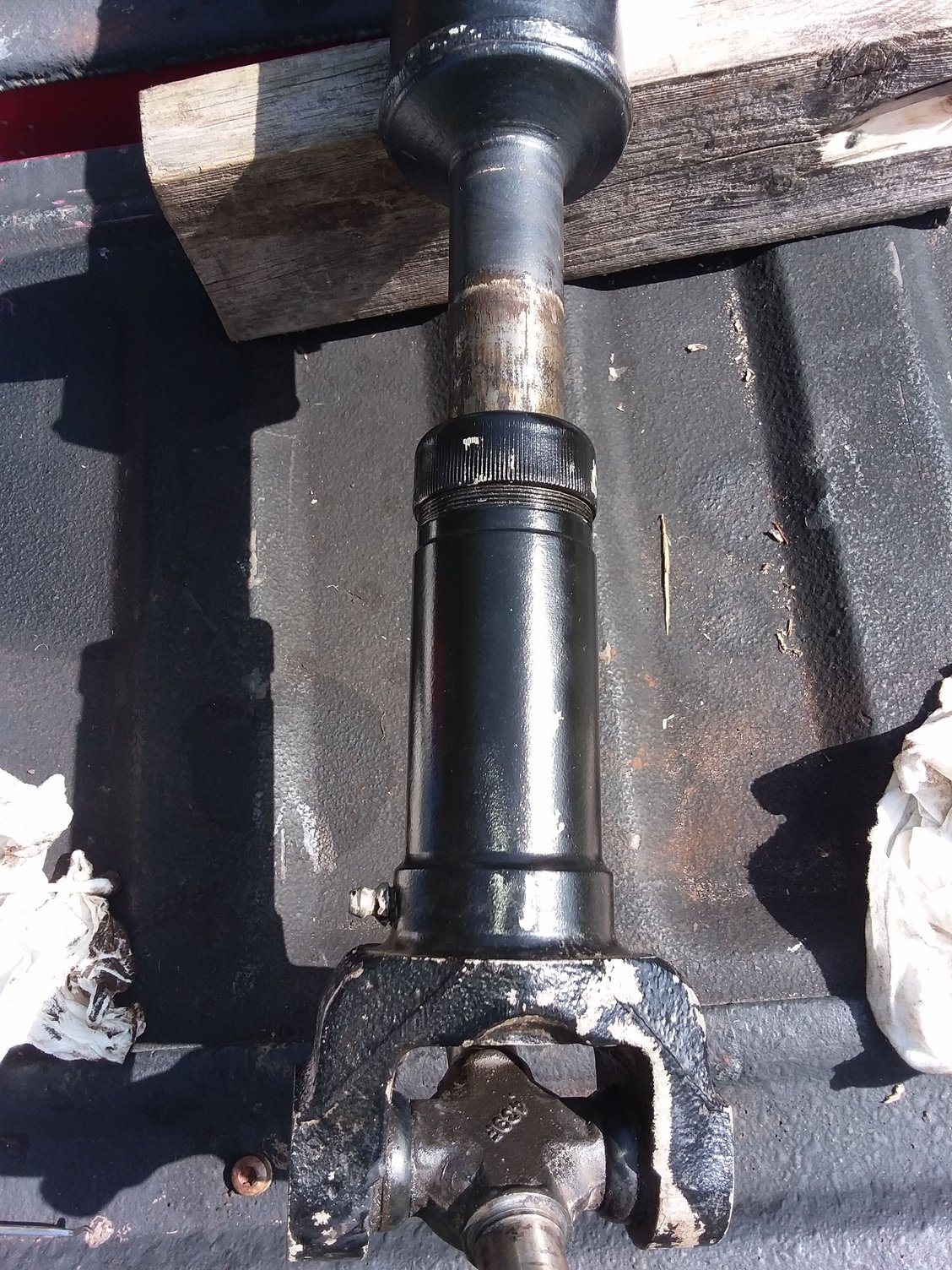

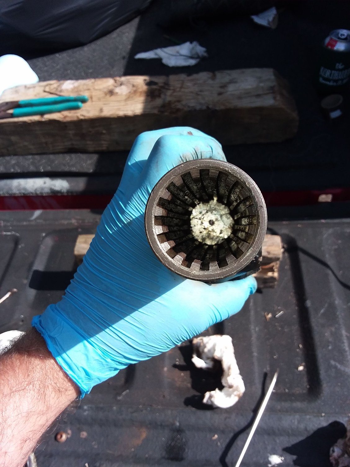

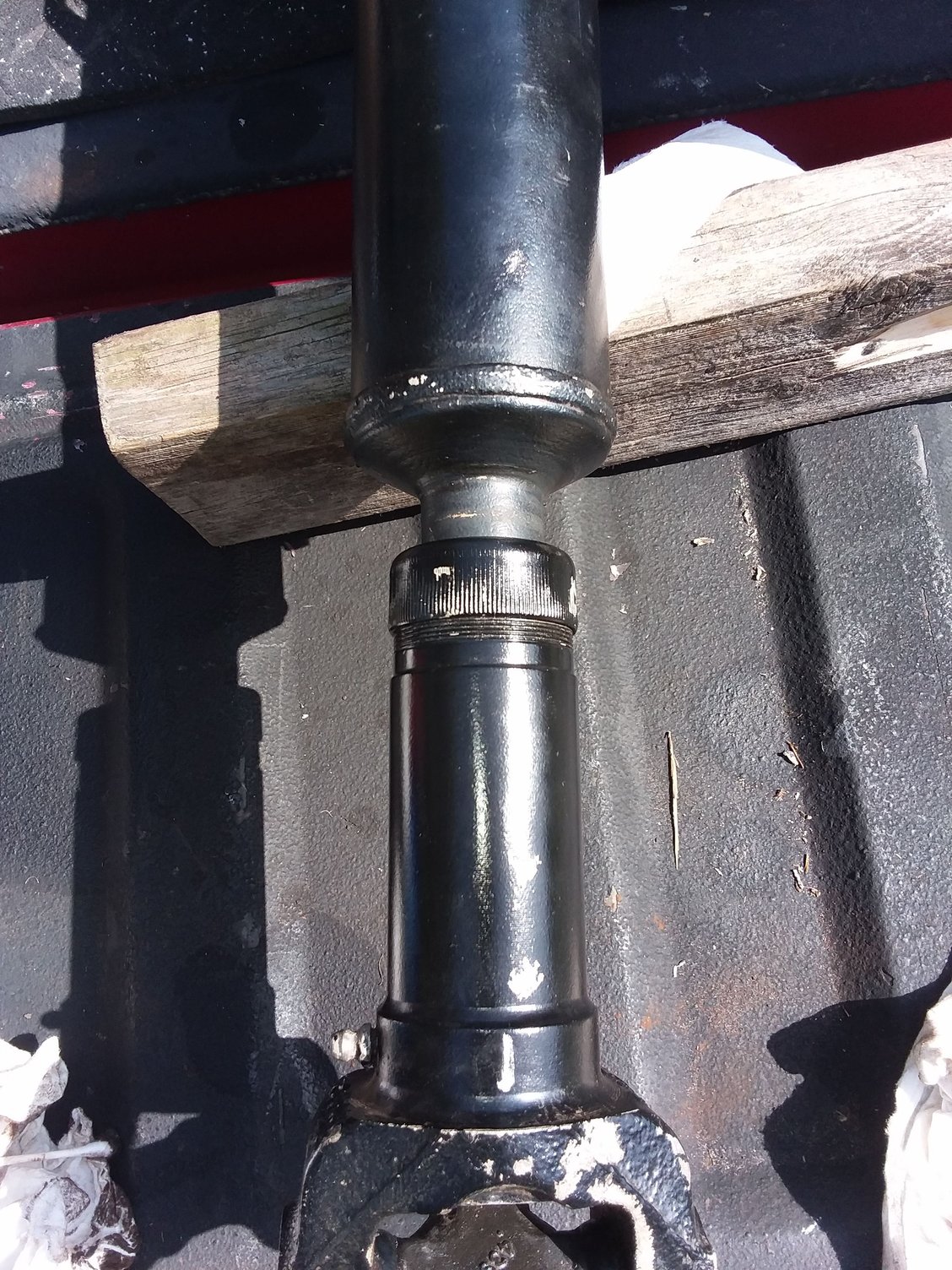

Here are some shots of it cleaned up. I used paint thinner. I've been using it lately as it is cheaper than brake clean and doesn't mess with the paint. It also gives a little more time to work with before it dries.
I used a toothbrush to clean the softened old grease.
I also hit the neck where the seal rides with some emory cloth.
I then used a toothbrush to get fresh grease into all the grooves on both pieces.
Here are shots with full extension and compression.
Notice no splines are showing. The seal collar limits that much extension.
Full extension
Full compression
Now I'll put new u-joints in it and bolt it in.
Note: pictures didn't sequence correctly.

Nice. Glad you got it apart.
I see that you have the older style, which means it's likely the original shaft. The aftermarket replacements, and perhaps the originals too I would think, went to a design where the grease fitting was up more by the seal and splines, rather than down low by the cavity and cap. I think the newer ones were better for getting grease up into the splines more quickly, but not sure if it was effective for all splines, or just the ones near the fitting.
I always had to disassemble my shafts to get new grease up into the splines more reliably.
Paul
