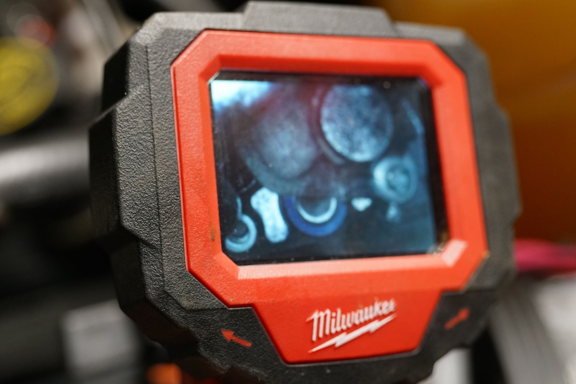

I have a borescope I have done through spark plug and through injector oil there was no damage. slight oil coating or liquid visible but not accumulated in any cylinders and i excepted fluid resting on top of intake vale and they where bone dry. any clues? thanks for advice. I am trying to get a picture of behind cylinder 5. i did go from stock fuel injectors (half was bad ) to some remaned ones on ebay. they said they where for my truck i went from a 32millisecound pulse to 5 ish to 7 ish. will that cause any of this? When it starts it seems like it is not getting fuel? Thank everyone for helping!!

Also just behind cop 5 there is this. Is it suppose to be like that?

more

That hole that isn't covered is perfectly normal on these engines, I think it allows for either head to go on either side of the block, very strange but OK.
