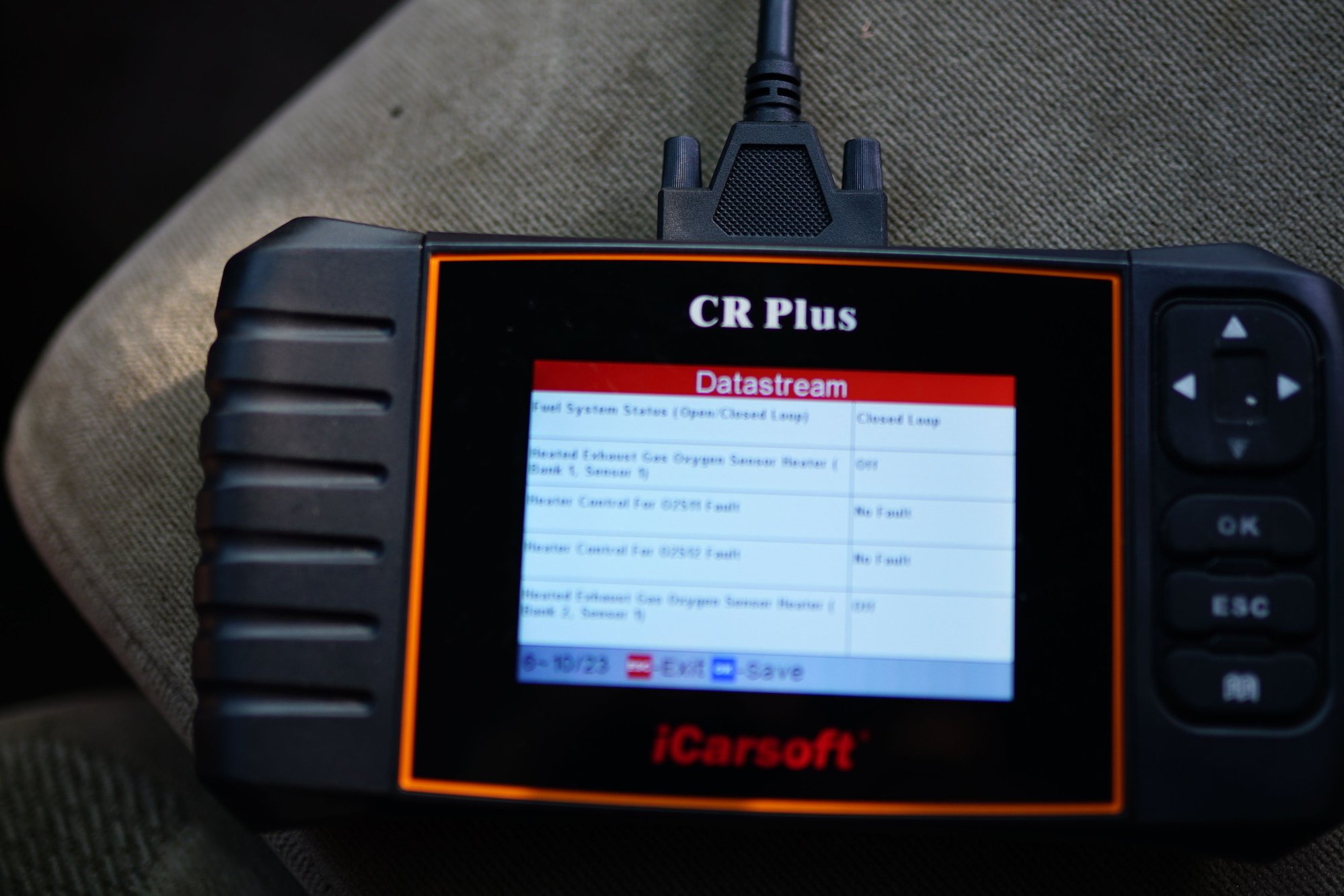

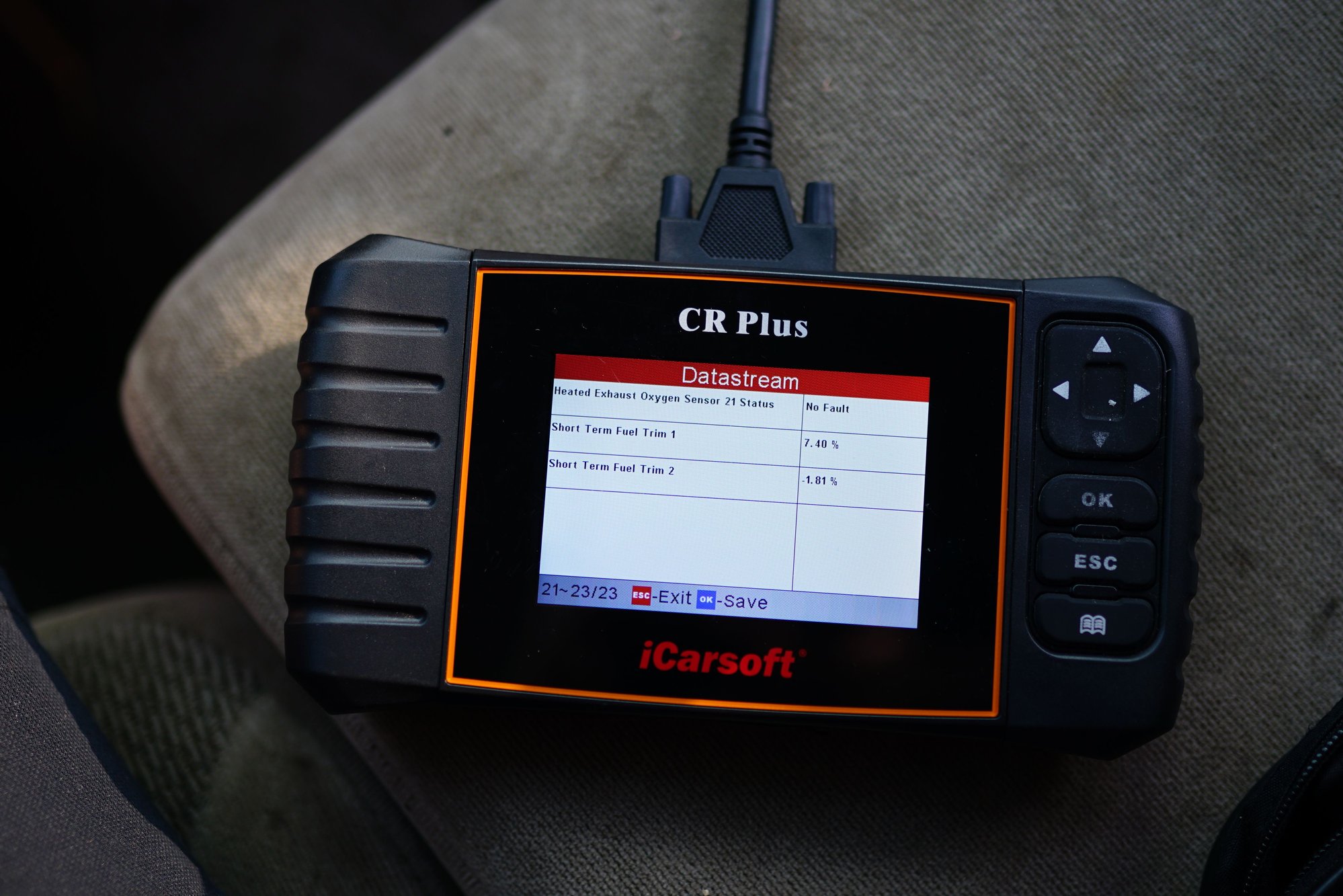

Dweber85rc Thanks for input getting ready to show some data collected.
Old Jul 13, 2021 | 08:20 PM
brian8's Avatar
brian8
Joined: May 2021
Posts: 15
Sorry about the one blurred
