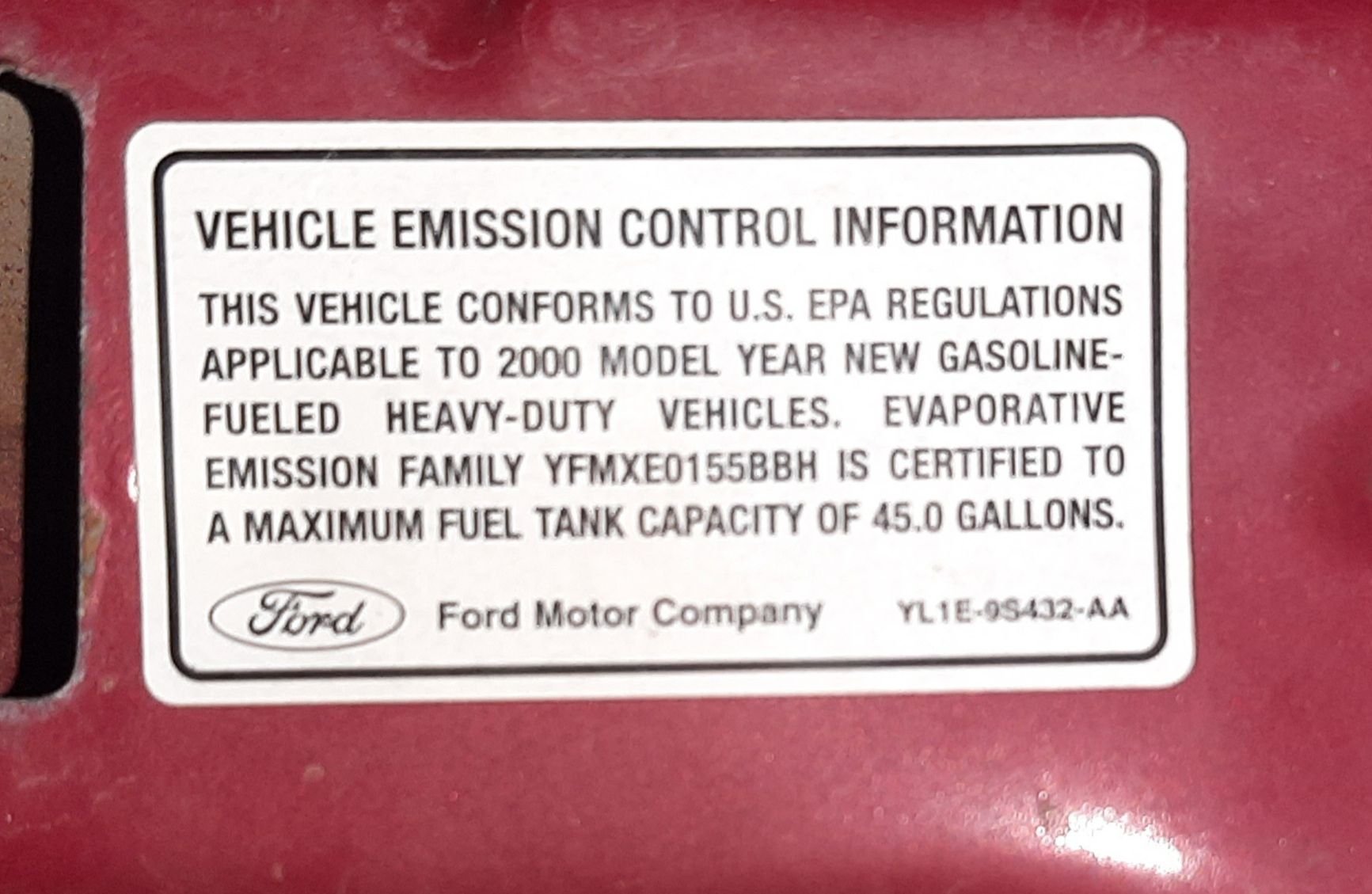

I have a 2000 X w the V10. It was not made in California but in Wisconsin or Minnesota area. It was registered out here back in 17 and then off the road. I got it and put alot of work into her but she won't pass smog, keeps saying 'not ready. I've put a few hundred miles since then and will try again tomorrow. Does anyone know if non CA vehicles have to meet CA specs? I mean come on, it's old enough to legally drink...

Only has to meet the requirements of the sticker under the hood. However a OBD readiness check is required. This code is also commonly set when battery voltage is too low during cranking and resets the PCM memory. There is a host of reasons why it won't clear but battery voltage is one of the easiest to fix.

Can you fnd the sticker mentioned in post 2?
Pretty sure it would have had a cat. They (there are two, one on each bank) are way upstream, just out of the exhaust headers. EDIT, see posts 10,12 & 14. Only one.

[QUOTE=85e150;19965184]Can you fnd the sticker mentioned in post 2?
Pretty sure it would have had a cat. They (there are two, one on each bank) are way upstream, just out of the exhaust headers. EDIT, see above post
Previous discussions:
https://www.ford-trucks.com/forums/1...em-on-v10.html
OK this one could be the issue. A model year 2000 might be OBD 1 but they are testing like it's OBD 2. This is a bit of a slog and the usual OT stuff, but there are links and it seems liike this would be something to look at.
https://www.ford-trucks.com/forums/1...venture-2.html[/QUOTE
Here's some pics...
Hood sticker 1
Hood sticker 2
Exhaust, rusted part is pipe from the flange that bolts to rams horn.
This is the flanged end of the pipe from the previous pic, you can see some of the rams horn on the left.

You have a vehicle with an OBD1 calibration. Most likely the smog tech is testing it wrong and that needs to be corrected first.
It is completely normal for OBD1 vehicles to have "incomplete" monitors for sensors that don't exist.

This is most likely the situation, seem like a fairly common mistake for Techs to make.
Without the cat in place (there should only be one cat, not the two mentioned earlier) I doubt that it will pass a tailpipe sniffer test and will obviously fail a visual inspection of the exhaust.

If you were paying attention, you would know that there are not going to be any loose wires since those sensors were never installed at the factory in the first place.
The "Federal" 2000 6.8L Excursion has only a single converter in the exhaust system, just forward of the muffler (stock configuration). If it's been "deleted", the truck will fail the visual inspection as noted.

Just to confirm, there should be a single cat between the rams horn and the muffler?

Yes, single cat. The twin cats on the downpipes were a thing on the later 3 valve V-10s.
Your cat should be right there where that newish section of pipe is that your pictures showed.
