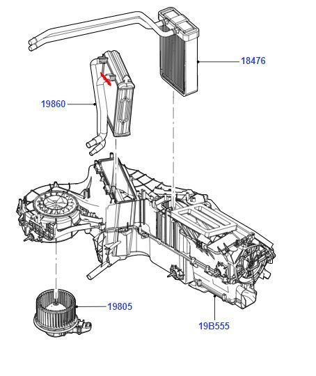

Looking at parts diagrams, maybe I should cut the line at the evaporator core itself and leave myself a bit of a handle to work it from inside the cab (second person required) and still be able to get the HVAC box out, that would reduce the possibility of getting metal fragments into the parts of the system that I'm not replacing. Doesn't seem like it can leave me in a worse off position since I'm replacing the lines I'd be considering cutting anyways. Cut would be at the red line.

Got it undone, seems like there was a bit of tension on the side of the fitting. Once I had sawn about 99% of the way through it the fitting itself came undone. Top tip for first timers, cutting the line at the top didn't help at all since it routes through a bunch of plastic at the firewall. I had to put the hvac box back all the way where it goes to get enough clearance on the engine bay side to cut the line without damaging the other component's fitting. Evap was replaced and the entire box reinstalled and buttoned up in another 20-30 minutes.
