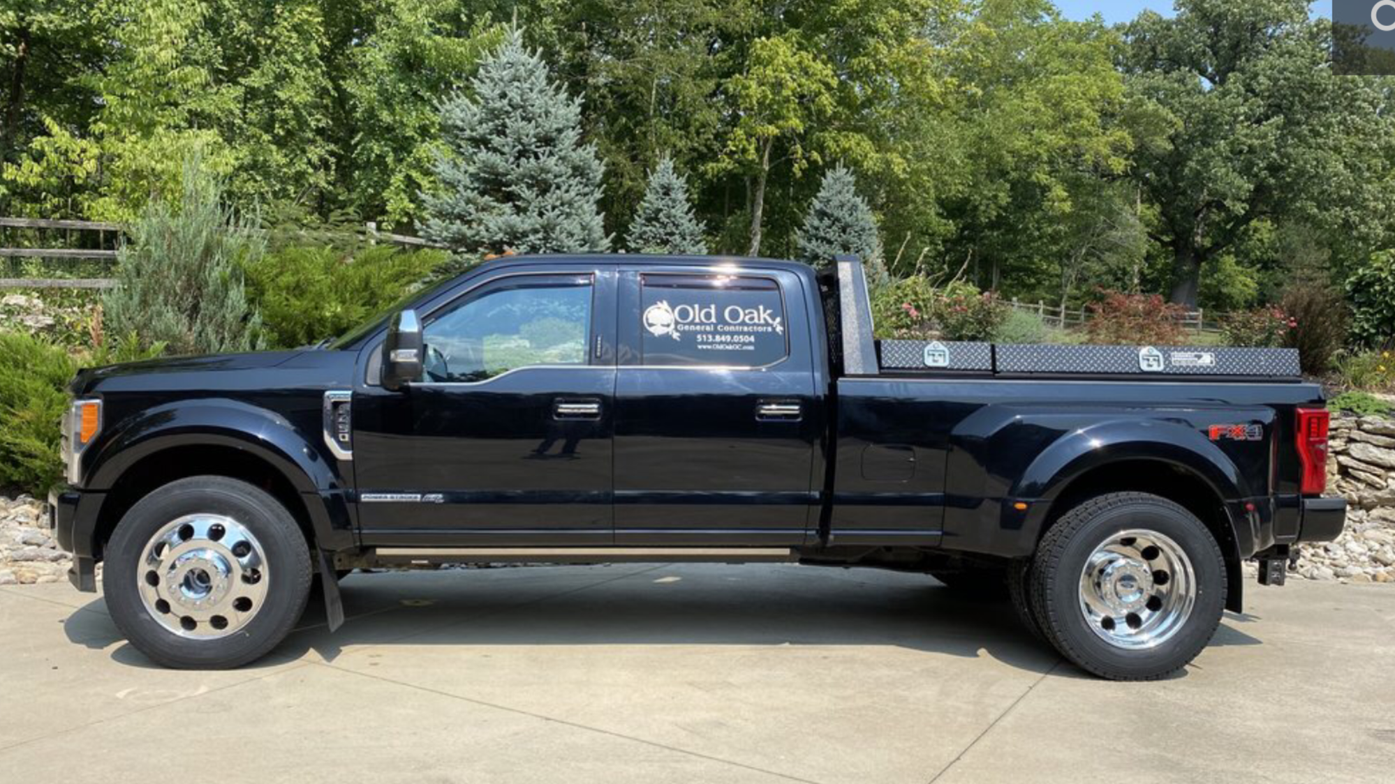

Here is a pic of a stock f-450 with the wheels I just ordered
These are 37’s
Looks tight so I was thinking of doing a small lift for two reasons
1) the wheel clearance
2) I want to buy fox 2.0 or 2.5 shocks and they do not come in 0 lift. You need a 2” in the front and a 3” in the rear at the min.

Originally Posted by acadianbob
The ride height is the same with or without the camper package. However, the camper package has a rear anti-roll bar that might not work as expected if the truck is lifted.
good point
so some tool box anti sway bar spacers might be needed.

What is the wheel tire combo on that? 22.5" wheels?

Tires are Toyo 255/70R22.5
rins are AWM 22.5X6.5 with 10X225MM lug holes. Polished on both sides. I use pvc gaskets so I will be able to rotate the fronts to back outer and back outer to fronts.
bought an extra steel spare so I would have a spare and can rotate the spare out to the rear inners.
plant to mount the spare underneath deflated . I have an onboard 100psi 2gallon compressor.
these are direct bolt on.
Not my number 1 choice, but good enough .
no one could get me my number 1 choice , so I decided to move on.

Well the if it's any consolation that setup looks amazing whether it was your first choice or not! What else were you looking at?
Also I wasn't trying to put you off a lift with my previous comment. I was just speculating that it might in fact work with no lift. As to the lift you thinking front level and airbags in back, or lifting front and rear both?

Lift I was thinking wAs a simple 2.5 in the front and 3 in the back.
front
2.5 spring spacers
sway bar brackets
track bar relocation
pinion arm relocation
rear
2.5 to 3 PMF style blocks with 2.5 angle
this would ive me the minimum for the shocks I am looking at.
i already have 1000lb summosprings in the front and 2500 summo springs in the rear
the 1st wheels were some fuel 22.5x7.5. And on those I probally would have done 255’s or 275’s. Couldn’t get the ones I wanted.
