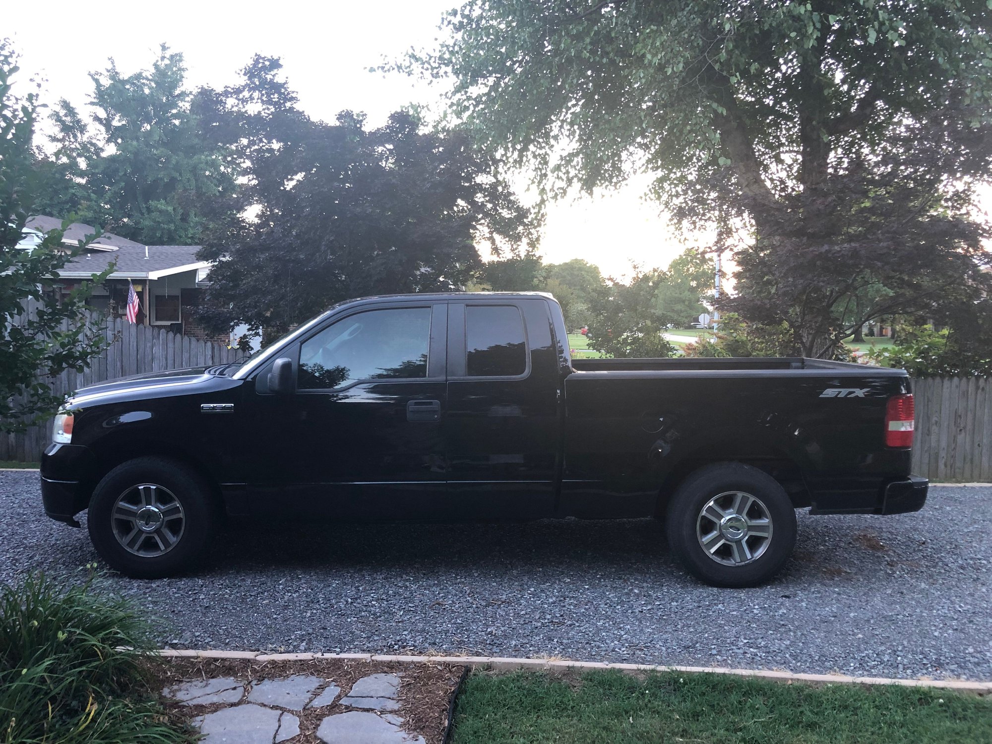

Thanks meborder! Watching the gauge pretty close while towing...the temperature didn't stay around 250 for very long...not 30 minutes...more like...10 to 15...then drop back to around 220 or so. It only hit the red area when I was driving up a decent sized hill...for the most part...it hovered in the yellow...around or just above 220.
As for how / where the gauge is attached to the transmission...I'm not sure...how would I check this? The dealer did the work so...I'm kind of trusting them (I know...that might not be the best idea...lol).
As for "re-gearing"...I'll have to consider that based on how things go when I get the tranny cooler installed (and cost). I have to have the AC looked at as well...it doesn't blow cold air when I'm towing my rig and...the other day...coming back from St. Louis...while it did blow cold...I could have swore I heard water noises. I've never been impressed with the AC on this pickup from the beginning. It's the first Ford pickup I've owned that didn't freeze you out. All the Ford tucks I've owned (and I've owned several...mainly 96's) had AC that would freeze you out in the worst 100 degree heat and humidity in Southeast Missouri. I had them look at it once but it was at the tail end of having other work done...plugs and coils replaced and...I think they were wanting to get it done and out of the shop. When I have the tranny cooler installed...I'm going to tell them I want the AC thoroughly checked as well. I have 3 dealers relatively close to me so...I kind of bounce between the 3...for some reason...it seems if you throw too much at any one...they get overwhelmed...lol. I don't know why...I'm paying top dollar...for dealer work. I've always thought it was because my truck is 12, 13 years old and they're used to doing easy stuff on new pickups. I've always wondered if they were asking themselves...why I wasn't taking it to Jim Bob's shop on the corner. I do to the dealer because I want it fixed right the first time and...I want them to stand behind their work. I've had too many bad run-ins with "side shops"...not that their aren't good ones out there...I've just never found one. I'd just rather pay more up front and get it done right the first time.
As for the tires...they're the standard that came on the truck...no upgrades. Below is a pic...but might not be close enough for you to tell. Just let me know and I'll take a closer pic.
