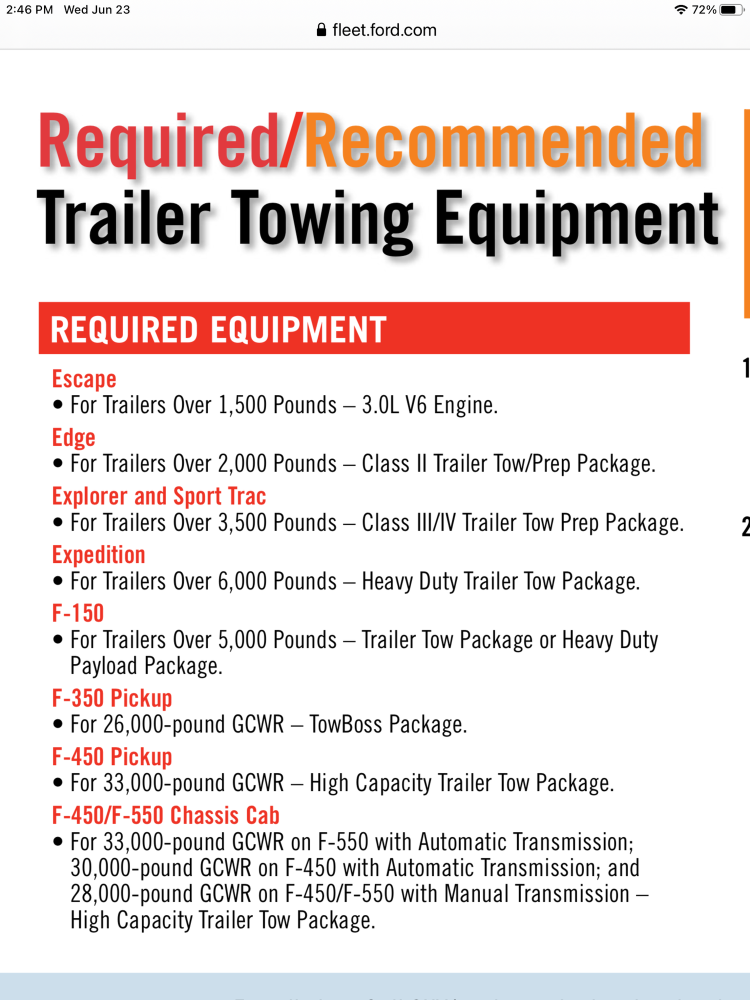

Your truck’s max trailer weight spec is 6500 lbs. (not CarMax’s 8000; see the guide for your truck configuration). Your already at 6395.
However, the 6500 lbs. spec is based on the requirement that your truck be equipped with the optional trailer tow package (see Snip below from Guide pg 15).
One interpretation of the Guide is that since your truck is not equipped with the optional TTP, then it’s limited to a 5000 lbs. trailer.
