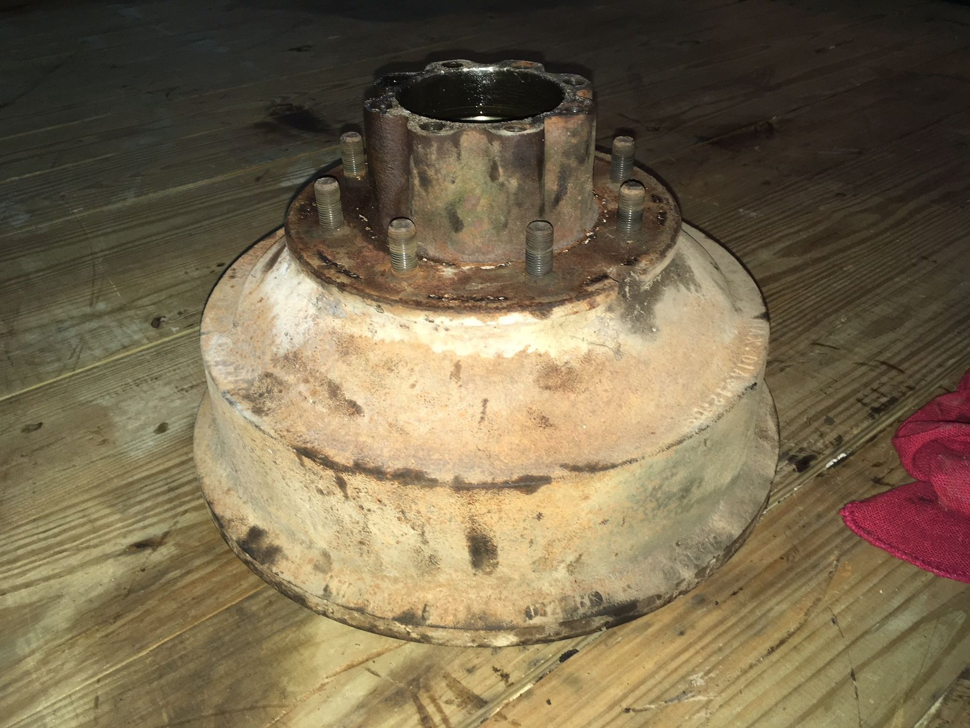

@bigwin56f100 found a pair of rear drums fir my ‘55 F250 I should be able to use but one has a bent flange. Can a machine shop sort that out and is the drum still useable? See pic.
Thanks !

Looks like scrap from here. I'd prefer a round drum with a groove or two for now. That's been done a few million times.

I looked at that drum again now that the sun is going down and i think that was just a shadow.
I’m going to take these to my friends shop and cut them and see how they turn out

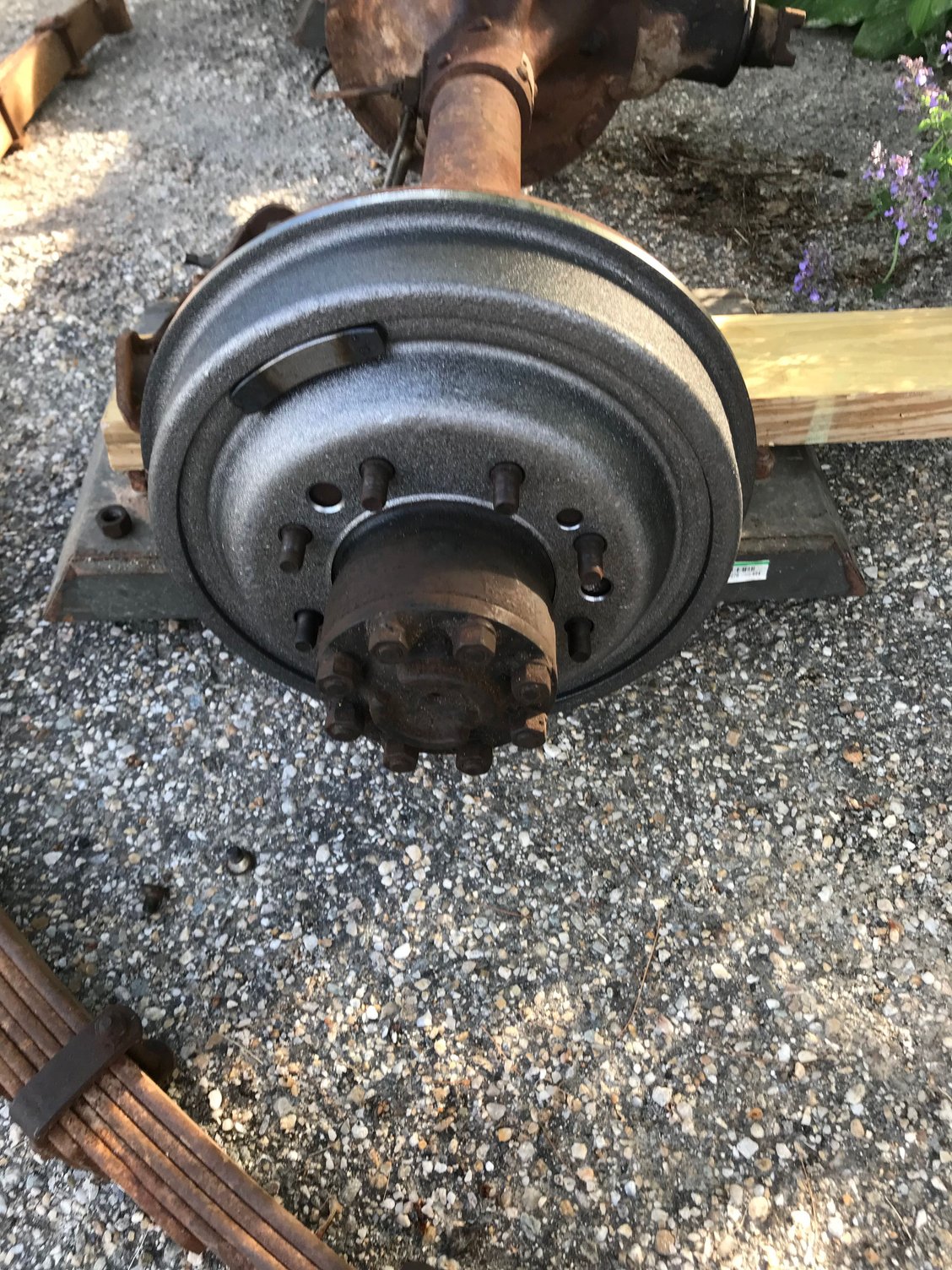

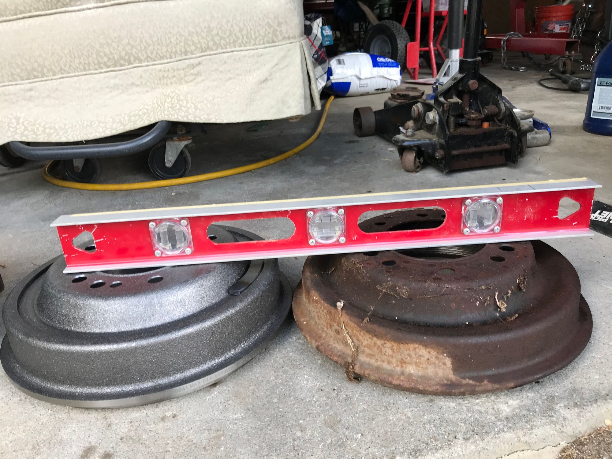

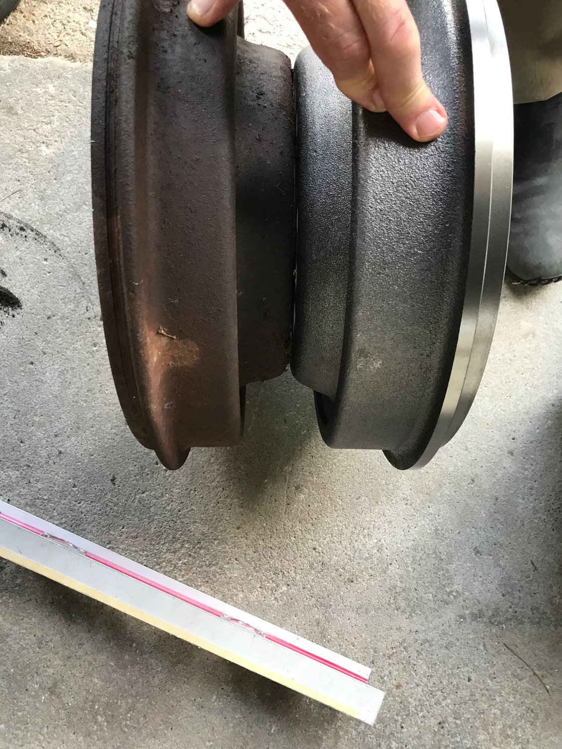

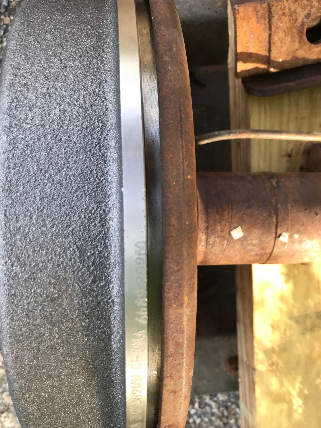

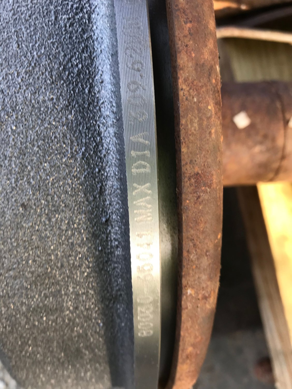

I am going to make a separate post so it is easy for people to find in the future. After reading all the referenced posts and additional research I came to the conclusion that a 57 rear drum light fit. I called CTEK (manufacturer) but they could not confirm fit on a ‘55, only the ‘57. Rock auto has them for $35 plus $10 shipping so I decided to roll the dice and buy one.
It fits perfectly from what I can tell. It is the same size in all dimensions. It might be a hair wider on the inside diameter but I don’t have calipers to check. I think I just need to use ‘57 shoes to be sure they are the right thickness.
Pics…
