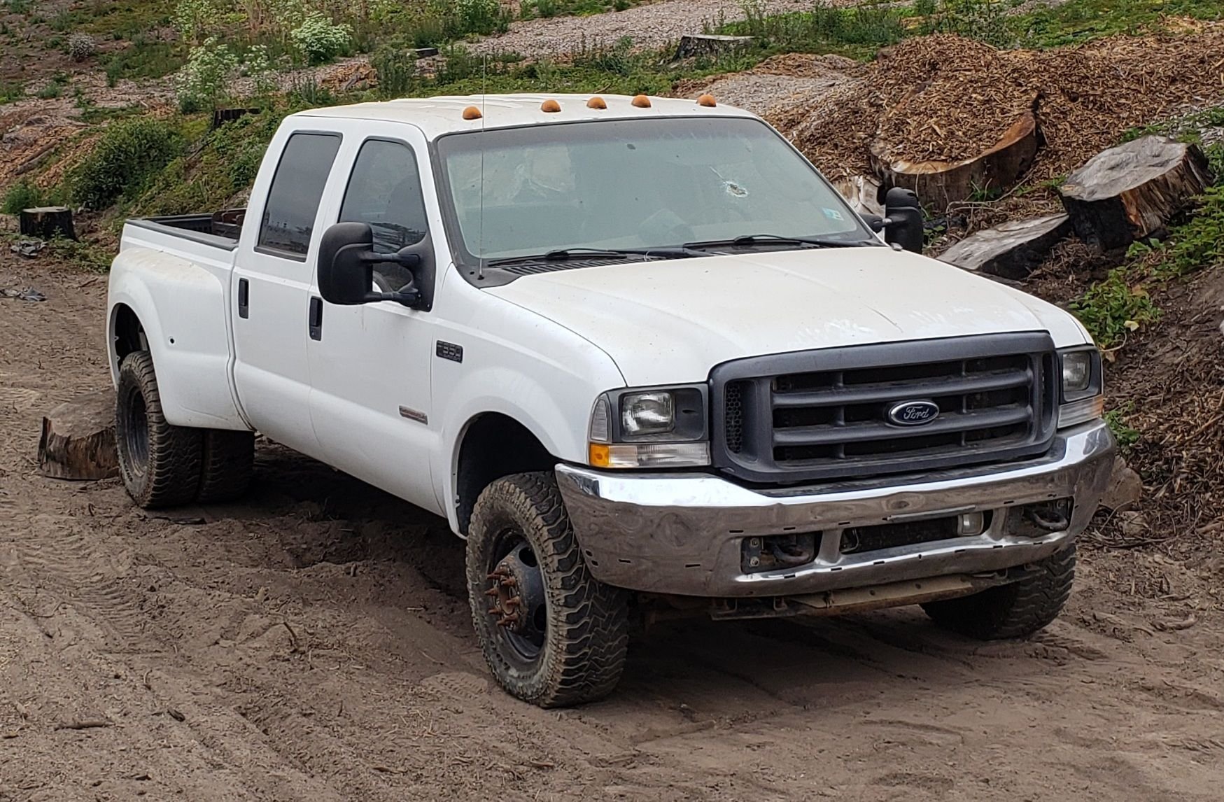

The one picture doesn't look too bad - I see some dents in the front bumper and the windshield hit, how is the rest of the outside and the interior? Maybe post up some pics of the engine bay and see what we can tell you from that. I think a dually 4x4 manual trans would be very cool - what's it worth running? These days I don't think you can ask enough - there are some die-hard manual fans that would be licking their chops to get ahold of this bad boy. CA rust free is also a huge bonus...

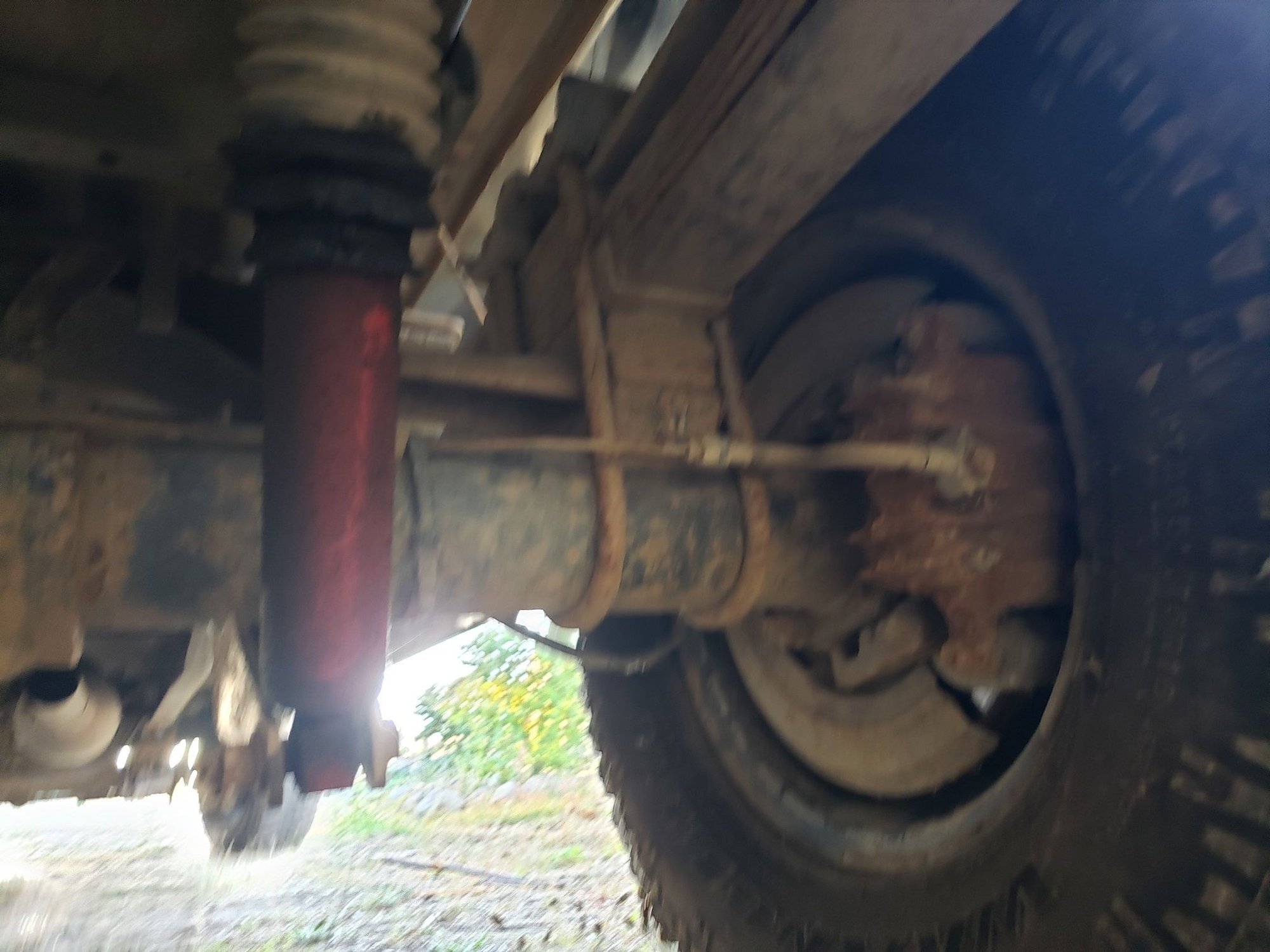

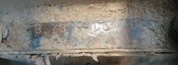

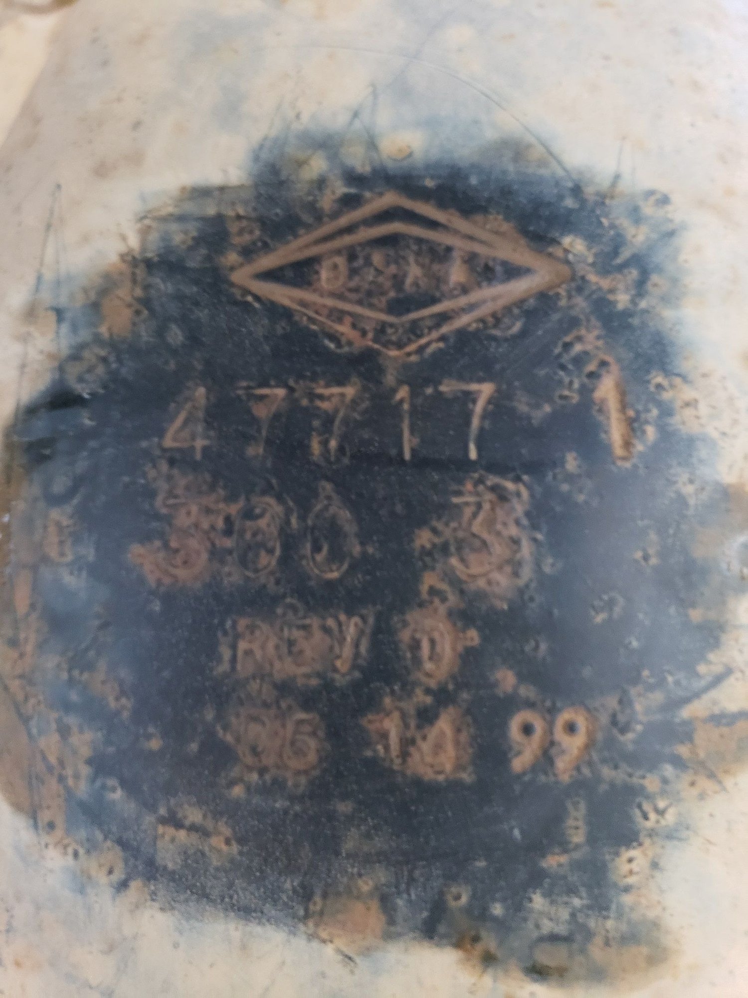

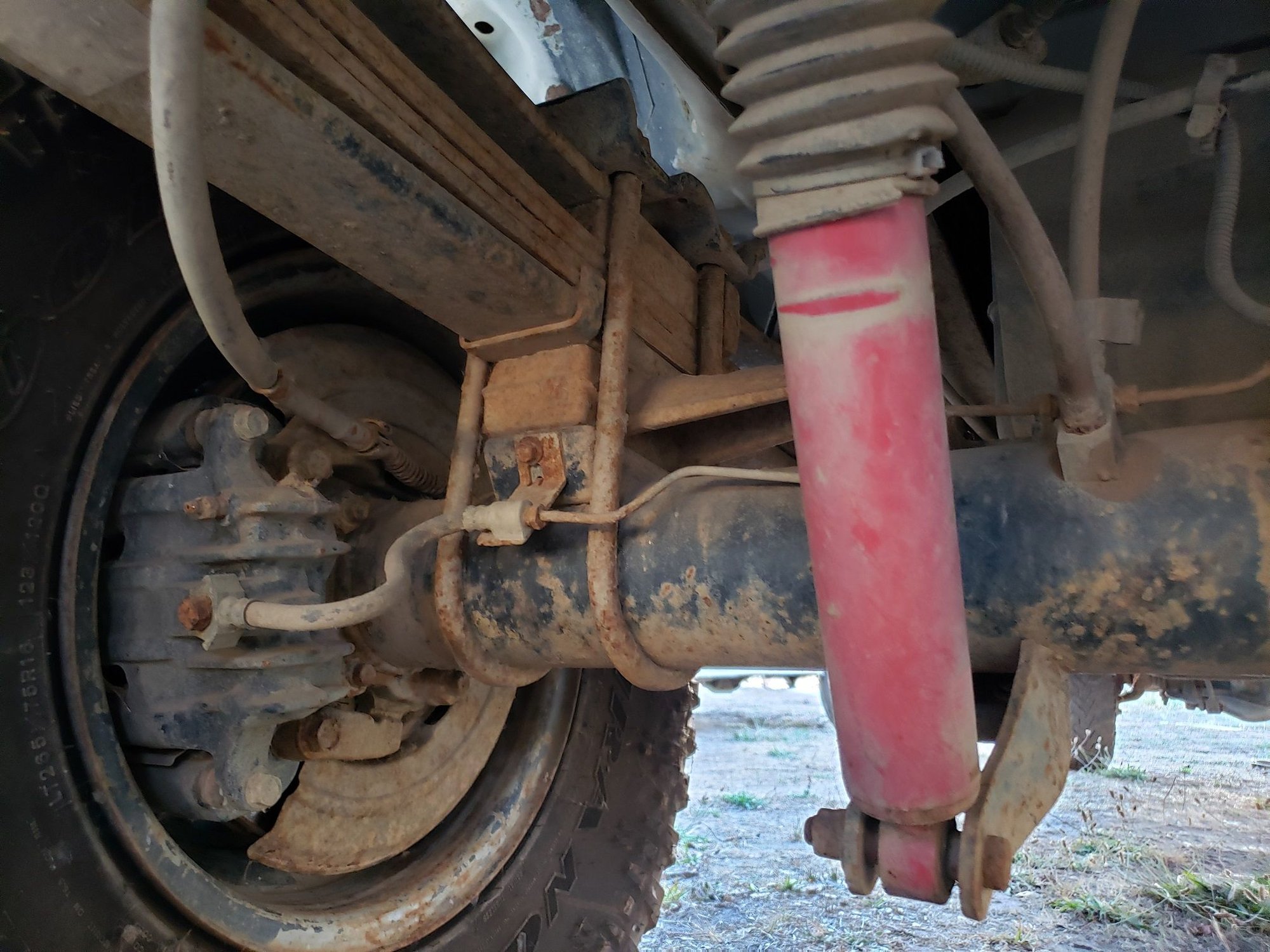

Here are photos of the front and rear axles. I can make out the Dana logo, but the other digits are a bit hard to make out.
