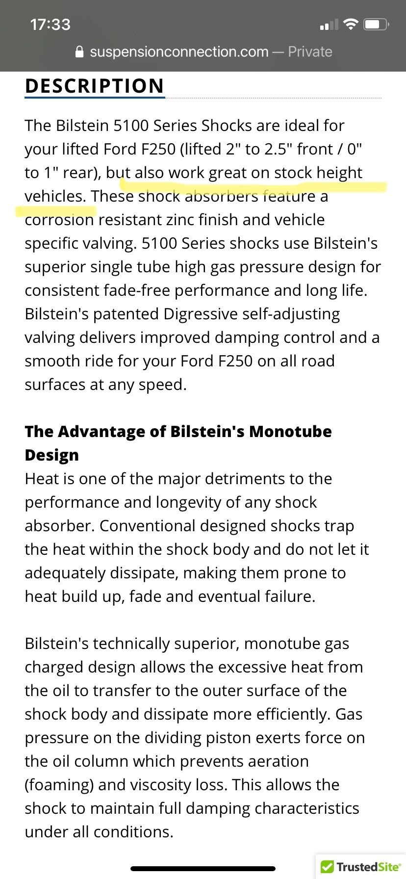

5100’s on stock truck
I have 5100’s on a 2017 SCLB 4x4 with no snow plow, no lift, no level or camper package. Night and day difference between factory. I also did the steering stabilizer in 5100. Unbelievable how much better than factory. I’m on and off road quite a bit and zero problems. The above statement by this company and many forum members confirming that 5100’s work fine on factory trucks.
